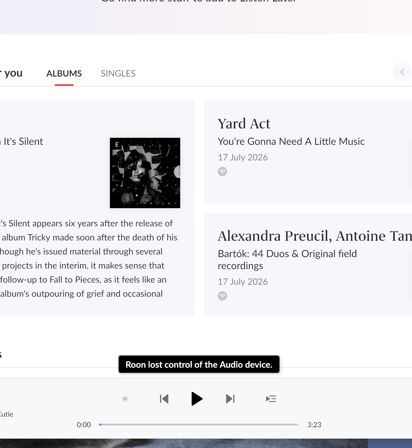

· Roon Nuc 1, Mac mini 2025 tahoe, Draytek 2866 router wired direct to Nuc. Roon suddenly lost control endpoint Sonos Play 1 which has previously worked

Thanks for checking - I rebooted the Nuc 1 and now it’s back to normal
