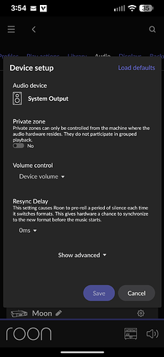

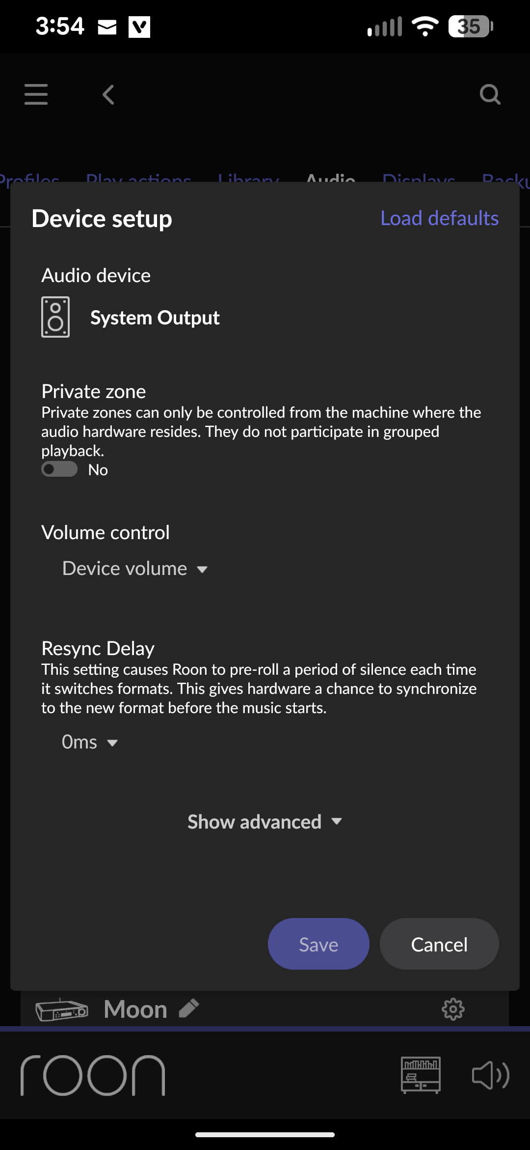

Did you go into settings:audio: device setup to change it from fixed volume to device volume?

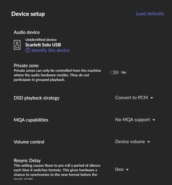

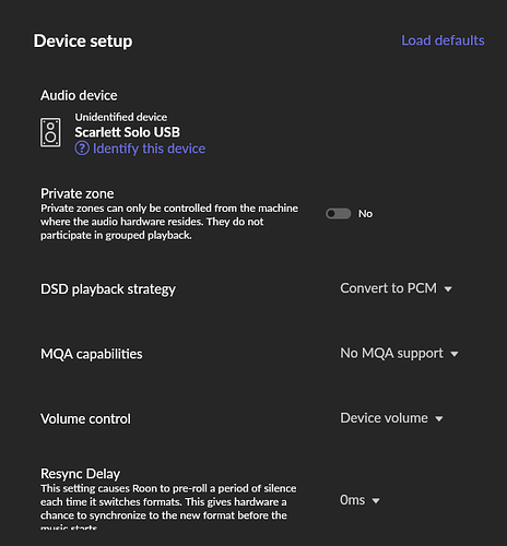

Yes, but I don’t see anything about fixed volume, even in advanced settings (also, weirdly, as soon as I open the device setup dialog, my mouse stops working until I unplug it and plug it back in).
Yes, but the Volume control setting is on “Device volume”, not “Fixed volume”. I tried toggling it to fixed and back, but no change in the volume pop-up. (Also, weirdly, as soon as I open the device setup dialog, my mouse stops working until I unplug it and plug it back in.)

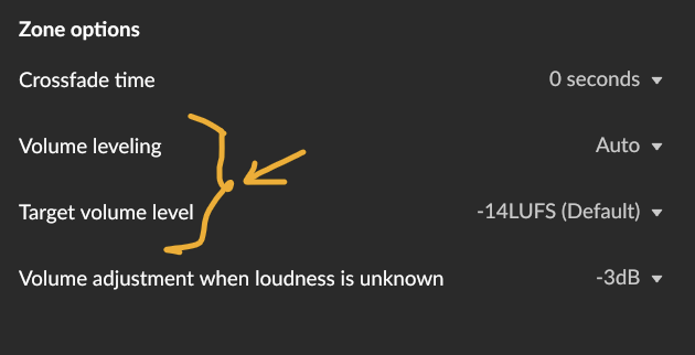

Have you try these settings to see if you can match the volume by ears?

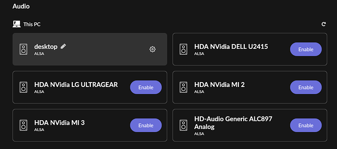

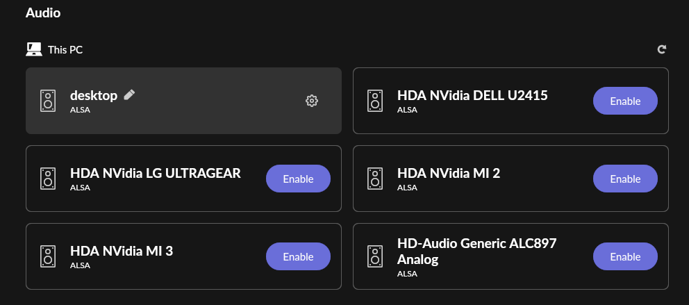

It’d be really helpful if you shared a screenshot of Settings —> Audio, and confirm the default audio device in Linux GUI.

Here you go:
and the top of the device setup for the audio output, for good measure:

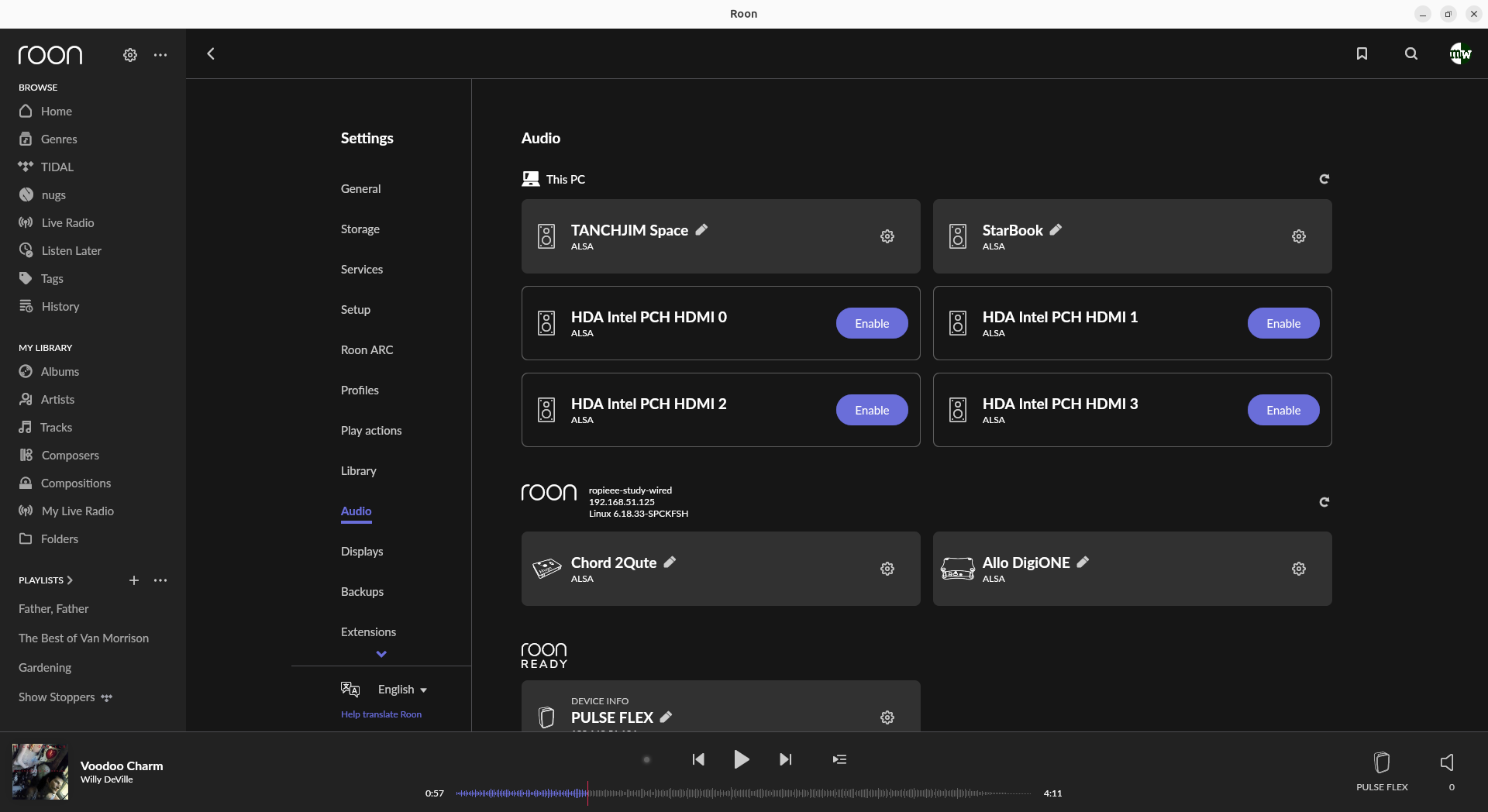

Something is off here. The Scarlett Solo is a USB device and should be listed under Settings → Audio. For example,…
… where StarBook is, in my example, HDA Intel PCH ALC269VB Analog, and the TANCHJIM Space identified as TANCHJIM-SPACE (a USB DAC.) Is desktop the USB interface and Scarlett Solo? It looks like HD-Audio Generic ALC897 Analog is the default PC audio device.
However, when plugging in a USB DAC, Ubuntu will make this the default audio output, which is likely why you are getting issues where Roon can’t acquire the audio device because the system has control. Therefore, under Ubuntu Settings → Sound, change the Output Device to Speakers - Built-in Audio.
Desktop is the zone.
