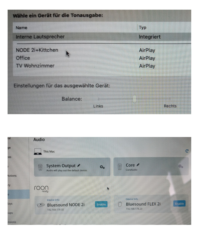

I didn’t think about the output on the MacBook.
But unfortunately nothing appears there either.
Maybe there is still something to activate in the A14?
And yes. No connection.Sound only on the MBook

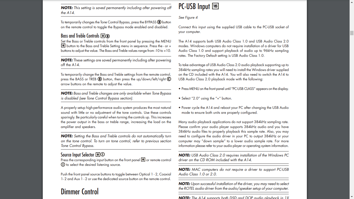

Another option: different USB Audio Class - 2.0 or 1.0 (A14 manual screenshot above)?
