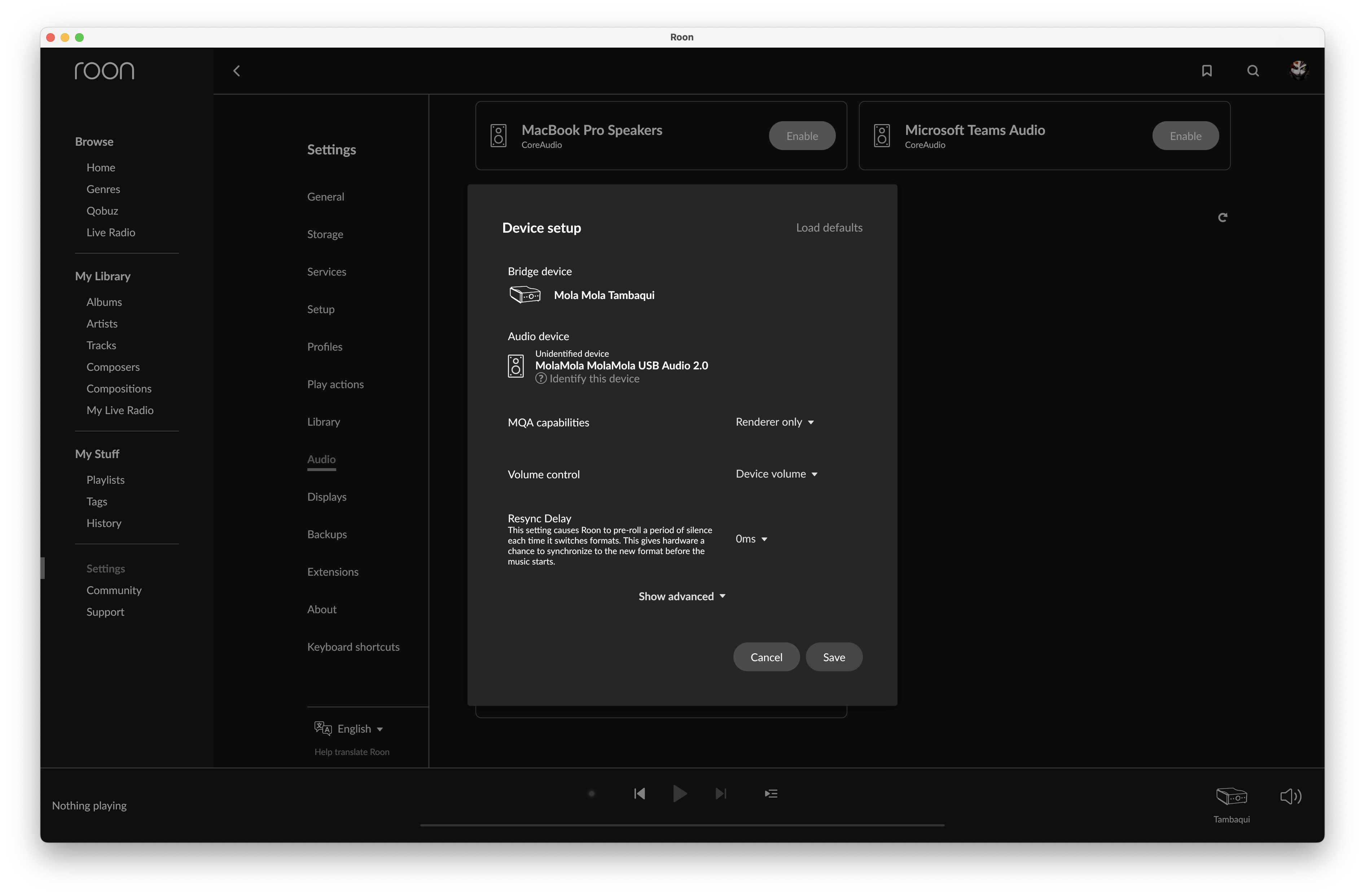

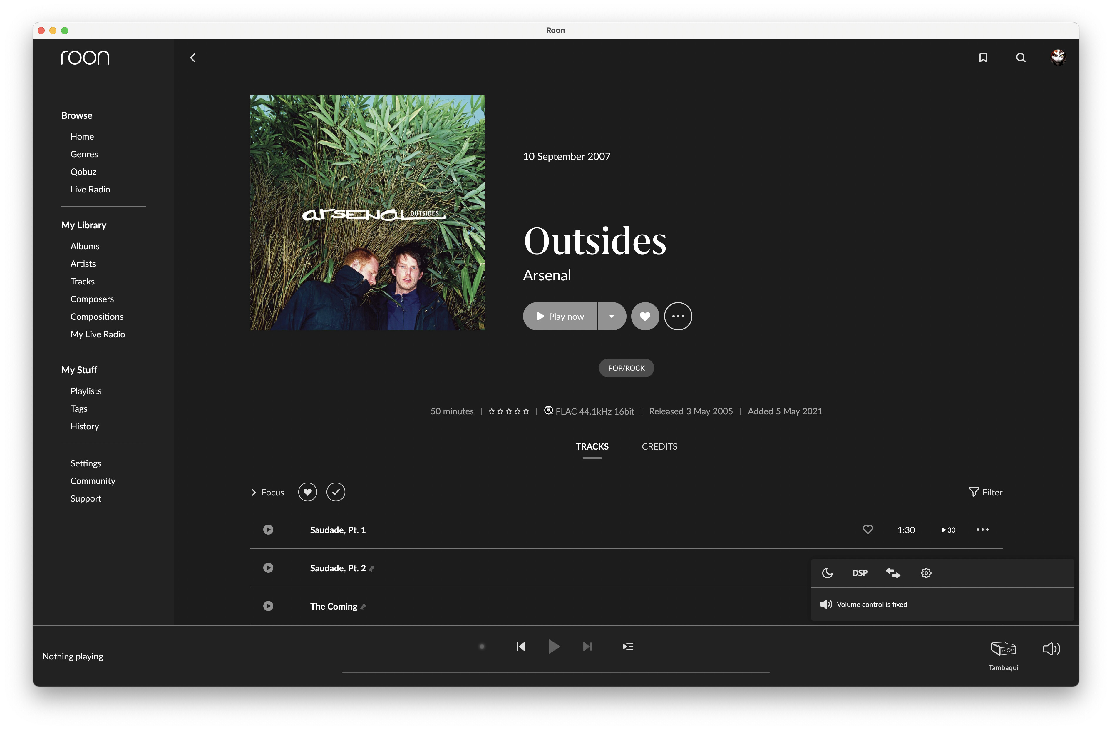

Cannot change volume of the Tambaqui. Volume controls show the volume is fixed, but the actual audio device configuration shows it’s using device volume. I’ve never seen this issue prior to B831. See attached screenshots.

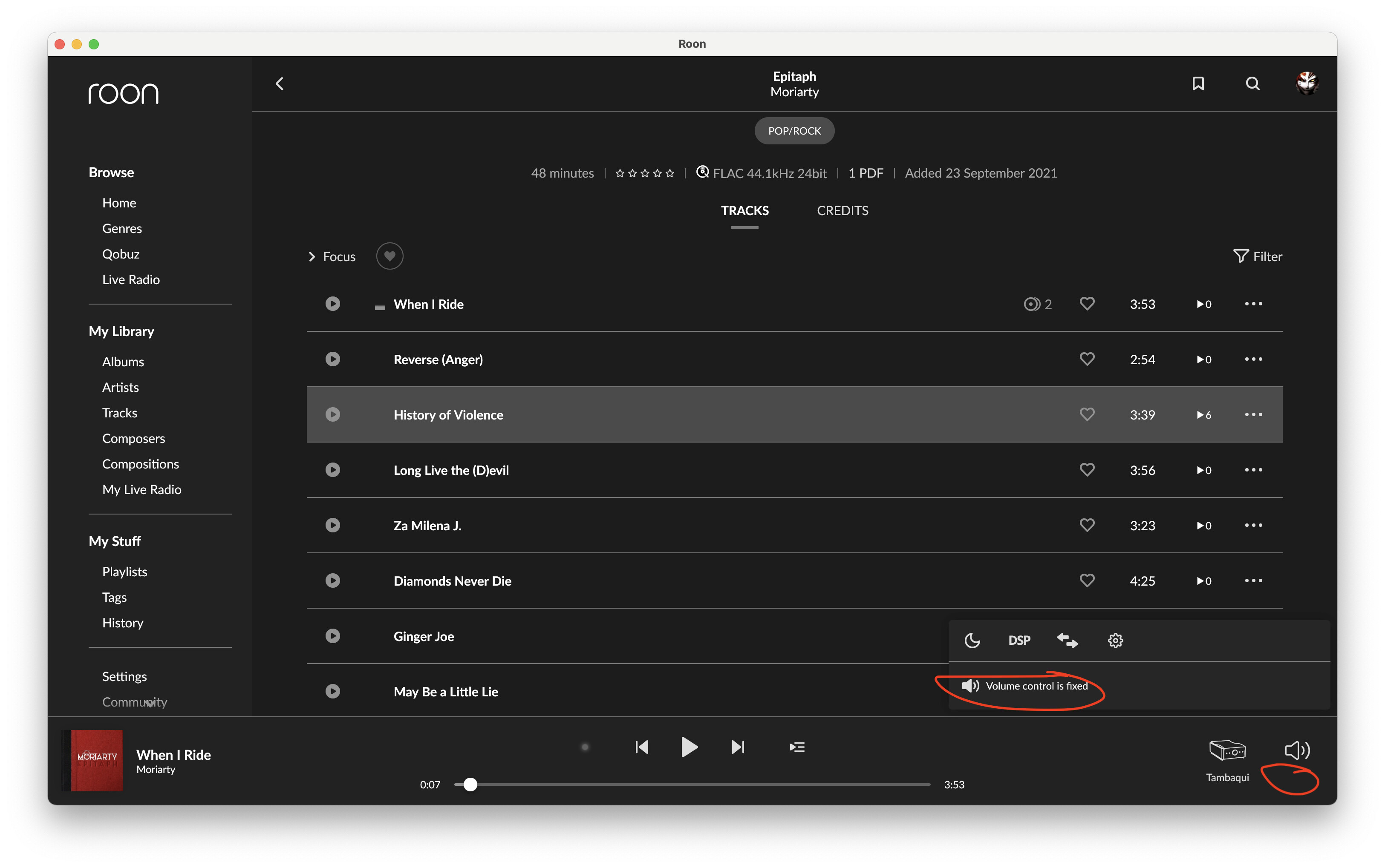

So this issue re-appeared again. See screenshots below that illustrate the problem.
Can’t really say much about how I ended up in this state. Nucleus+ is running 24/7 and the Mola Mola was in standby. Then I turned on the Mola Mola and left it unattended for about 30 mins or so. Then started my remote to start playing some music and I noticed that it was in fixed volume mode.
To get out of this state, a power cycle didn’t help (so maybe the issue is partly on the core side??). Switching inputs back and forth on the DAC is what did the trick (again).
