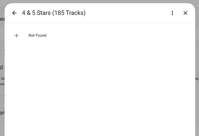

Smart Playlists not behaving with Media Player automation call
I’m sure a few people have thought this already. Will be fantastic to play a Smart Playlist from a Media Player - Play Media automation call.
Play 4 & 5 Star (tagged) songs when I get home from work! :star_struck:
I’ll take a look - although Roon may not have made them available via the api yet.
@GregD Thank you!
Absolutely understand
Looks like the api doesn’t support them properly yet
I will wait it out. Thanks very much @GregD

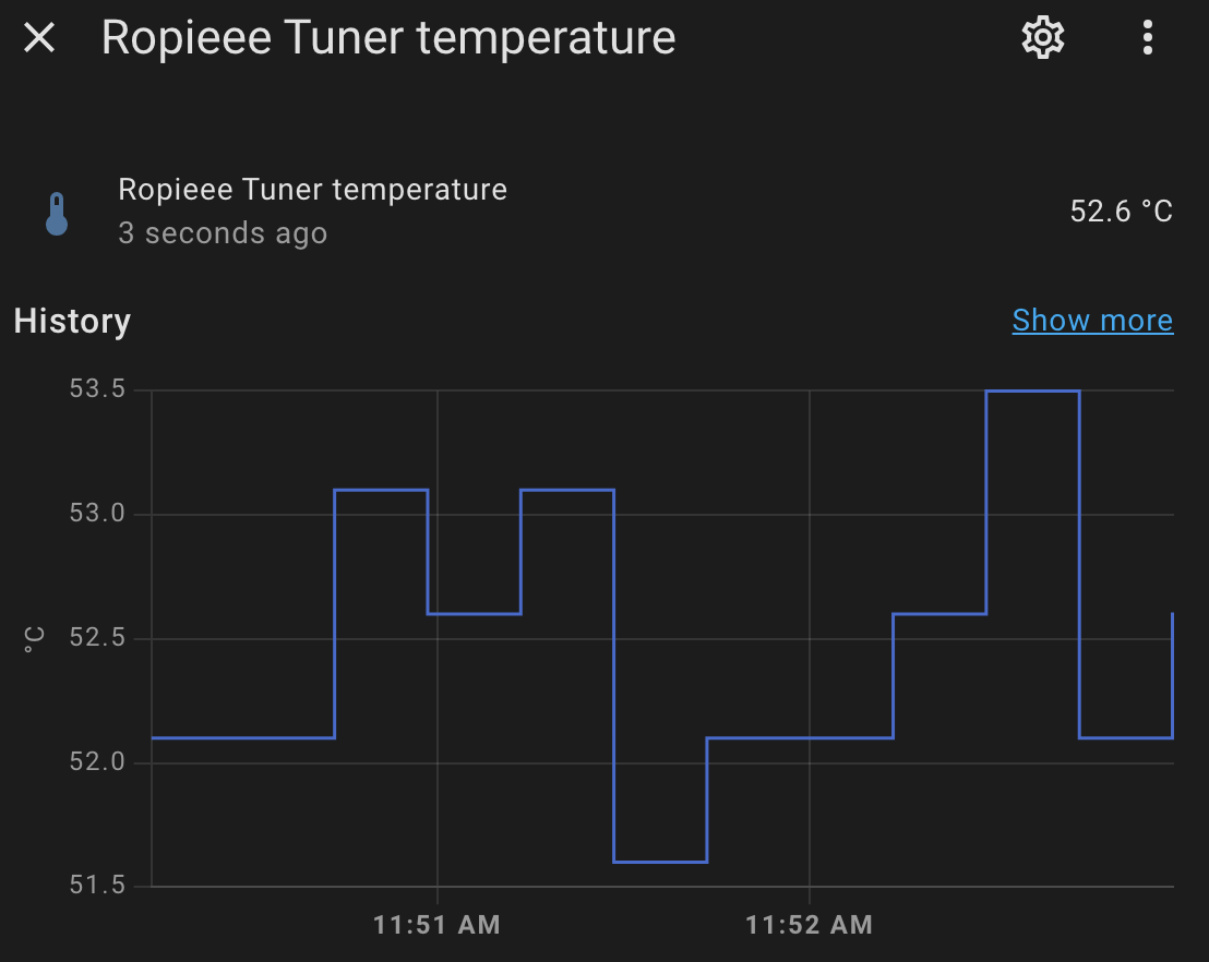

For anyone using HA as well as Ropieee, working with @James_Fitzell we’ve worked out how to get status data from Ropieee endpoints into HA.
You can see how to do this with temperature here:
The Ropieee api also makes some other status data available (eg whether there is is an update, and when the Pi was booted).
