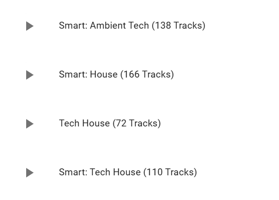

What is even more tantalising is that the amp in the HA Roon Player can see the smart playlists - but clicking them won’t play!
C’mon ROON can we please have access to these smart playlists via the API
Using tags and then smart dynamic granular playlists is so great (New, highly rated, Ambient Tech, not played this month) I really want to have one of these start when I get home from work
I doubt whether Roon Labs keep a close eye on the posts in the Tinkering category. I suggest you post this as a feature enhancement to the API in the Feedback > Feature Suggestions category. Roon Labs do read all posts there and in the Feedback category of the forum.

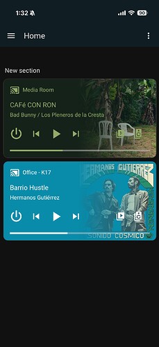

Of course you’re controlling Roon. The links @GregD provided are the answers you’re looking for. If you want a Roon zone to show up as a card on a dashboard, you add a Media Control Card to your dashboard and configure it to represent the Roon zone you want to control.
Here’s a quick example of what that looks like on a dashboard with two media control cards each controlling a different Roon zone.
Is this what you’re trying to do?

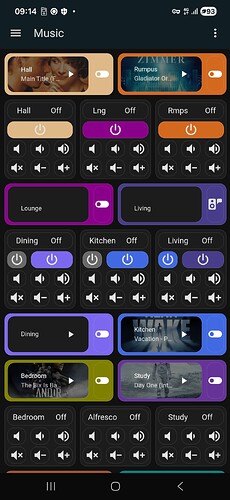

I’ve done something similar that’s evolved over time visually. It’s busy but that’s mostly due to the fact that I have a lot of zones. Some of the media player cards are conditional and show different players in certain conditions (e.g. if I’m playing to an endpoint using airplay instead of roon) and then several amplifiers have multiple inputs so the background colour of a powered on amplifier matches the colour of the respective player.
Like Greg says, grouping works well in HA. For my setup the little toggle icons will group a zone with the primary (currently Living but can be changed with a long-press).
The volume up buttons use a script logic to get current volume and increase/decrease by a fixed value (fixed per player but generally between 3-5) and the volume “sizes” jump to a specific default.
I always use roon to start music… but after that I use Home Assistant almost exclusively to control volume and add/remove zone groups. I have a mix of equipment and roon can’t control volume for all of them… in some cases I use the HA integration to go back the other way and use the volume up button in Roon to call my volume up script on the relevant amplifier.
