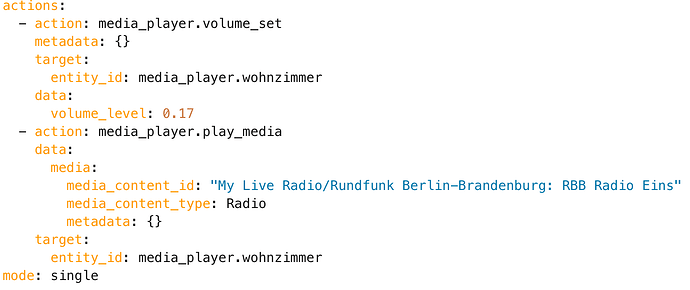

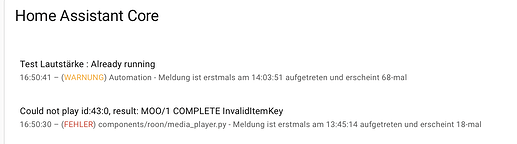

I am having a problem creating an automation. I want to start Roon playing a radio station which is saved in My Live Radio “Rundfunk Berlin-Brandenburg: RBB Radio Eins” at volume 17.

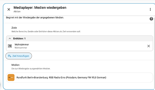

When using the visual editor everything is working fine except the most (to me) important function media_player.play_media. It works exactly one time and then never again.

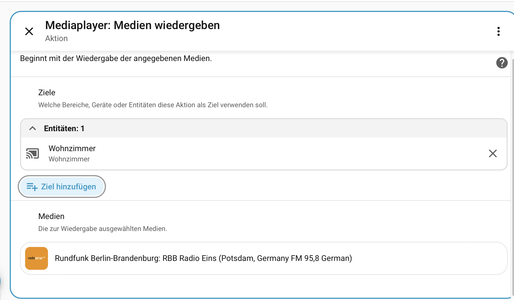

This is the visual editor:

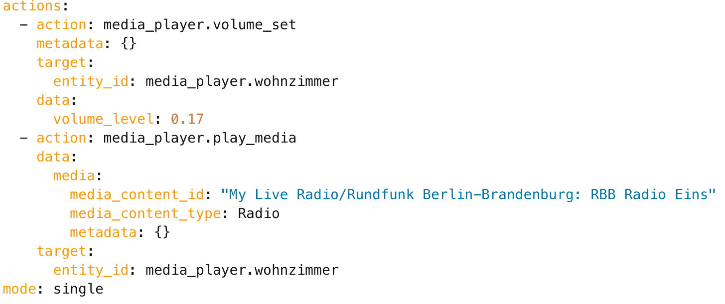

This is the associated yaml as being set through visual editor:

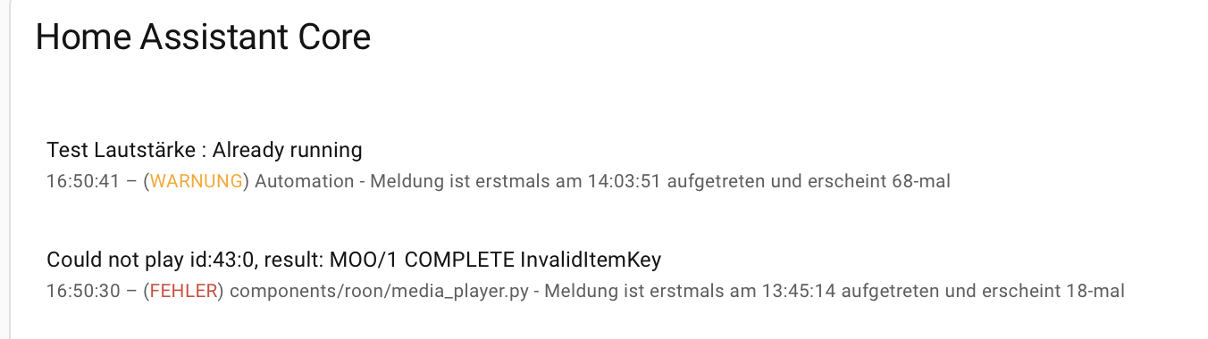

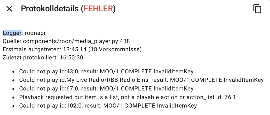

This is the protocol:
Protocol details:
I was spending several hours trying this and that, googling, asking chatGPT and so on.
Is this a bug affecting media playback? Or do I something wrong? I guess not, because changing volume, stopping and so on work as expected.
Roon media players in home assistant can’t understand the media ids used by other home assistant media players because roon doesn’t use unique media ids
You need to specify a path as described here
(And as usual ChatGpt makes guesses and is wrong!)

I was finding your explanation a little later after writing my post. I think I was trying 20 different variations, but was not successful. I will give up at this point and I will stay with macro.on. With this Roon extension it‘s absolutely easy to choose a favorite radio station from a dropdown menu and to connect it to Home Assistant via rest_command. Unfortunately the connection of Roon and macro.on is not stable. I have to restart the docker container once a week. This is the reason I wanted to switch to do it in Home Assistant.
Asking Claude.ai was giving the right hint and it is working now.

Firstly take a look in the HA log, if a play command fails there should be a useful error.
