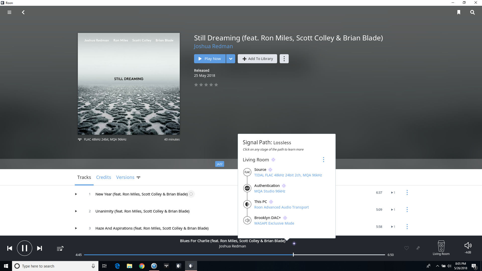

Can you send me a screenshot of your Roon Signal Path?
-John
Here it is. Roon is currently set to expect the dac to take care of unfolding and rendering
