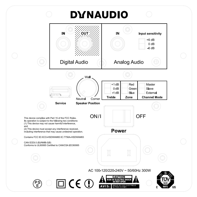

What inputs do the Dynaudio speakers have?
Both coaxial (XD s built in dac) (192/24) and analog inputs.
So OP would need a separate MQA dac into the analog inputs.
I own flagship model XD 60…4 drivers.
I always go for the Coax digital input

What about a good quality optical-coaxial converter sitting between optical out of the iMac and coaxial in of the speakers?
There’s loads around from about £10 but you can spend more.
You’ll need to check it can pass 96/24, but it should do. Roon would do the first unfold and pass 88.2/24 or 96/24 (depending on MQA source) to the iMac optical out. Convert it to coaxial with your £10 converter box and use a single RCA to feed the Dynaudio’s Coaxial digital input.
Worth a try for a tenner.

How do you connect it? I´d like USB out of iMac and SPDIF into my DynXD´s

If you want to go the whole hog, you’ll need an MQA certified DAC and either use it as a renderer… passing on 192/24 to your co-ax speaker input, or as a full DAC… passing analogue to the Dynaudios.
