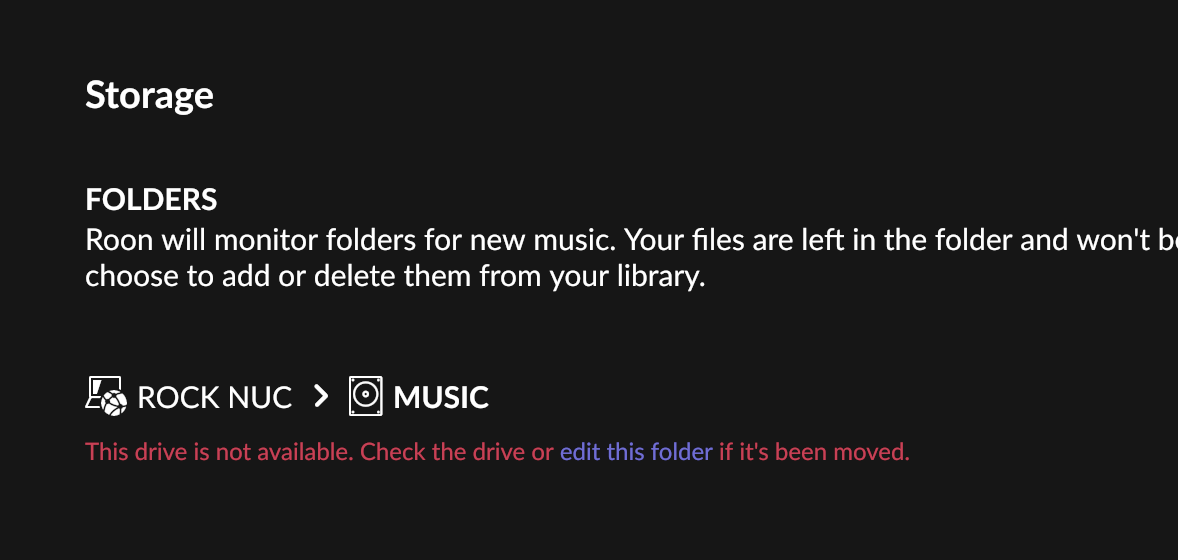

Does it show as unavailable in Roon > Settings > Storage where you had added it in the first place
No. I see this now.
That should’ve said ‘Yes. I see this now’ :slight_smile:

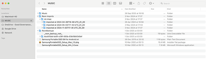

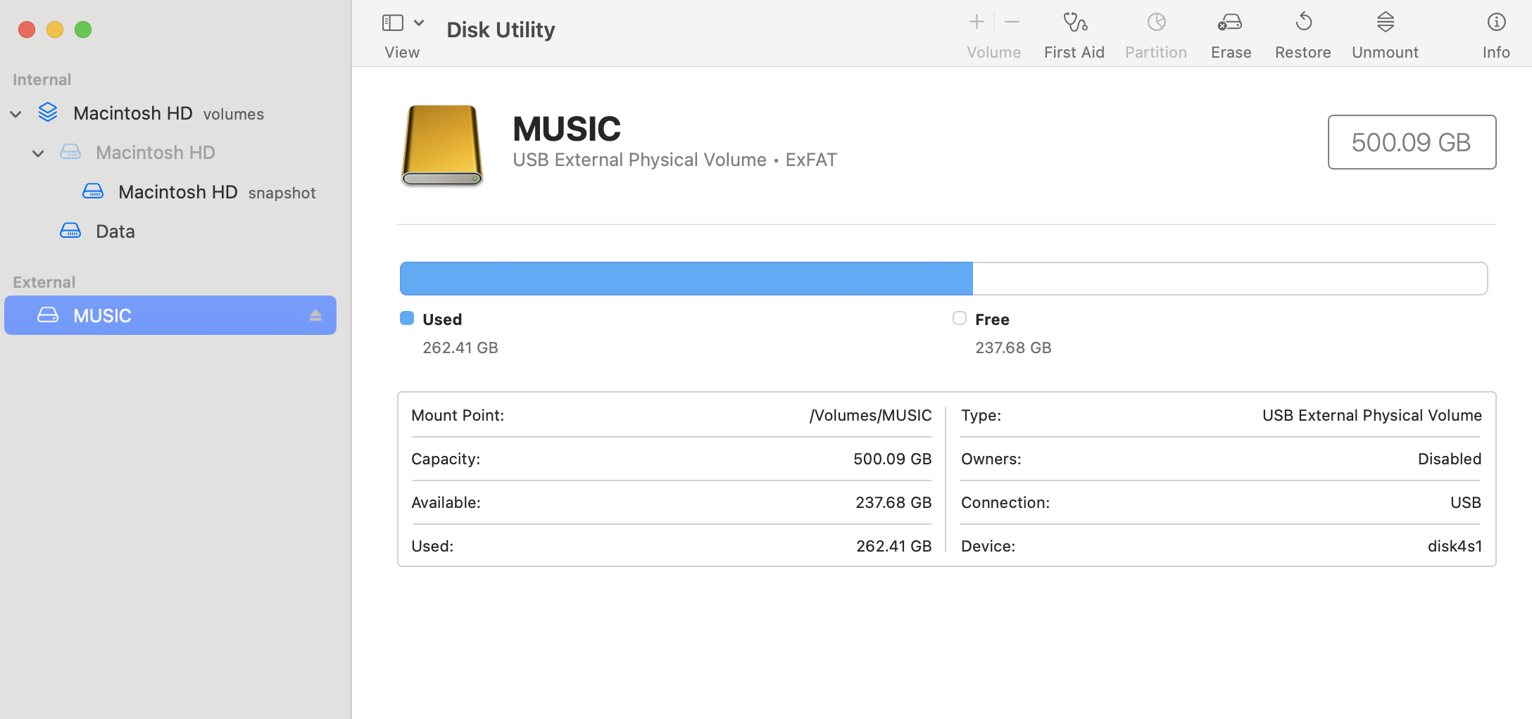

Can you please clarify for us whether you have the disk plugged in currently to your ROCK ?
Also, can you please properly shut down ROCK, mount the disk to the Mac and share a screenshot with us of what does finder and Disk Utility show ?
Thanks for the reply and no worries on the delay.

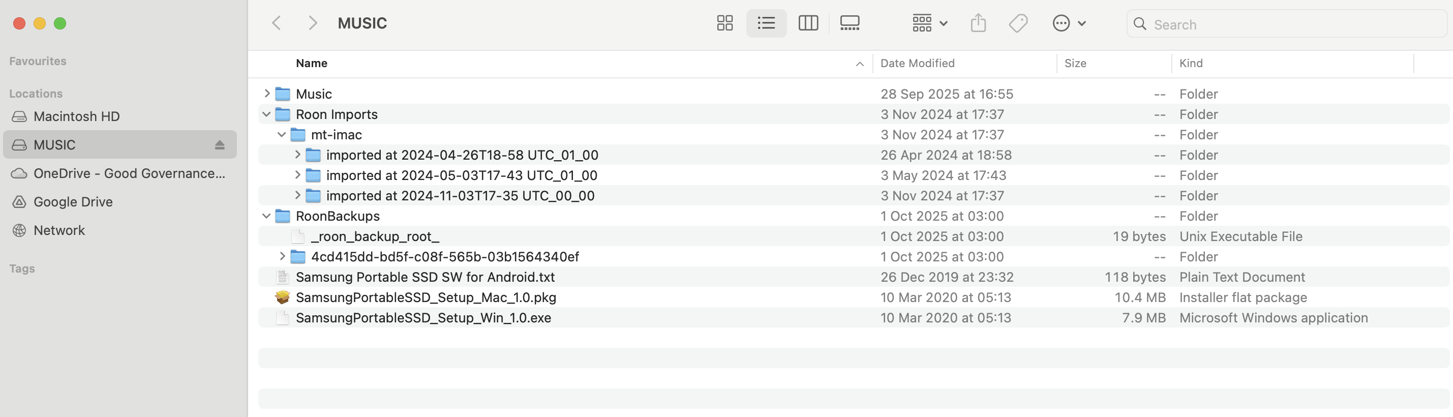

The disk was plugged in correctly as far as I could tell. I’ve now shut down the ROCK (didn’t realise you could do that via a web interface…every day’s a school day!) and attached the drive to my work Mac (different machine) and it’s looking like the files are all there. See attached.
Bumping this one.
I should have added that the files are indeed all present and correct when I look at the drive on my Mac. Which is something of a relief, I don’t mind telling you!

Hey @MT2,
Thanks for the update! This is all good news. I’d maybe make another safe backup of your local files outside of the external drive if you haven’t already - just to be safe.
Feel free to safely de-tach the external drive from your Mac, and then plug it back into your ROCK while it’s shut down.
Then, restart everything through the web UI and verify that Roon Server is running. We’ll enable diagnostics on your Roon Server instance to investigate what might be causing the connection issue.
Once it’s back online, try reconnecting and let us know if by chance everything is working properly.
Thank you! :raising_hands:
OK, that’s all done and everything seems to be working fine. So in a nutshell, all I had to do (apart from not messing about with the SSD in the first place) was to turn the NUC off, reattach the drive and turn it back on again.
