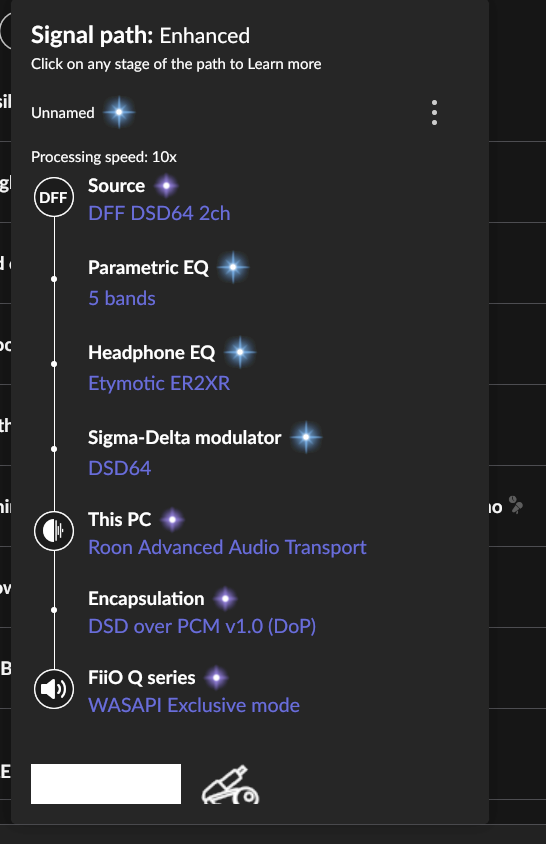

I think it is a display issue (regression). For example, if PEQ and headphone EQ are active, only the first is displayed. Likewise, use crossfeed and PEQ, and only crossfeed is displayed.
PS. Doesn’t affect PCM.

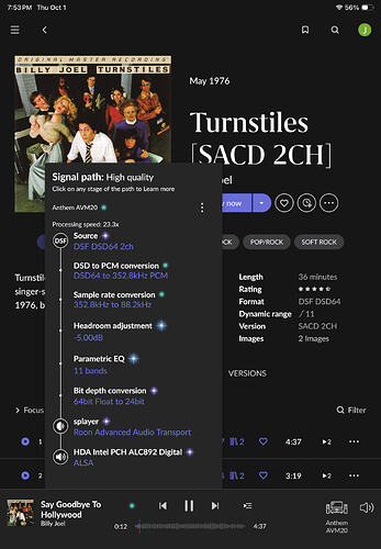

My apologies if I’m misunderstanding the issue. Conversation to PCM is still showing for me.
The regression is not when selecting conversion to PCM, but when applying DSP to DSD, and sending DSD (or DoP) to the DAC.

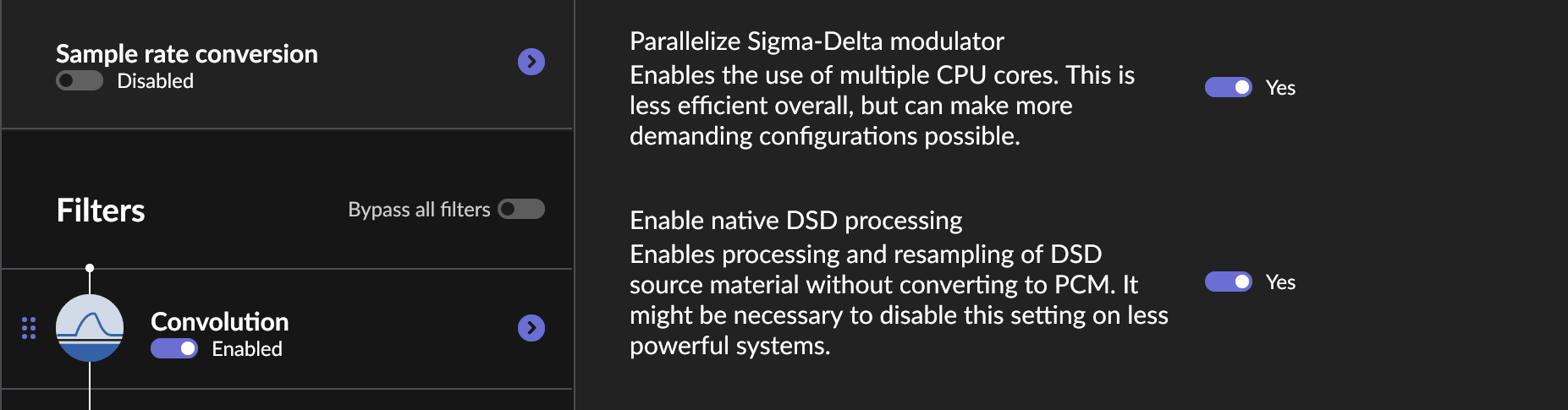

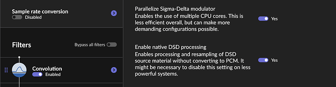

It’s still here, hidden in MUSE’s sample rate conversion settings. I assume ‘processing’ here means more than sample rate conversion.
It’s just avoiding rate conversion, that’s all.
