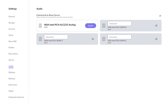

Can you post screenshots of
  • Roon’s :gear: > About page?
  • Roon’s :gear: > Audio page?
They might give additional information to help diagnosis of your issue.
I assume that you used the setting in Roon’s :gear: > Setup page to rename the Roon Server on your ROCK/NUC?
Hi, Geoff,

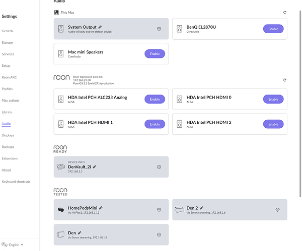

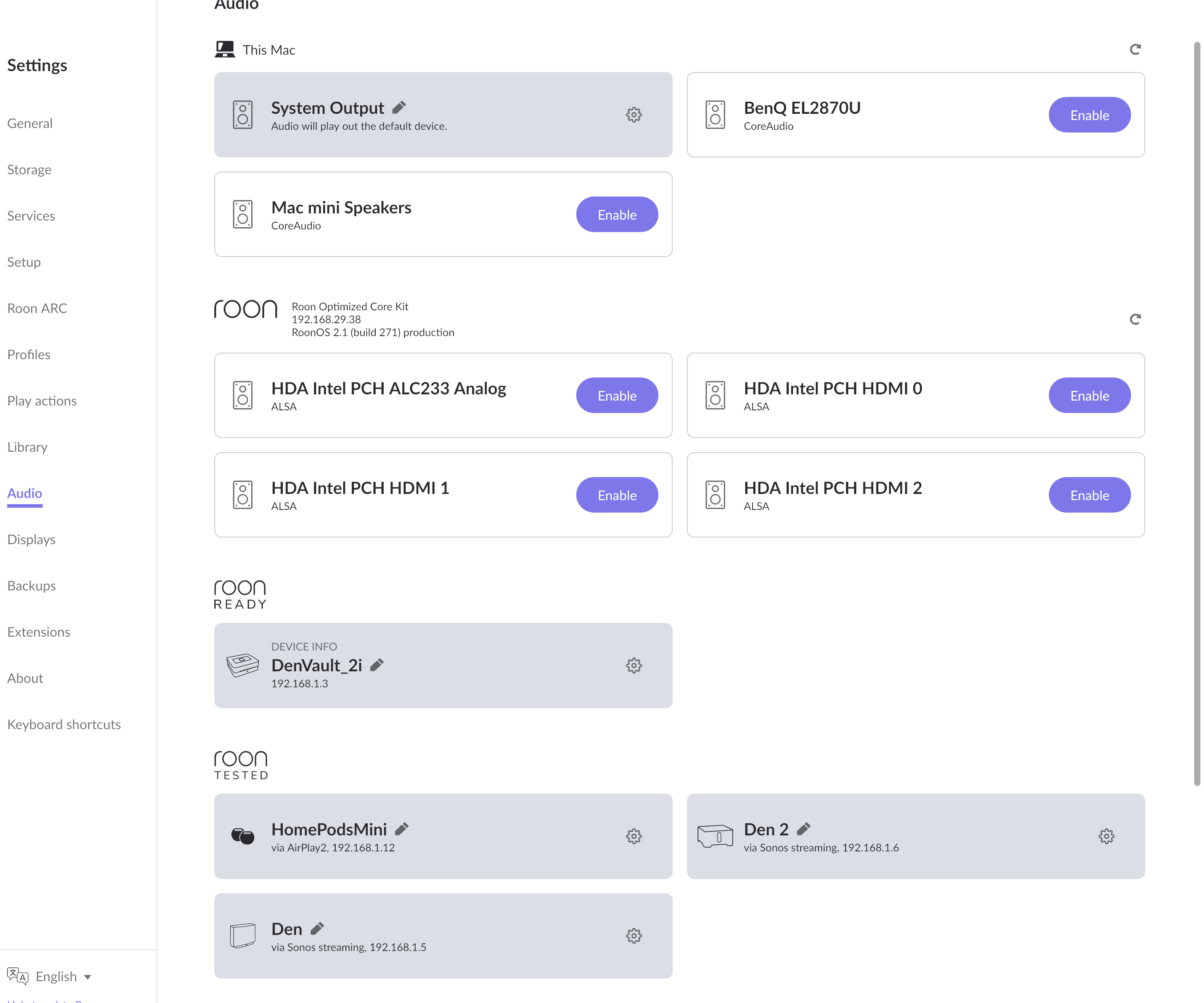

Attaching 2 sets of screenshots - 1. With dedicated NUC as Roon Server 2. With MacMini as Roon Server. Both on same network, except that NUC is connected via Ethernet whereas MacMini is via Wifi.
Hi @Pratik_Basu,
It looks like you have two subnets on your home network:
ROCK NUC : 192.168.29.xx
Mac Mini and the networked endpoints 192.168.1.xx
You need to have all devices on the same 192.168.1.xx subnet.
A couple of things to explore…
  1. Make sure the ROCK NUC is configured to use DHCP (and not static).
  2. Reboot your network router, wait for it restart completely (say 3 mins), reboot the ROCK NUC, and then check what IP it is now using.
If that does not help, can you describe how you network is arranged eg what router(s) are you using, how are that connected and how the NUC, Mac, and endpoints are connected.
