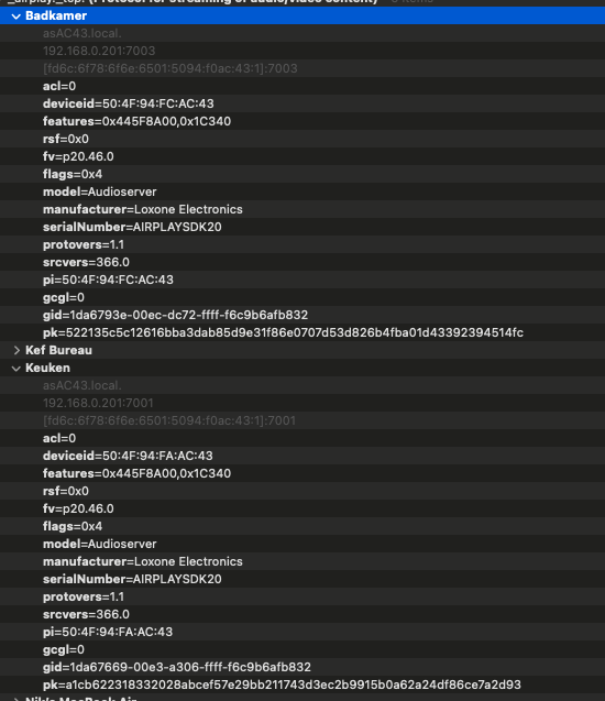

My Loxone Audioserver exposes 2 zones: Badkamer (Bathroom) and Keuken (Kitchen), but only one shows up in Roon: Keuken.
I tried several restarts of the server and checked the logs, nothing is mentioned about the missing endpoint: Keuken (Kitchen).
Note: both endpoints are exposed on the same ip, but use a different port.

My Apple devices discovers all Airplay 2 endpoints exposed by my Loxone Audioserver.
Endpoints info fetched using a Discovery app:
Any reason why Roon does not see the endpoint on port 7003?

Thanks for your patience. We’re working with development to confirm whether it’s plausible that Roon would ignore a second device announcement from the same IP if the other txt fields also match. Based on your initial screenshot, the port number is the only differentiation here - Roon might be considering the Badkamer Zone to be a duplicate based on the mDNS traffic.

The issue here is quite possibly the shared persistent ID field in the Airplay2 discovery data you shared. Note that both Keuken and Badkamer share the same pi=50:4F:94:FC:AC:43 entry in your original Discovery app screenshot.
I recommend keeping one of these speakers off entirely until you’ve already opened Roon and paired with the first visible Zone (either Keuken or Badkamer). Turn on the second speaker and click the refresh button in the Roon Settings → Audio page.
