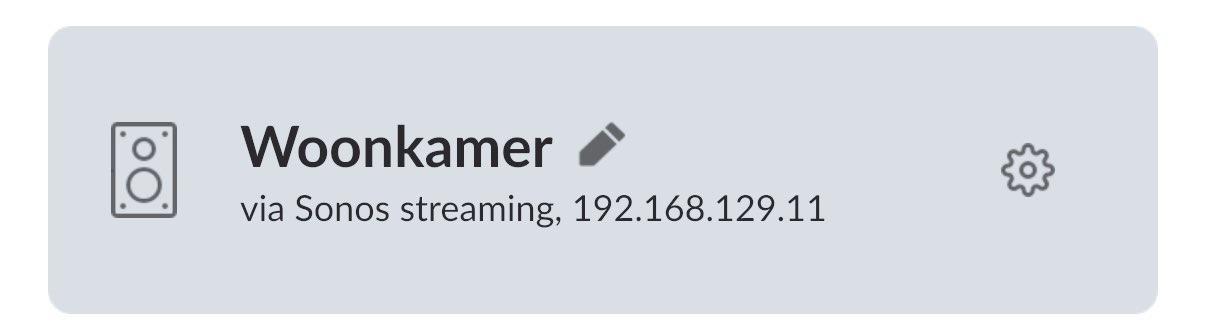

• Test with Rameau: “Pygmalion - Iso: Zémide” by a nocte temporis, Reinoud Van Mechelen; mainly tracks 9-18 (short ones) - https://i.imgur.com/1nSbdeg.png

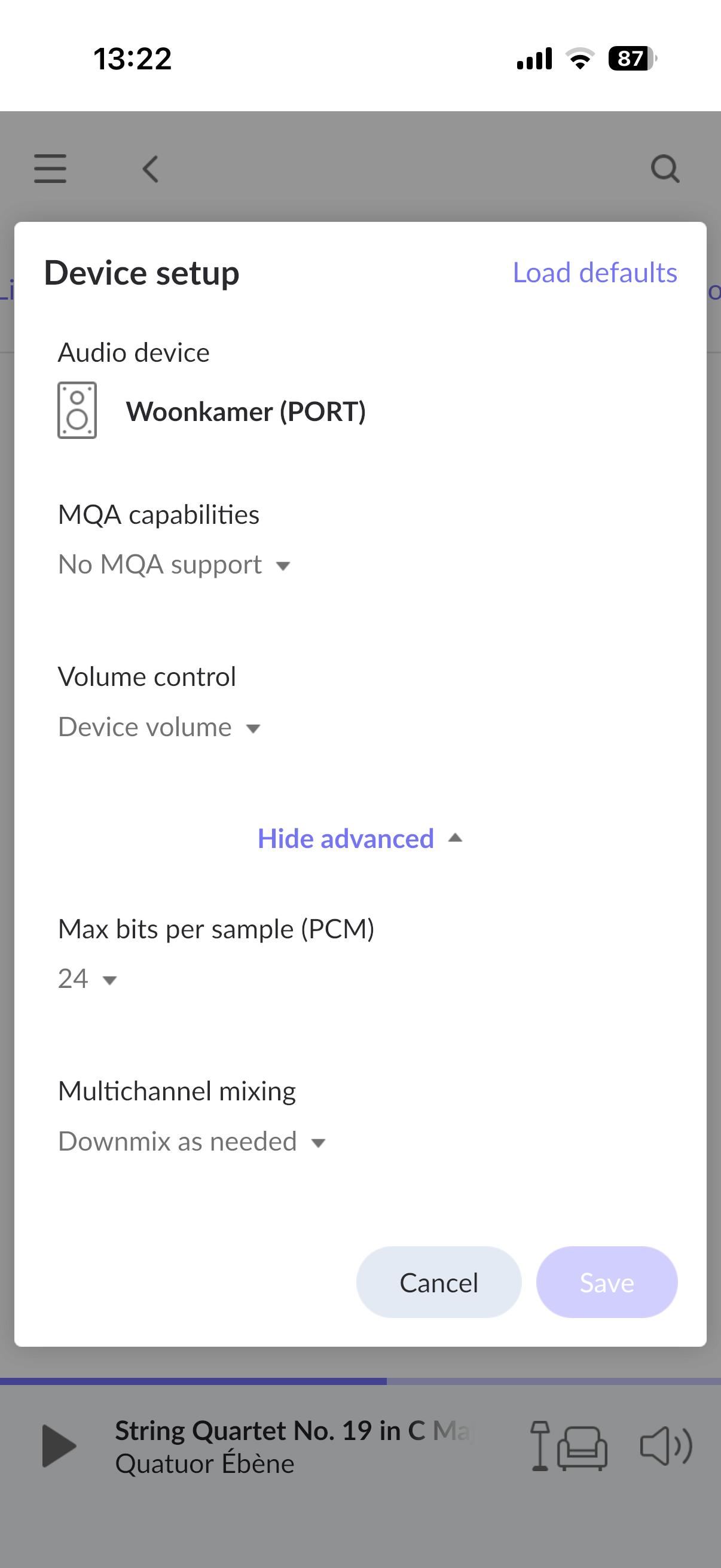

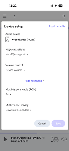

Hi @vadim I’d love to try, but there is no resync delay setting in my Sonos zone device setup. What you can see in the attached image is all there is. When I open device setup for Sonos via airplay, there is no resync delay setting either. In my iPhone device setup there is the resync delay setting…
