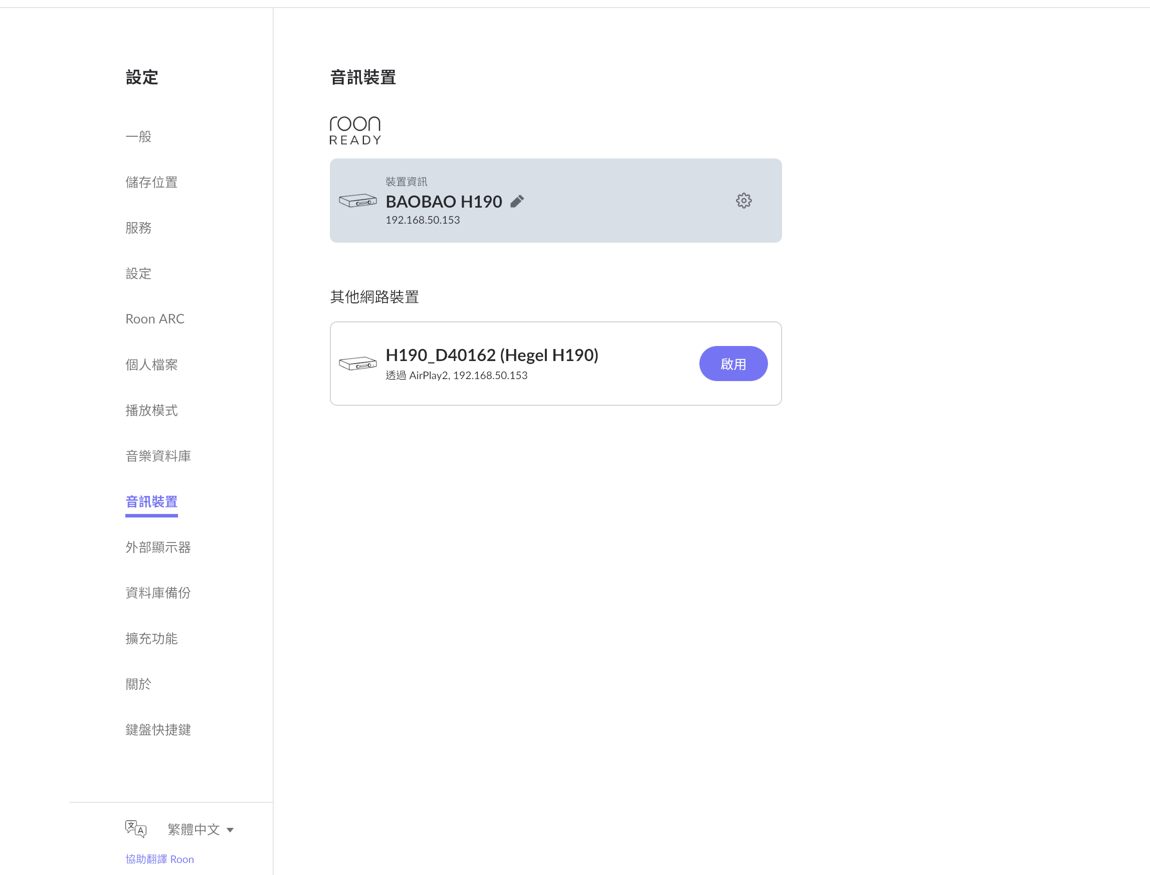

Roon not recognizing any USB DACs (ref#GBR0N2)
· Roon won't recognize any USB DAC
· ROG Rapture GT-BE25000 is my router with ASUS GX-U1081 as switch, no VPN
