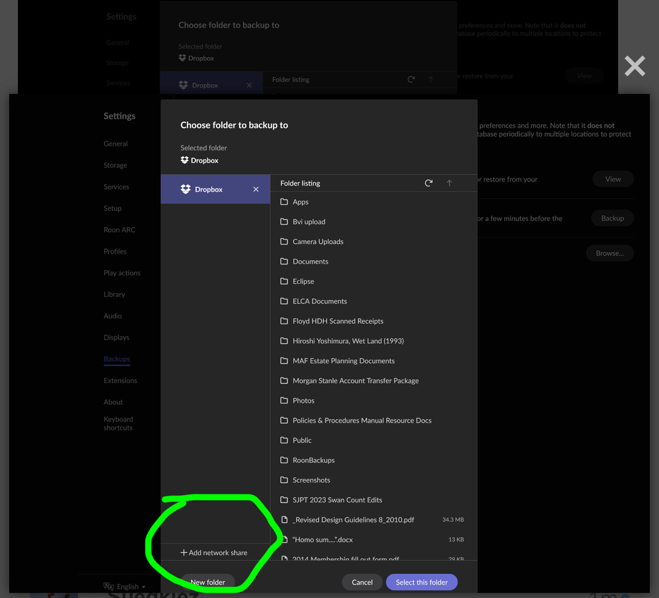

· When I Browse for a location to back up my Roon Database, all I see is Dropbox. I am already backing up to Dropbox. I have an external storage device plugged into my MacBook Pro Laptop, but Roon does not recognize it. How do I make Roon see the giant empty and unused storage device that is just waiting to be filled with backups?

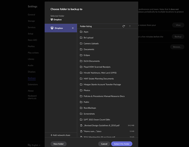

If possible, please also provide a screenshot from the following location in Roon:
Settings → Scheduled Backups → View → (three dots) → Edit → Browse
This will allow us to see exactly what locations Roon is able to access on your system.

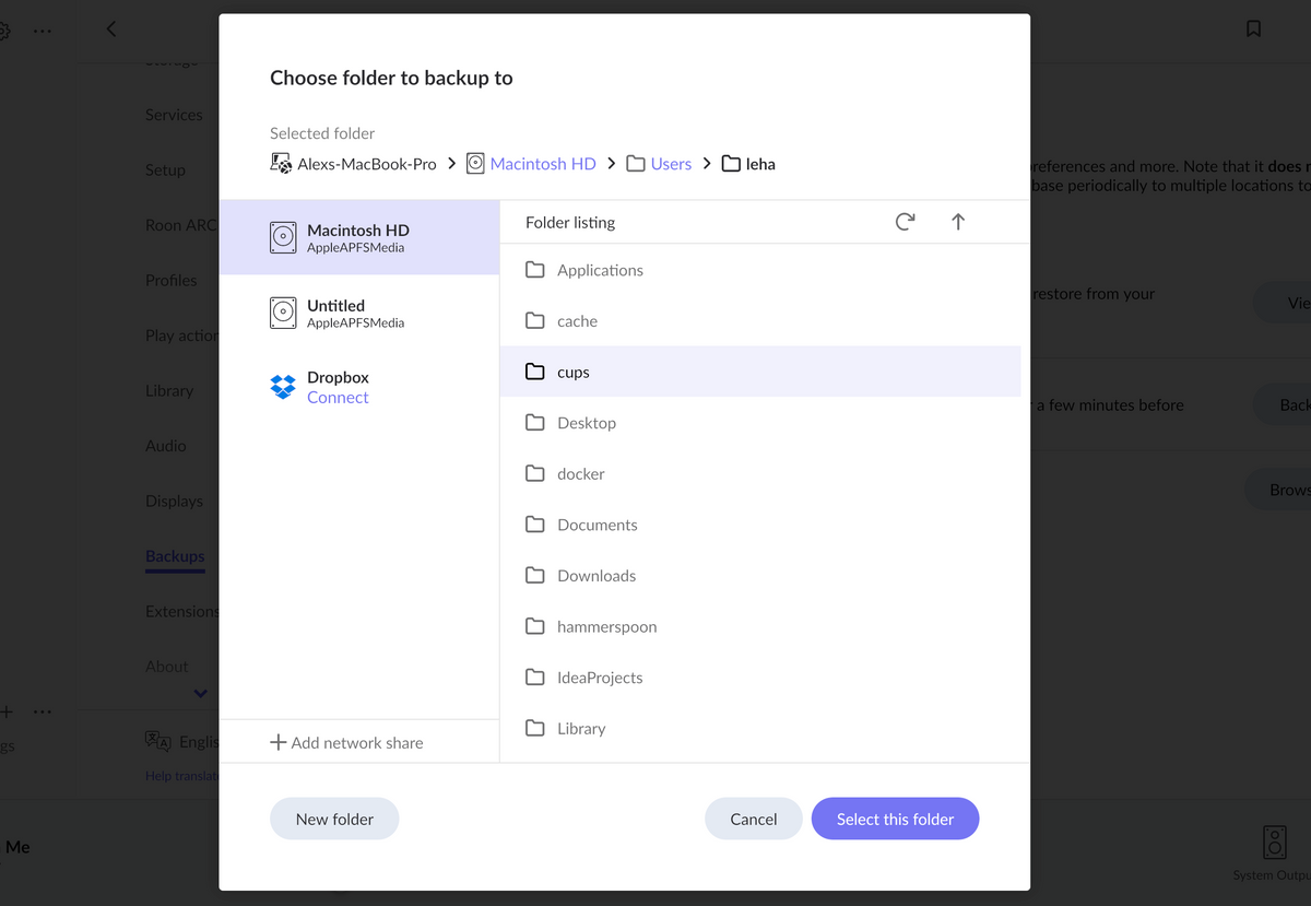

Additionally, please go to Settings → Backups → Scheduled Backups and share a screenshot of the location options you see there (similar to the example below).

Screenshot is attached. You will note that Roon sees neither the external drive nor MacIntosh HD.

Err, I sent you the screen shot you asked for. Got any thoughts on why the neither the external drive nor Macintosh HD are seen by Roon?

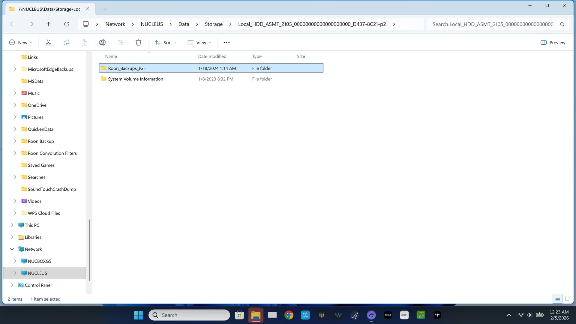

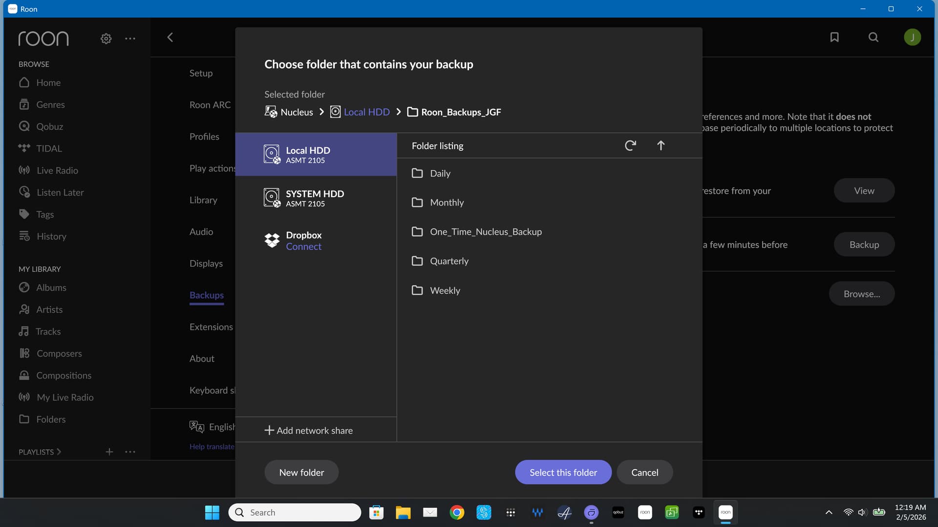

Here’s what mine looks like. I don’t recall exactly how I was able to find it in Windows Explorer, but it took a lot of clicking around to work my way to it. My drive is connected to my Nucleus with a USB cable. That’s the best way because your Nucleus will run 24/7 and automatic backups can occur in the middle of the night if you prefer.

@Ben_B_Floyd,
Thanks for the update. It looks like there is a slight confusion regarding the connection.
The Setup
  • The Brain: Your Roon Core (database) is running on the Nucleus.
  • The Remote: The Roon app on your Mac is acting only as a Remote Control.
Because the "brain" is on the Nucleus, it can only write backups to a location the Nucleus itself can reach. When you plug the drive into your Mac, it is physically invisible to the Nucleus.

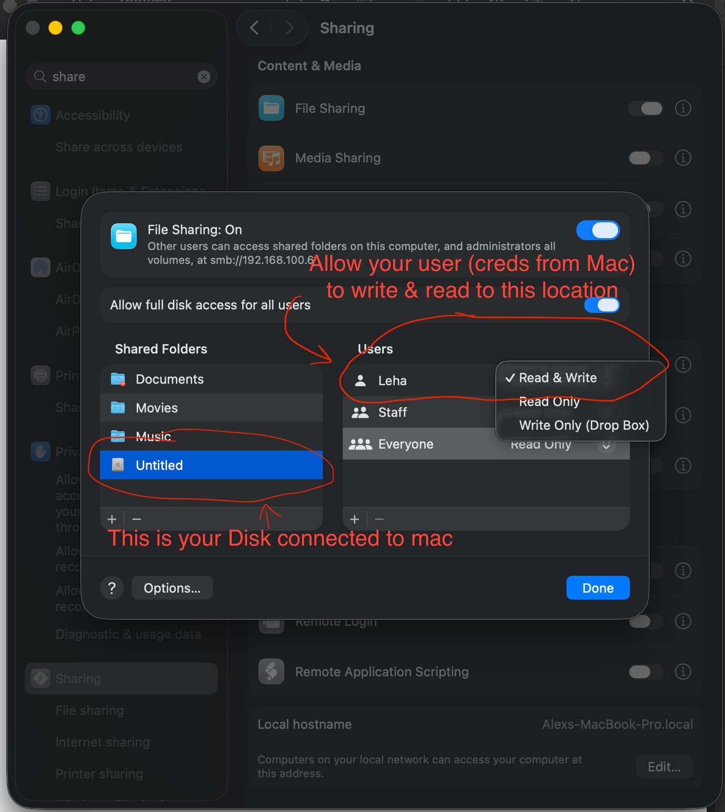

If you want to keep the drive connected to your Mac for backups, you must share it over the network so the Nucleus can access it.
  1. Connect the SSD to your Mac.
  2. Enable File Sharing:
  1. Configure Roon:

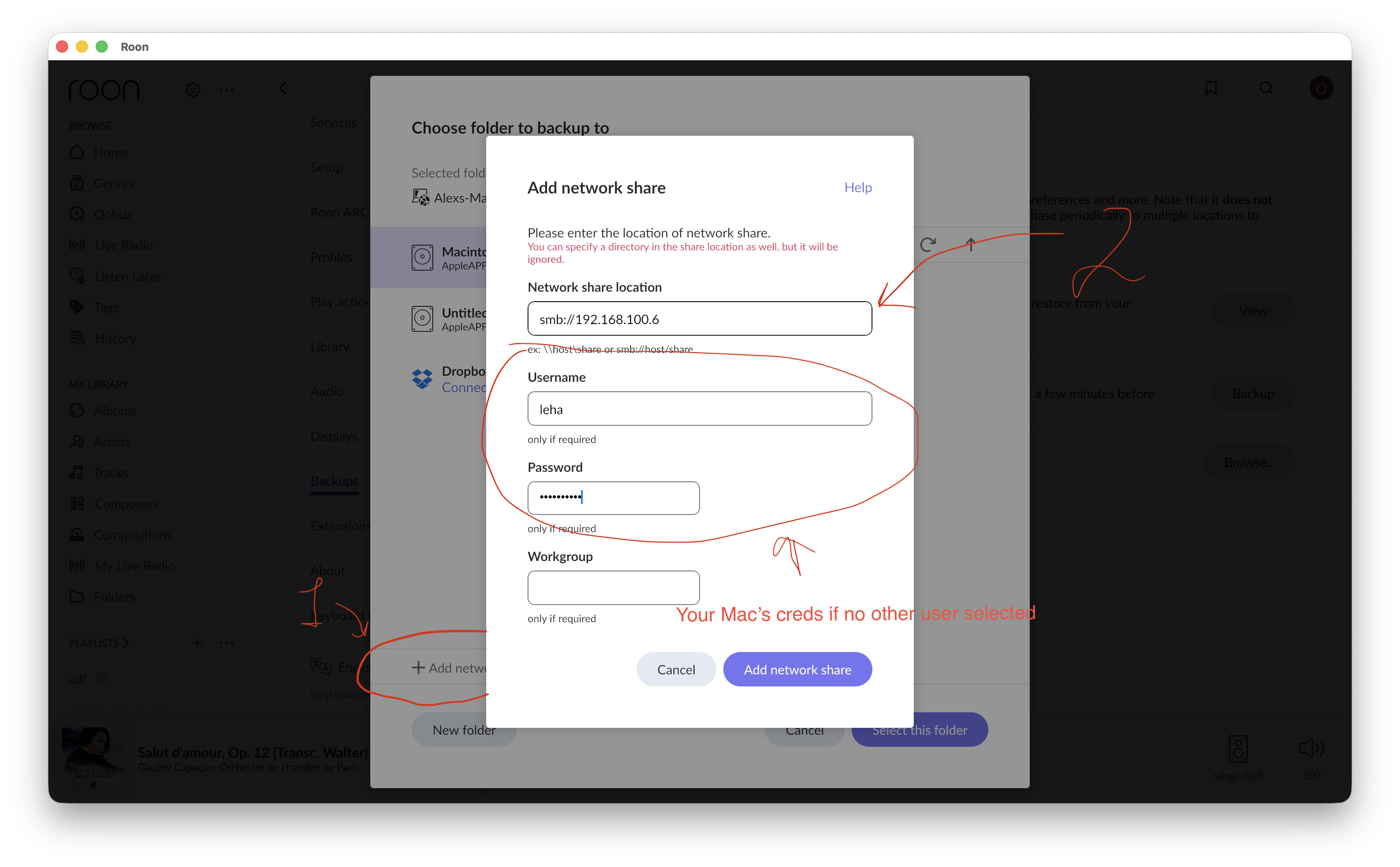

  • In the Roon app, go to Settings > Backups > Add Location.
  • Select Network Share.
  • Enter the network path to your Mac (e.g., smb://YourMacName/DriveName) and your Mac username/password.
    Success! You should now be able to back up to the disk inserted in your Mac.

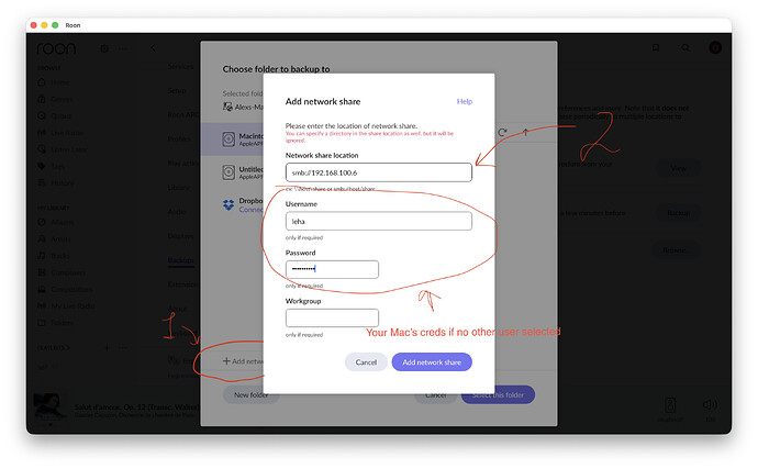

Thanx Alex. Prior to contacting support, I enabled file sharing and permissions as outlined in your support documentation and again above. I also tried to add a network share as outlined in your support documentation and again above. My first attempt using my Mac’s name was unsuccessful, yielding a “host not found” error message. The second attempt using my Mac’s IP address was unsuccessful, yielding an “unexpected error” error message.
@Ben_B_Floyd,
To help us figure out why the Nucleus isn’t letting you in, could you please share a few specific details?
  1. Roon Settings Screenshot:
    Please share a screenshot of the screen in Roon where you are entering the Network Path and credentials.
  2. Mac Sharing Settings Screenshot:
    Please share a screenshot of the System Settings > General > Sharing > File Sharing window on your Mac, specifically showing the folder you are trying to share and the user permissions assigned to it.
  3. Credentials Check:
    Are you using the exact same username and password that you use to log into your Mac?
Once we see these settings, we should be able to spot the mismatch.
