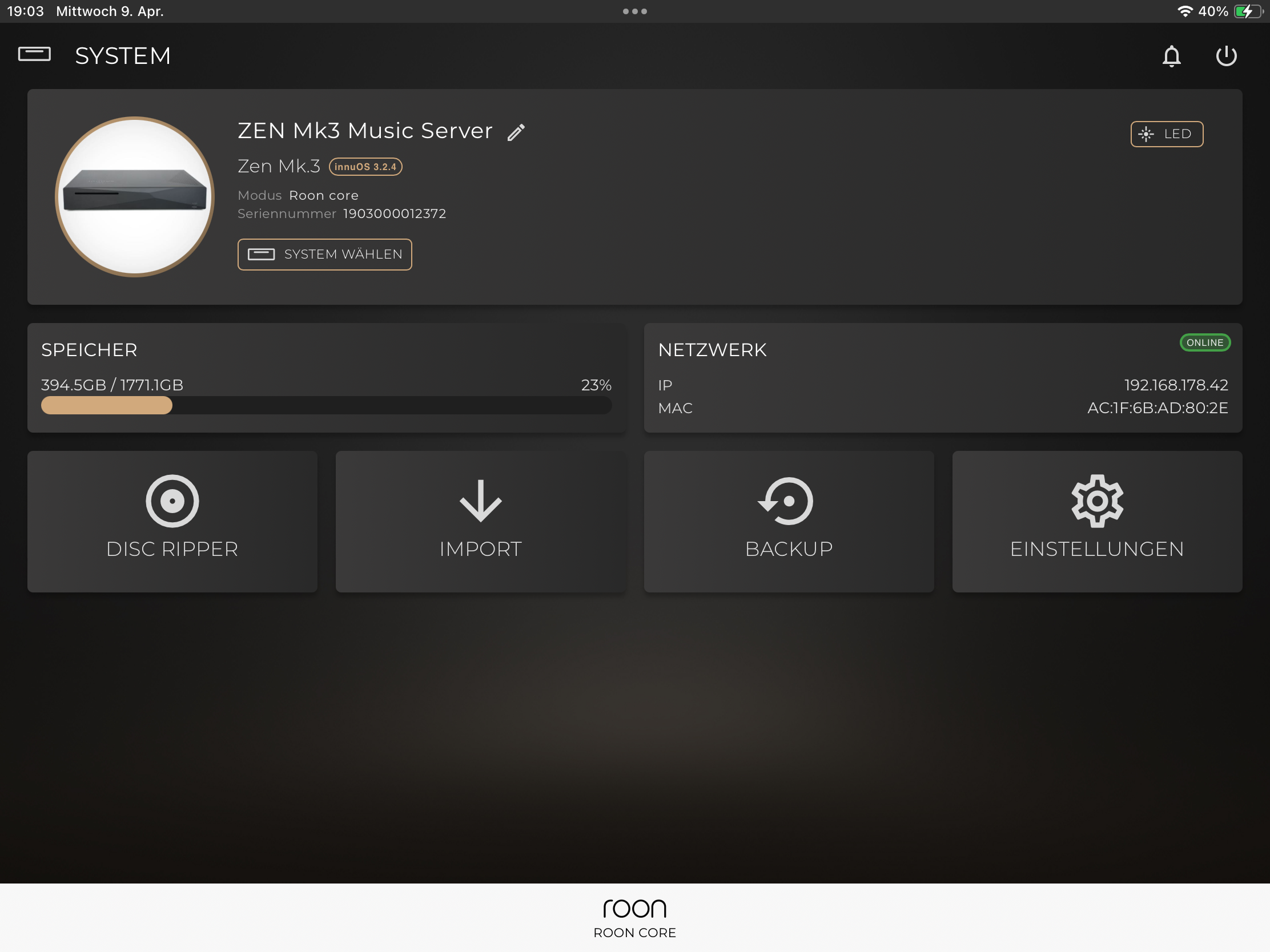

Roon stopped recognizing my Linn Selekt DSM as audio zone
Linn Selekt is directly connected to Innuos Zen mk3 via Ethernet

With what software I am supposed to do what you are suggesting:
Only having an Ipad and Innuos Zen mk3 as Server.
