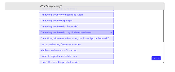

So please open up a new support request in Support and follow the “I’m having trouble with my Nucleus hardware” route to raise an RMA directly.
