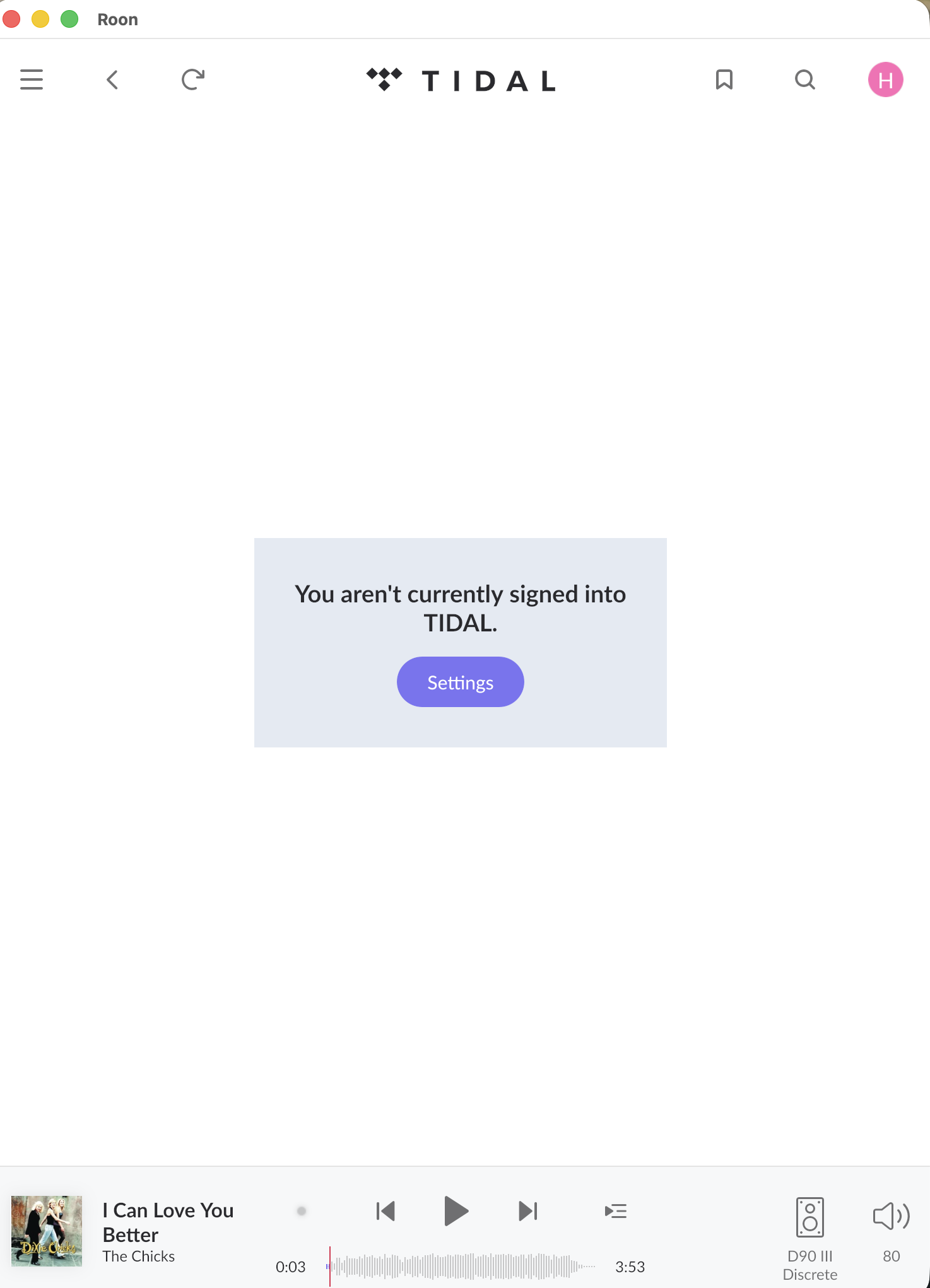

Tidal login successful - Tidal works independently but Roon says I am not logged into Tidal
Running Roon service on a different Mac Mini M2 - connecting via cabled Unify network - rebooted both computers. Roon starts and runs fine but show Tidal titles as Unavailable.

Thank you for your post. Tidal authorization passes only through the server, so you shouldn’t be required to login separately on each remote.
What do you see in Settings → Services → Tidal in Roon? What about if you open Roon on the same machine hosting your Roon Server instance, the other Mac?
Are you able to login to Tidal directly via their webpage on the machine from which you shared your screenshot above (the Mac with which you’re having trouble)?

I don’t normally run the roon client on the server miniM2 but I could try that.
I can log into Tidal and run the Tidal app on my Studio successfully - that is my workaround for the moment.
Hagen
WIthin the Roon App Tidal shows “Not Configured” although I have been using the two together for years.
I figured out the problem I was using the wrong login. Tidal accepted both (odd) but only one turned on the roon integration. Thanks for your help!
