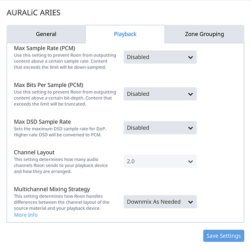

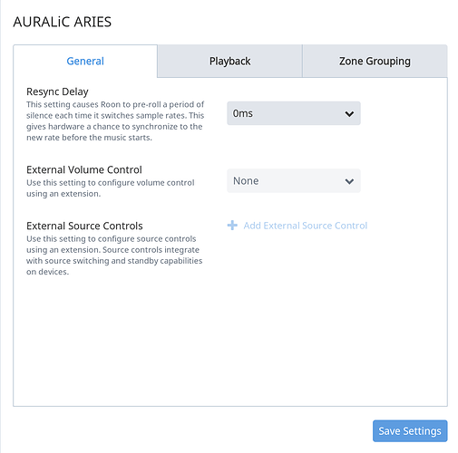

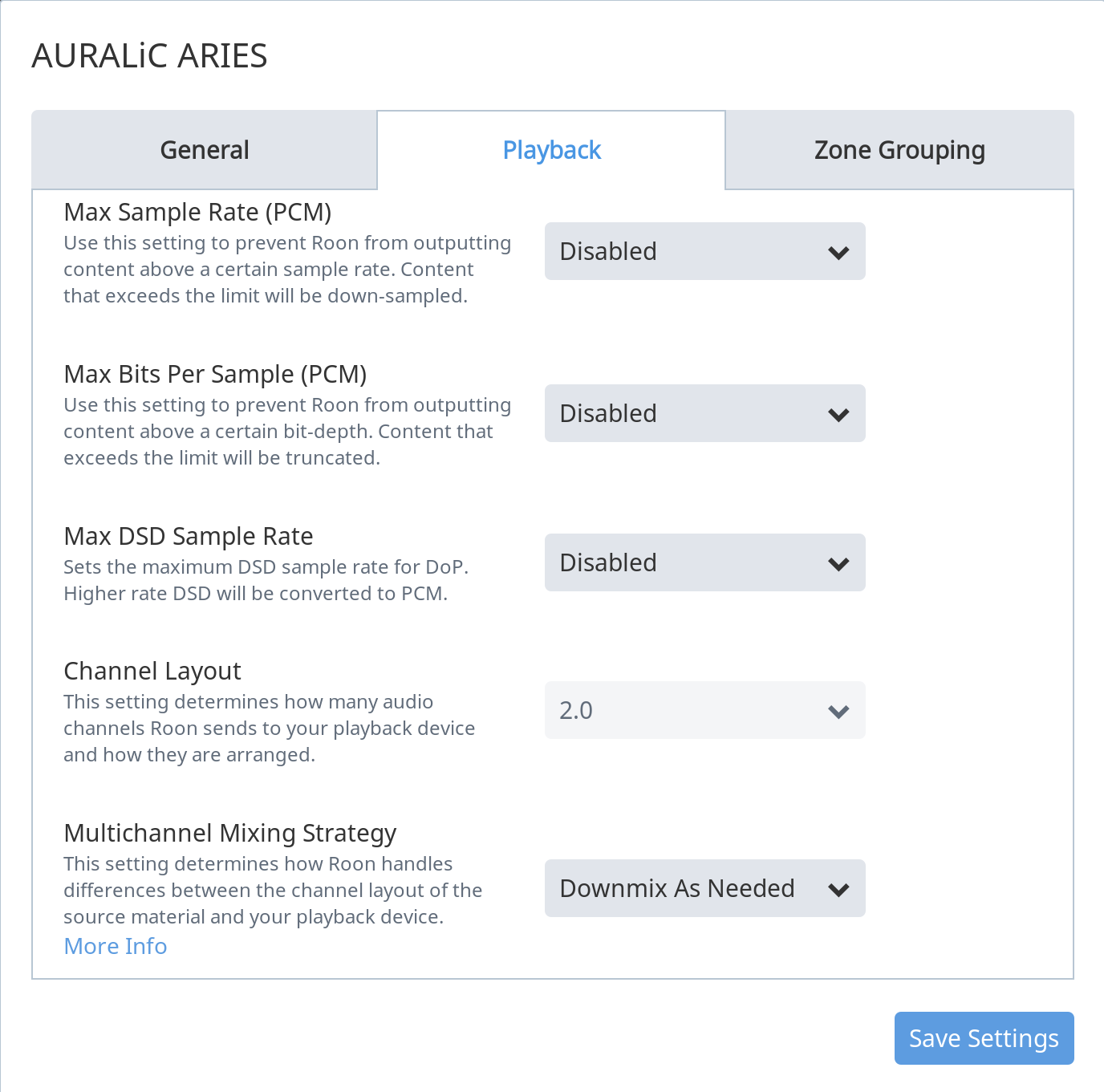

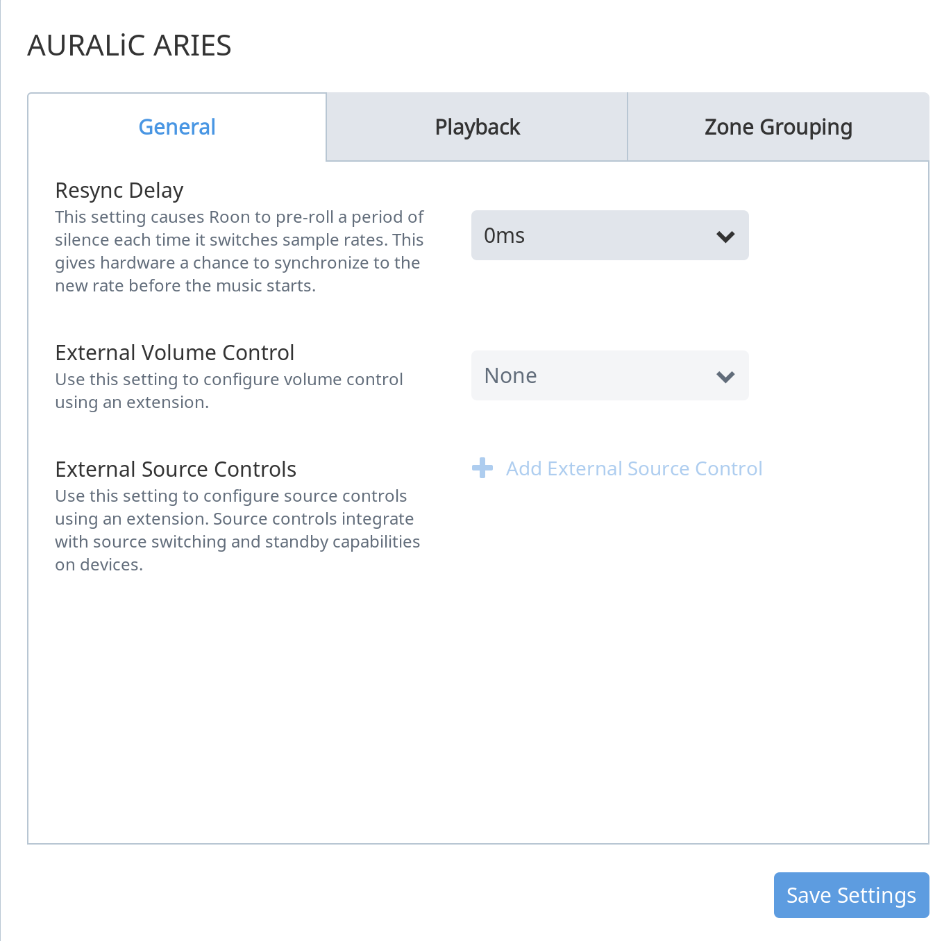

In Roon, can you provide a screenshot of the settings for your Aries/Vega Zone ? This will help identify any settings that may be causing a problem.

Roon is an available input for the Aries. And, yes, you are correct regarding the setup with the USB connection.
Attached are a couple of screenshots from the Roon Zone settings (basically, everything is default at this time).

Hi Reid,
Yes, vanilla as you say. I can’t see anything in those that would cause an issue.
