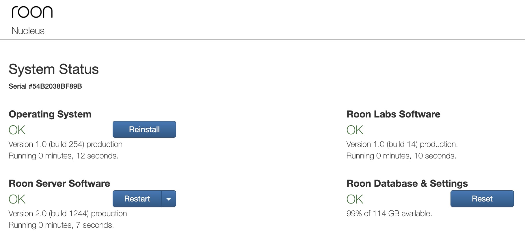

I have stopped/started the Roon server through the web link, I attached that image.
