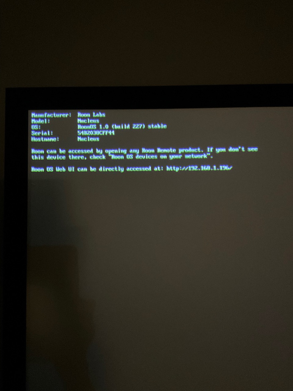

Yes. and no error msg. Here is the HDMI screen. Prior to it crashing I can log into it. After it crashes I cannot nor can Roon see it. I have to reboot.
Perhaps your suspicions are correct, and you have a bad M2 drive. If you’re sure the layer 1 stuff is good, you could first try re-installing Rock and restoring your backup to see if the problem comes back, or do the same on a new drive.

Thanks for sharing that screenshot! Unfortunately, the missing Networking section indicates that your Nucleus hard drive is experiencing hardware failure and the unit needs to be sent into our service center. I’ll follow up via private message on this forum to gather purchase and shipping details, thanks!
