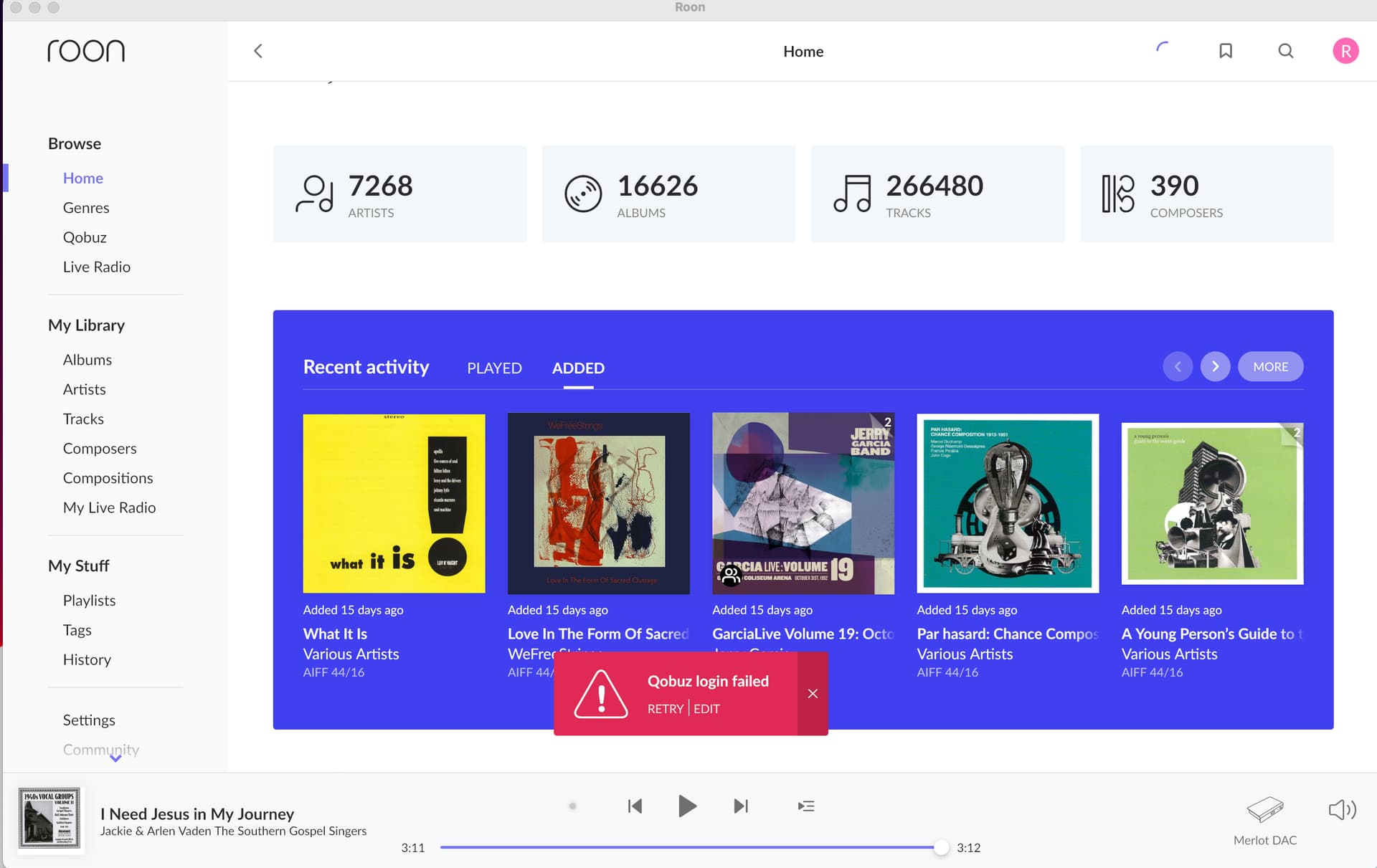

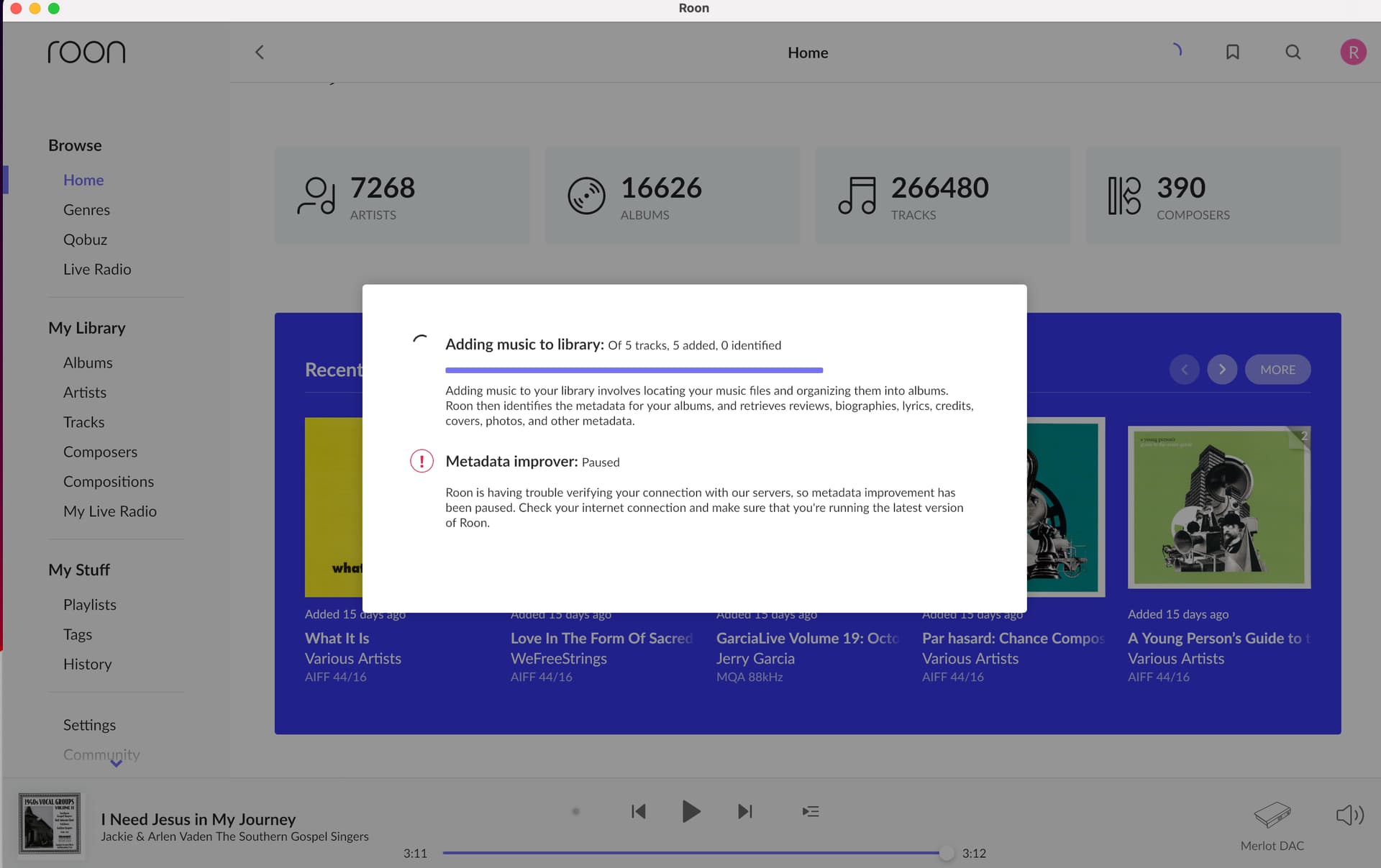

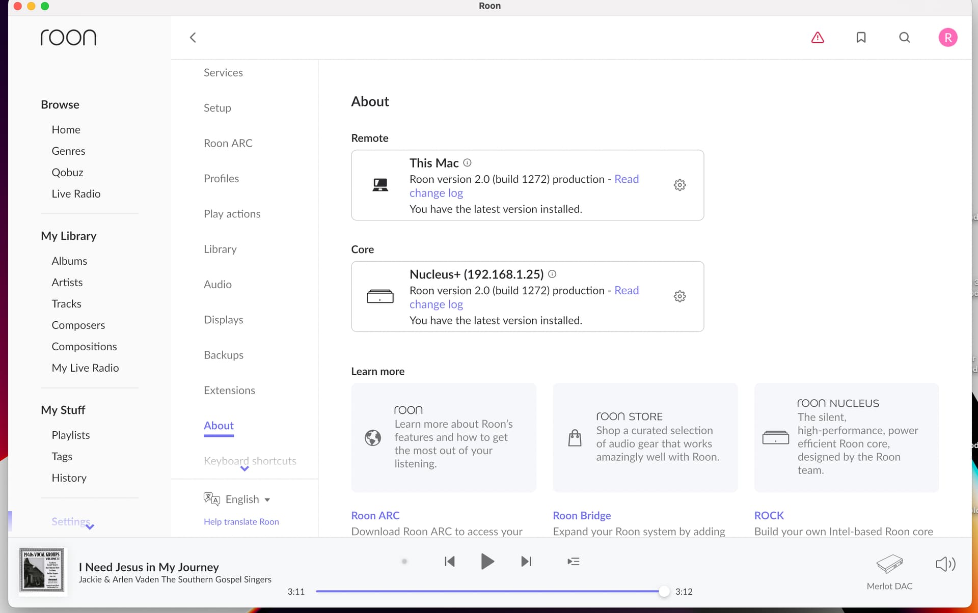

After updating to version 1272 on May 10 (?) Nucleus/Roon failed to connect to Qobuz account. Tried rebooting Nucleus+ and all the usual troubleshooting* including attempting to log out/in of Qobuz in Roon Settings>Services.Then started receiving messages that Roon core was failing to connect to my network and not responding to reboot attempts.
*My usual troubleshooting steps: quitting & re-opening Roon on my device, rebooting Nucleus+, rebooting cable modem & wifi, re-logging into Qobuz, checking physical connections, making sure NAS online, Qobuz accessible.

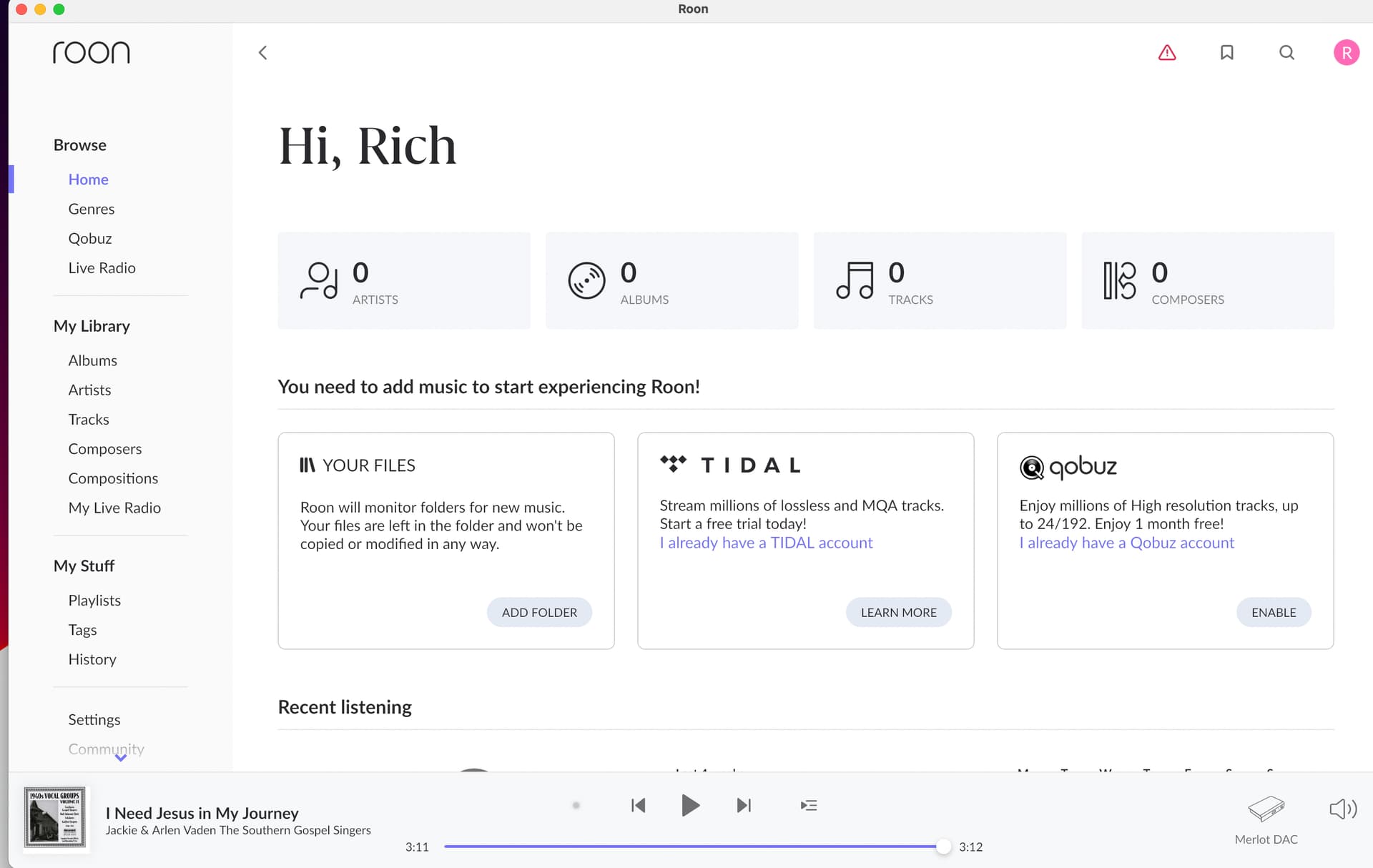

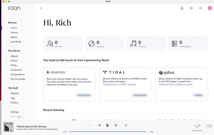

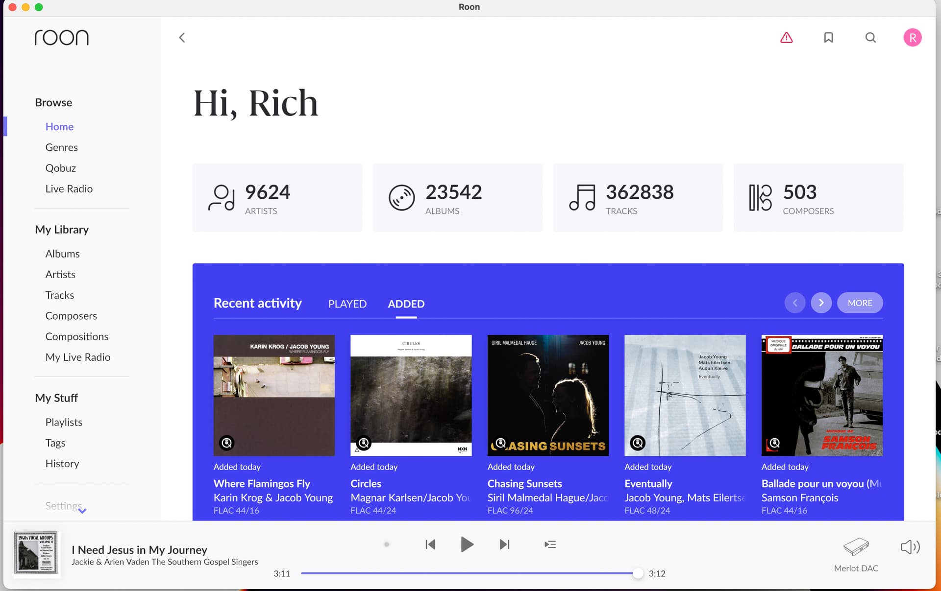

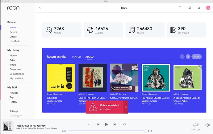

After several reboot attempts over a couple of days I did finally get Roon core recognized on network and logged back in to Qobuz on May 13 and it seemed to have recognized and re-processing my music tracks but Metadata improver was paused. (See Screen Shots 1-3)
But again yesterday was getting network connection failure error messages. Rebooted again and let run overnight.
Here’s what happened this morning:

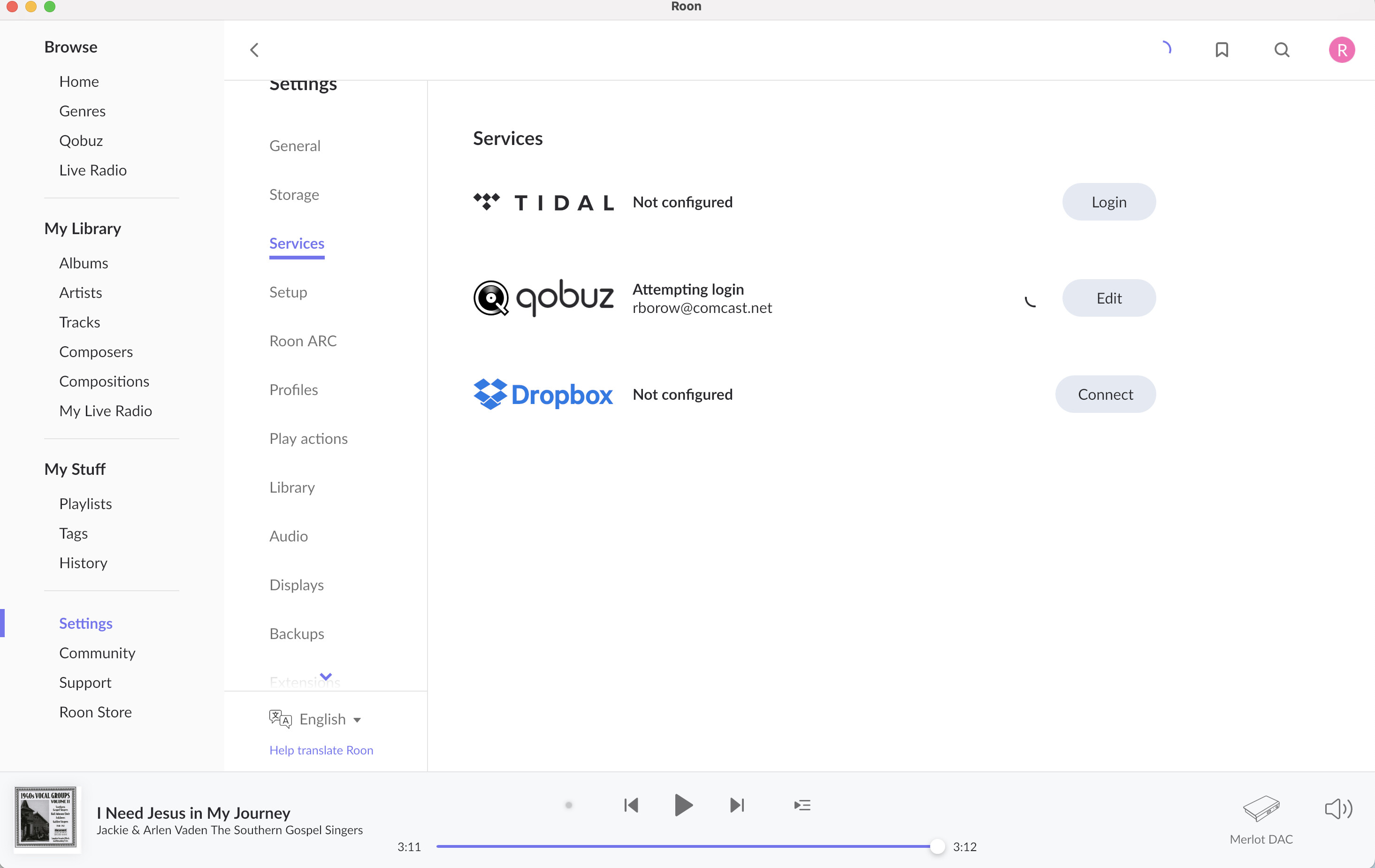

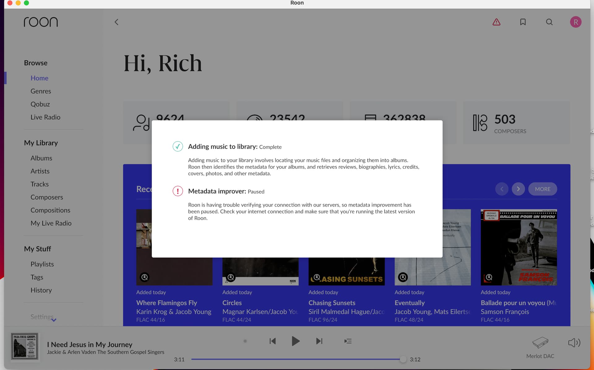

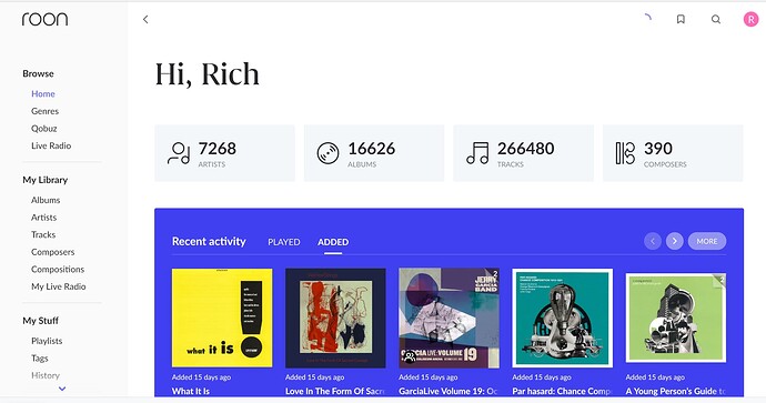

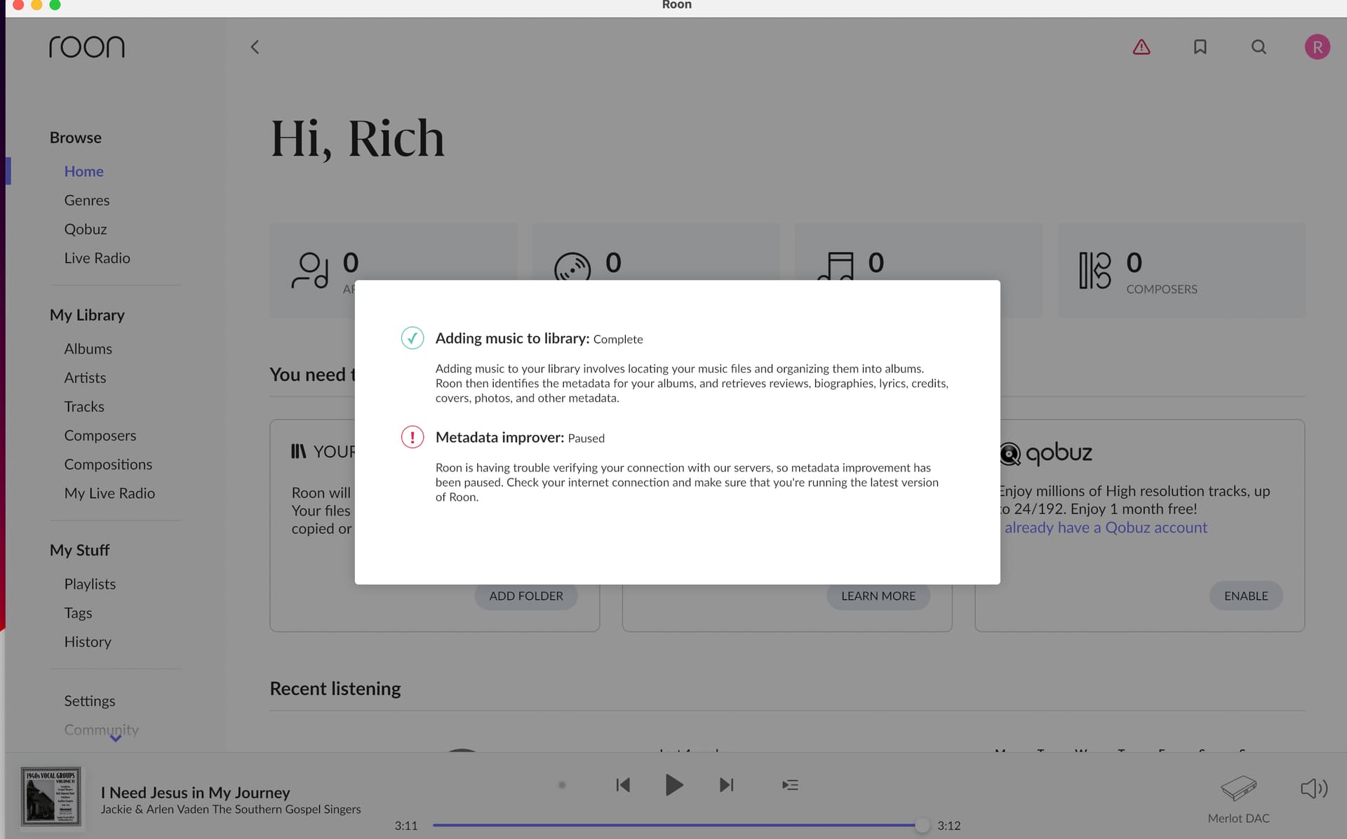

Seemed to have reconnected to local network and processing NAS track files but Metadata improver still paused. (Screenshots 4, 5)

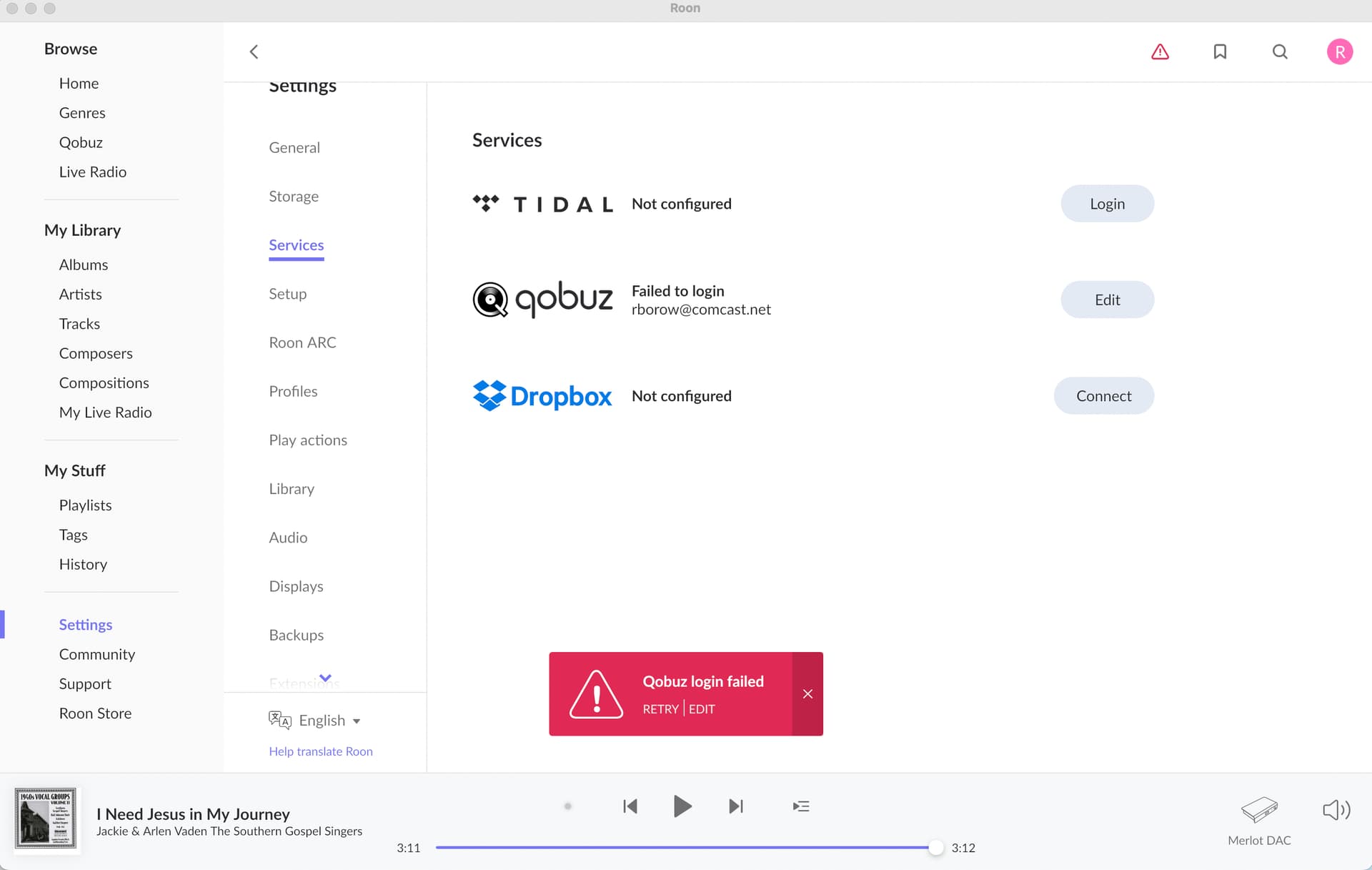

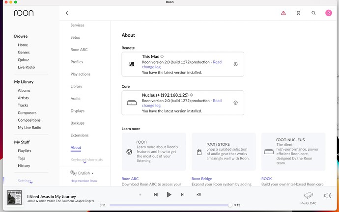

Still was unable to log in to my Qobuz account (Screenshots 6-8)
Then while I was typing this appears connection was lost and I’m again back to 0 music files. There were no internet or local network interruptions and confirmed my NAS is online. (Screenshots 9, 10)
I’m guessing somehow related to the update as there were no changes to my set-up and as far as I can tell there have been no internet service issues, no local network wifi issues, no NAS connection issues (confirmed NAS folders are found), no Qobuz account issues (able to access and play tracks Qobuz online and via apps).
