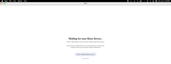

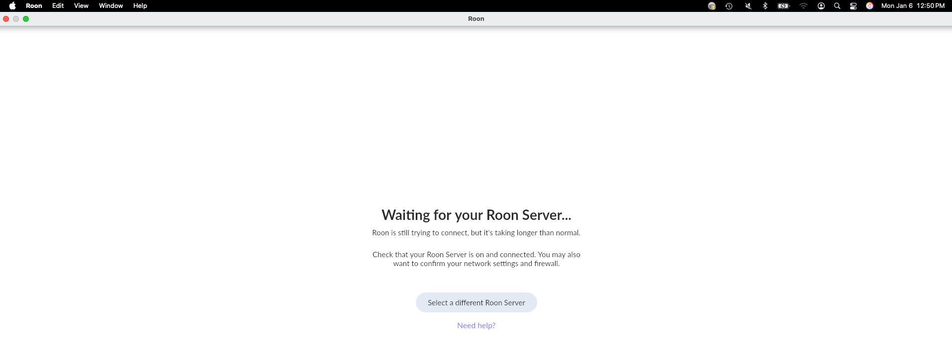

Is Roon Server running?
· "Waiting for your Roon Server"
What happens if you press the "Select a different Roon Server" button?
· I don't see Roon Server.
Please try to restart your Roon Server by closing the Roon app in the taskbar or rebooting your Roon Server machine.

I moved my Roon Nucleus from one room to another, it was working fine and now when I reconnected it, it cannot open up. If I chose select another Roon server it gives me that warning that I would lose all of my music and settings. I do not see how to confirm if the nucleus is on the same IP address but its plugged into the same Ethernet Switch. I did turn off my VPN. I’ve un installed and reinstalled. I am on a MacBook Air MacOS Sequoia 15.2 HELP Please I miss my Roon! : )

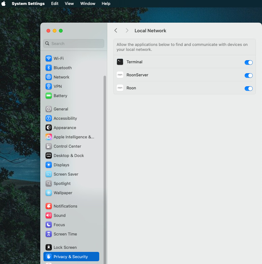

There are known issues with Sequoia, which may (or may not!) apply in the case of the move you have made.
At the very least it is worth while navigating to macOS System Settings > Privacy & Security > Local Network, and making sure that Roon is allowed. If it is already enabled, toggle it off and on again. Then reboot your Mac, and see if the same issue persists.

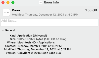

I don’t think you say which version of Roon you are on: is it the latest?

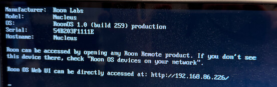

If your Nucleus is not listed as an option, I recommend connecting a HDMI screen to the Nucleus and report back here what’s displaying.

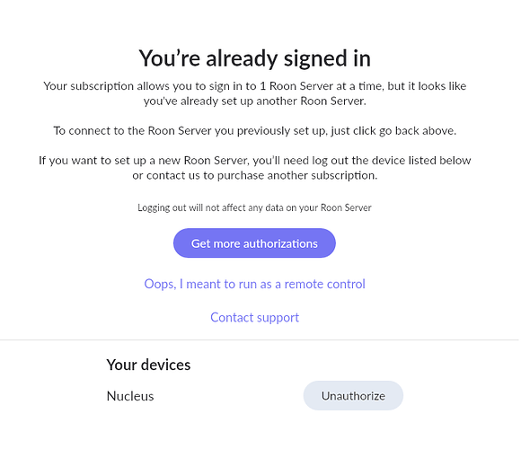

Ok so I did that and it looks like some progress however it says Im already Logged in … Should I respond with “go Back” or “oops I meant to run as a remote control"
Carl you on the right track thank you. So you are suggesting clicking UnAuthorize: Which sounds counter intuitive to me, but I can give it a try. Daniel from Roon: do you concur?
Yes …

Sometimes Roon licensing server gets confused and thinks the current Roon Server is an additional different installation.
Just press the unauthorise icon, it’s quite safe, and then login as normal.
Ok Carl your the Man. It was a bit scary as it looked like all my playlist and music was gone, but is slowly coming back into the Platform. @daniel note to Roon: these command prompts make no sense to that avg Joe Like Me1

Well as it turns out I am not connected to my Nucleus as far as I can tell. It looks like i configured my Mac Air to be the Server for Roon. Still cannot connect to the Nucleus which is showing an IP address of 192.168.86.226 and my Mac is on 192.168.86.22 So I am really in the weeds now.
I connected a Monitor to the Nucleus and it shows the same IP address

Those Setting have always been Set to Enabled. But I do thank you,.
