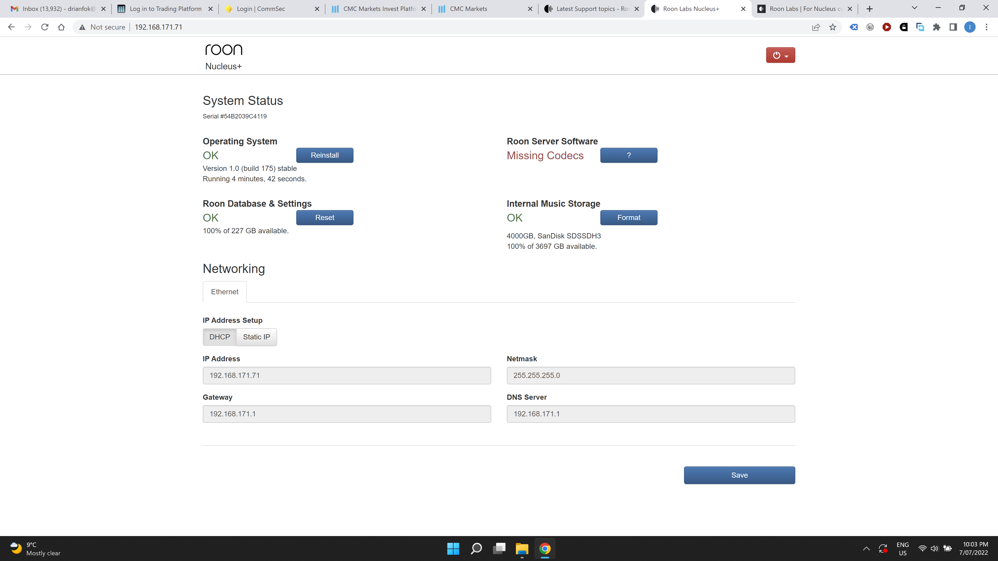

Just got a roon nucleus plus and having a problem. it says under the roon server software mising codecs. unable to install. not sure what to do here. how do i get the roon software to work on the nucleus?. tried going onto the roon software on the ipad. it sees the nucleus can look at configuratio of it but does not allow me to connect to it as a source. pls help thanks
Try following the guide to install the missing codecs:
yes i saw that - i just can’t get to the data\codecs\ folder
tried
didnt work
ie in file explorer \192.168.171.xx\ and the folder didnt come up . it just says
Your file couldn’t be accessed
It may have been moved, edited or deleted.
also pressing the reinstall os multiple times does not actually update roon to the latest version as well still stuck on version 1.0 build 175…

yup i did - clicked reinstall multiple times but no joy - still stuck with the same version not getting anywhere. this is the screen i have .
Roon server isn’t even running

Bought as new. When i first ligged in it looked good. Said it needed an update so i clicked yes. When it finished updating i get the problem in the screenshot and cant see it in the roon app anymore to connect to
Seems like somethings failed on it then as it should be there. I would RMA it to your dealer.
Am hoping i can get it worted out without an rma:pensive: looks like a software issue not hardware. Should be able to sort out???

We are seeing one Nucleus registered to your account, but it looks like even your other (working) Nucleus is getting some kind of network error.
Are there any more details you can provide regarding the network? What model/manufacturer networking gear do you have? Can you try to perform an OS reinstall on a different network? Your Roon OS (build 175) is quite old.
You would need to use two \
to connect via file explorer, for example:
\\192.168.171.71\
