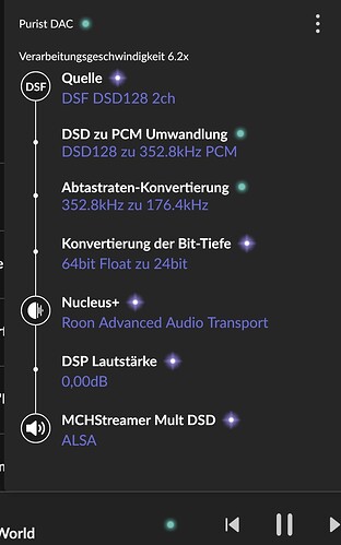

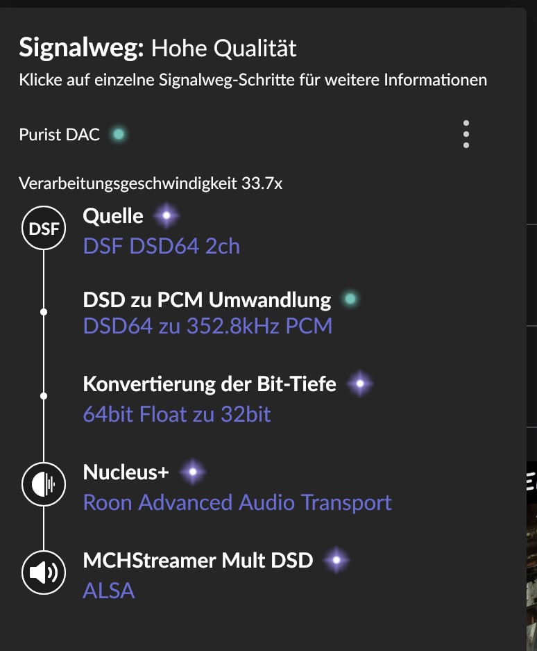

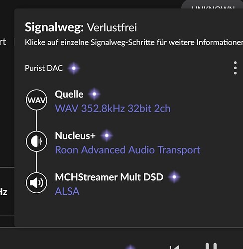

In the meantime, can you please share a screenshot of your Signal path when you experience playback issues?

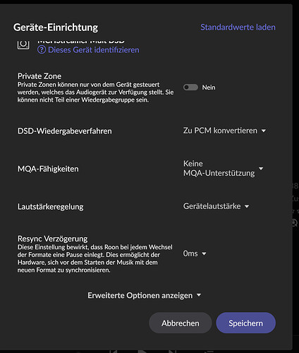

It may be good to review your device audio settings as well during this time - head to the volume icon > cogwheel > device setup > show advanced.
Thank you! :raised_hands:
Thanks Benjamin.
Advanced settings cannot be activated!

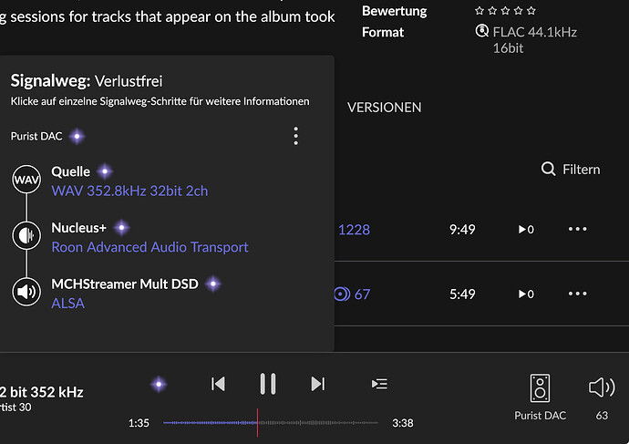

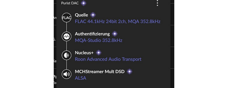

No, that didn’t work at all. Nucleus plays all highres PCM 24 Bit formats incl. mqa without any distortion, see:

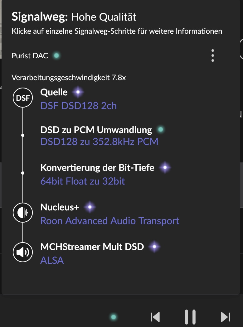

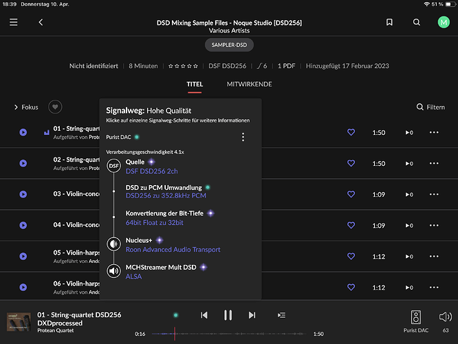

But DSD, DSF or 32 Bit tracks show heavy distortions:

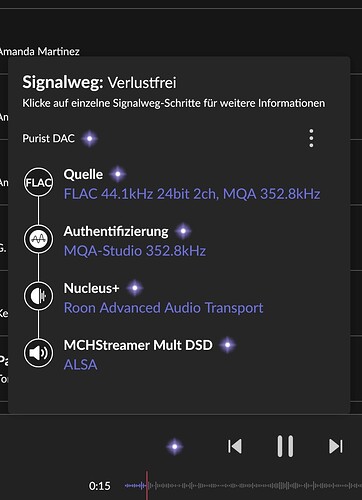

I didn’t see the model number of your MiniDSP. And in this pic…
Roon is not sending a 352.8 file, it is sending a 44.1 MQA file which has NOT been decoded. The Authenticating line is just Roon saying, “yes, this is a valid MQA file” it is not decoding it.

My apologies if this has already been glazed over - have you set up sample rate conversion in MUSE that could downsample any tracks for you, if the DAC isn’t playing the higher-res content natively?
Here’s more info:
Many thanks, Benjamin.
In shall activate MUSE to see (hear) if things will get playable. I am sure your technical experts will find a solution for this Linux issue.
