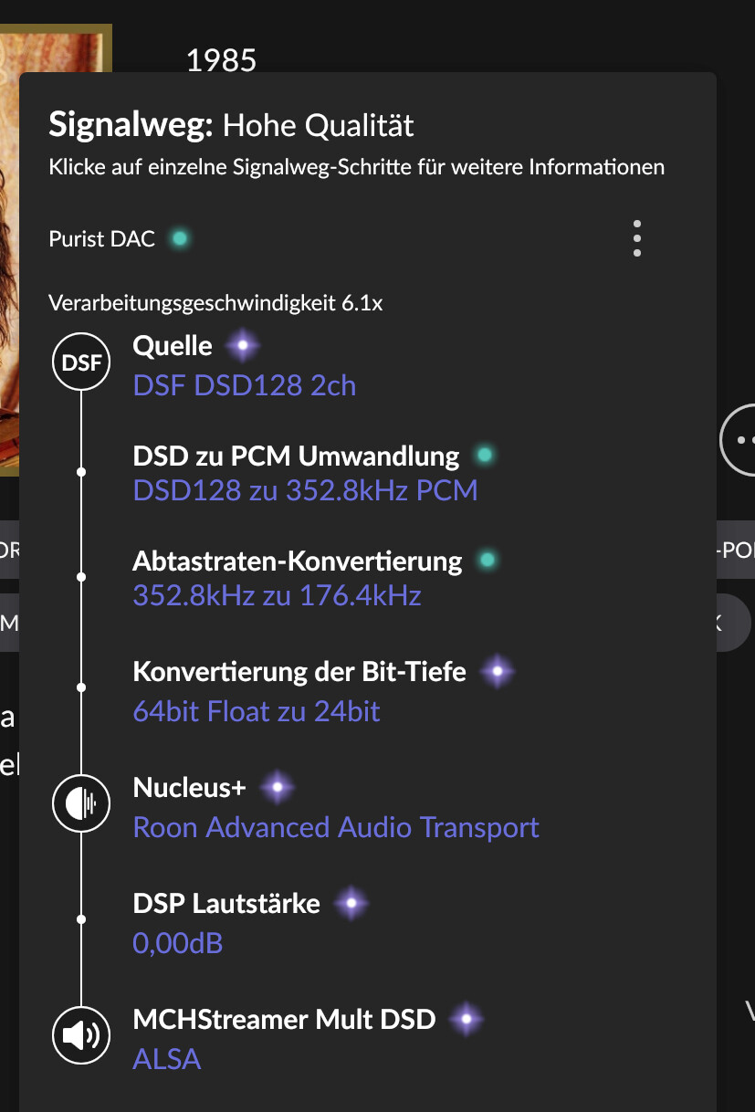

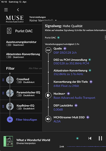

In the meantime I have deactivated the DAC and activated it again. Having set „Downsampling“ in MUSE Roon Nucleus is playing as intended.
I then have deactivated MUSE and have reduced bit depth 32 to 25 and sampling rate 384 to 192 in the advanced settings for the miniDSP input.
Now the distortions are gone. Obviously the miniDSP input is more powerful in the Windows world (ASIO) than in the Linux world!?

What’s at stake here is the actual ability of the last item in your audio chain to accept and decode the native DSD or DoP sent from Roon. You say you hear digital artifacts that aren’t there when you downsample. This occurs whilst streaming DoP-128 to the endpoint
The Linux ALSA announcement for this MCHStreamer card reports the accepted DSD max sample rate as 1024. This is well above the stated specs for the device.

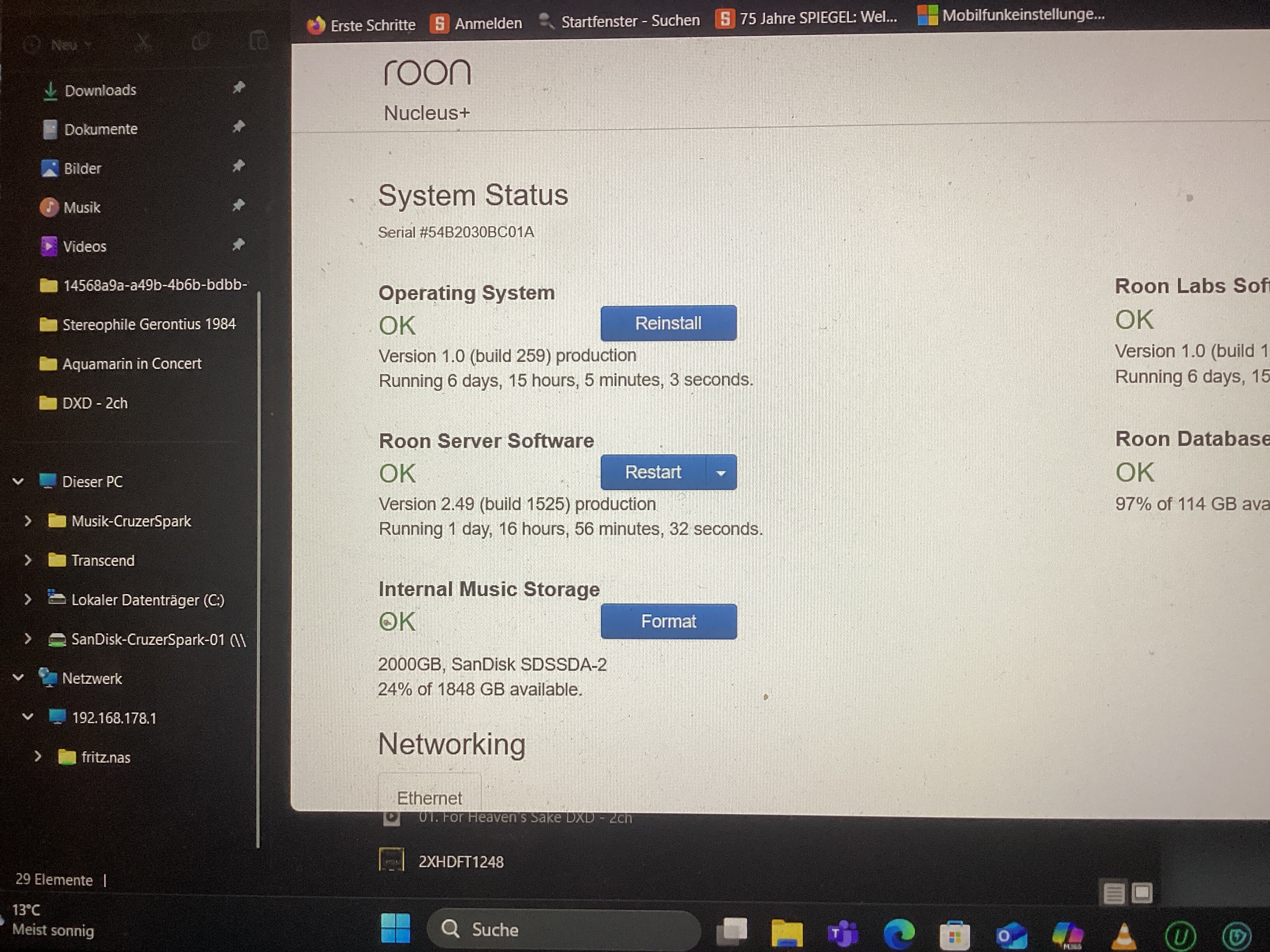

I just updated Roon ( version 2.49 build 1525 ) and now the problems described are gone. No manual configuration for downsampling necessary now when playing DSD and DXD.
However: now my Roon Nucleus plus doesn’t show up anymore in the Explorer under Win11. My old Win 7 still allows exchange of music files in the same network. Most strange.

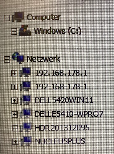

The Win 11 device connected via a switch to the same router shows:
Earlier versions of Winn 11 on this device had no problems showing the Nucleus.
The hint I found configuring and activating SMB1.0/CFIS support didn’t help.

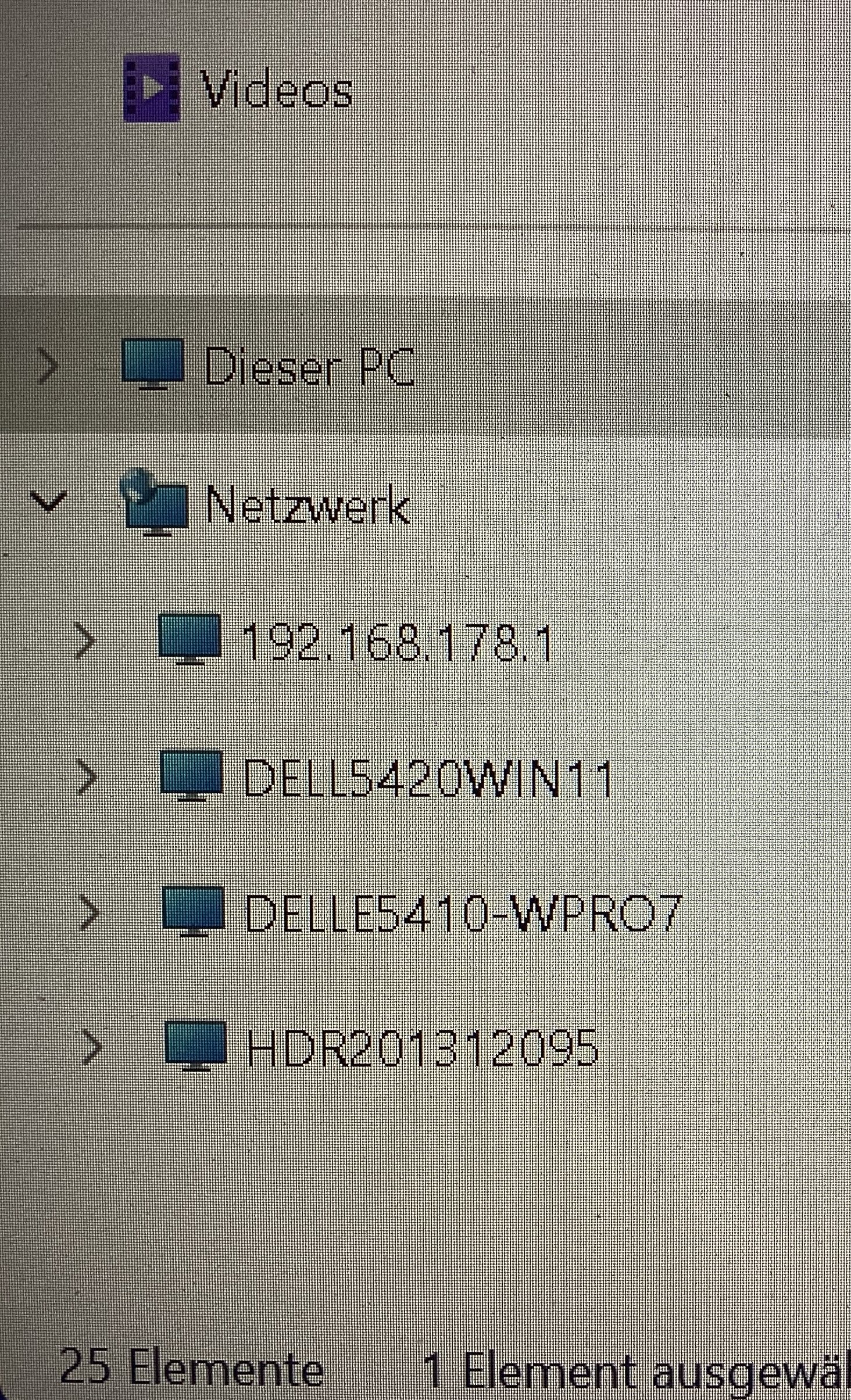

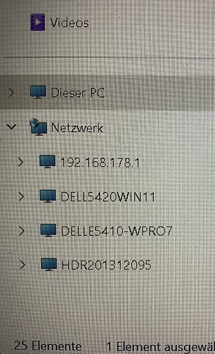

My Win 11 PC is now directly connected to the FritzBox router as is the Nucleus plus. I can go the the Nucleus via my browser, but again: no show up of the Nucleus Plus in the explorer, see:

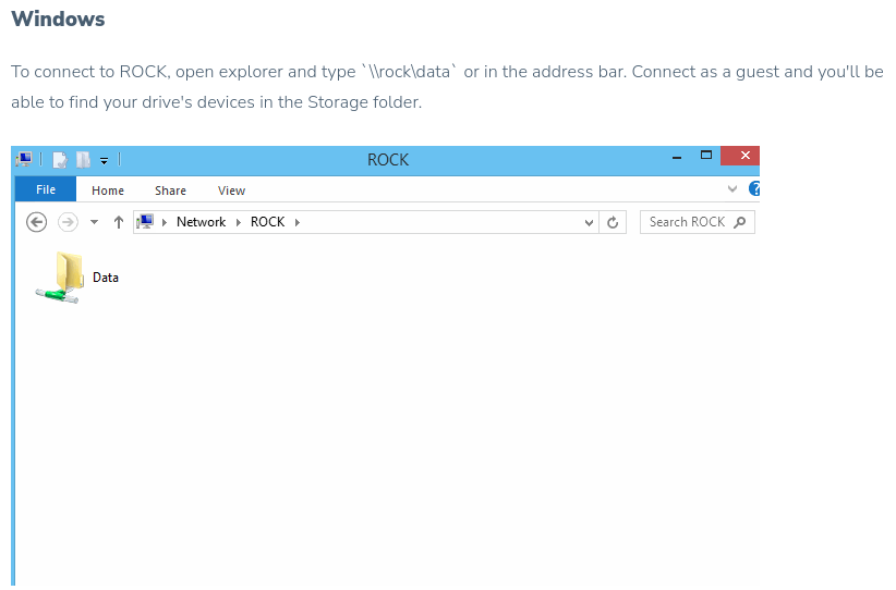

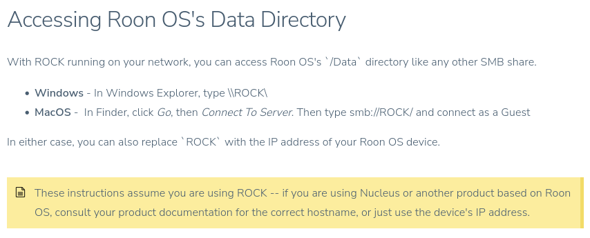

Roon OS will not show up in Network on Windows because it’s lacking the needed proper service announcement (so far) to accomplish that. Roon Labs also (and consequently) does not instruct users to look into Networks for Roon OS devices – use the address bar instead to connect:
You can follow the discussion regarding Roon OS file shares and current Windows here:

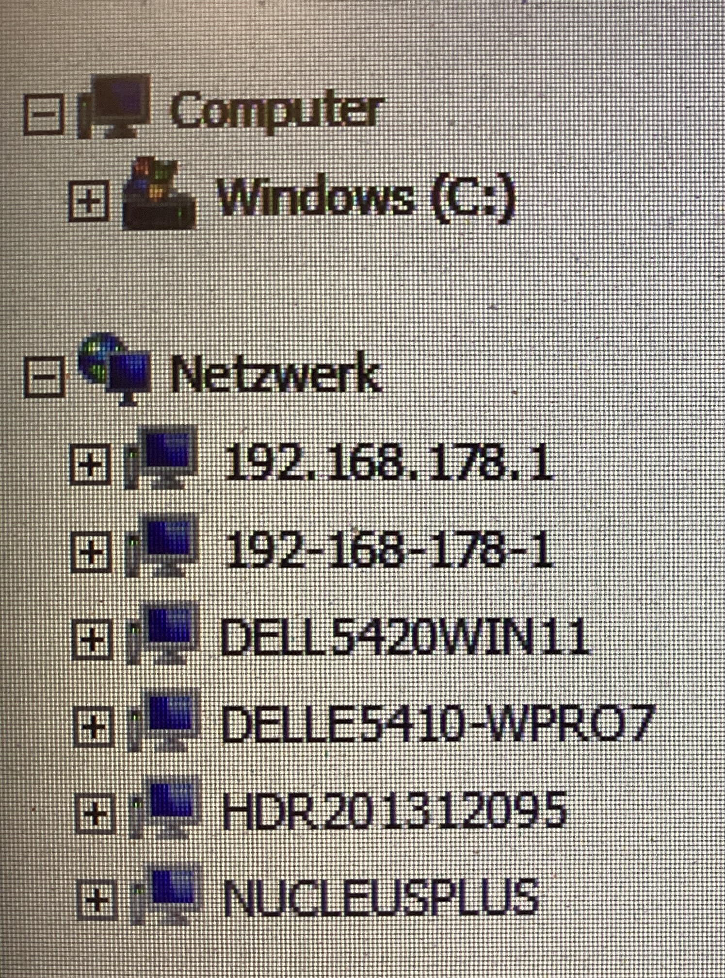

On my Win7 PC the Nucleus Plus shows up in the explorer!
And as mentioned earlier changing the SMB settings didn’t help at all!
Does it not work if you type in the correct path into the address bar?
Indeed, this works. And I can access all folders.
