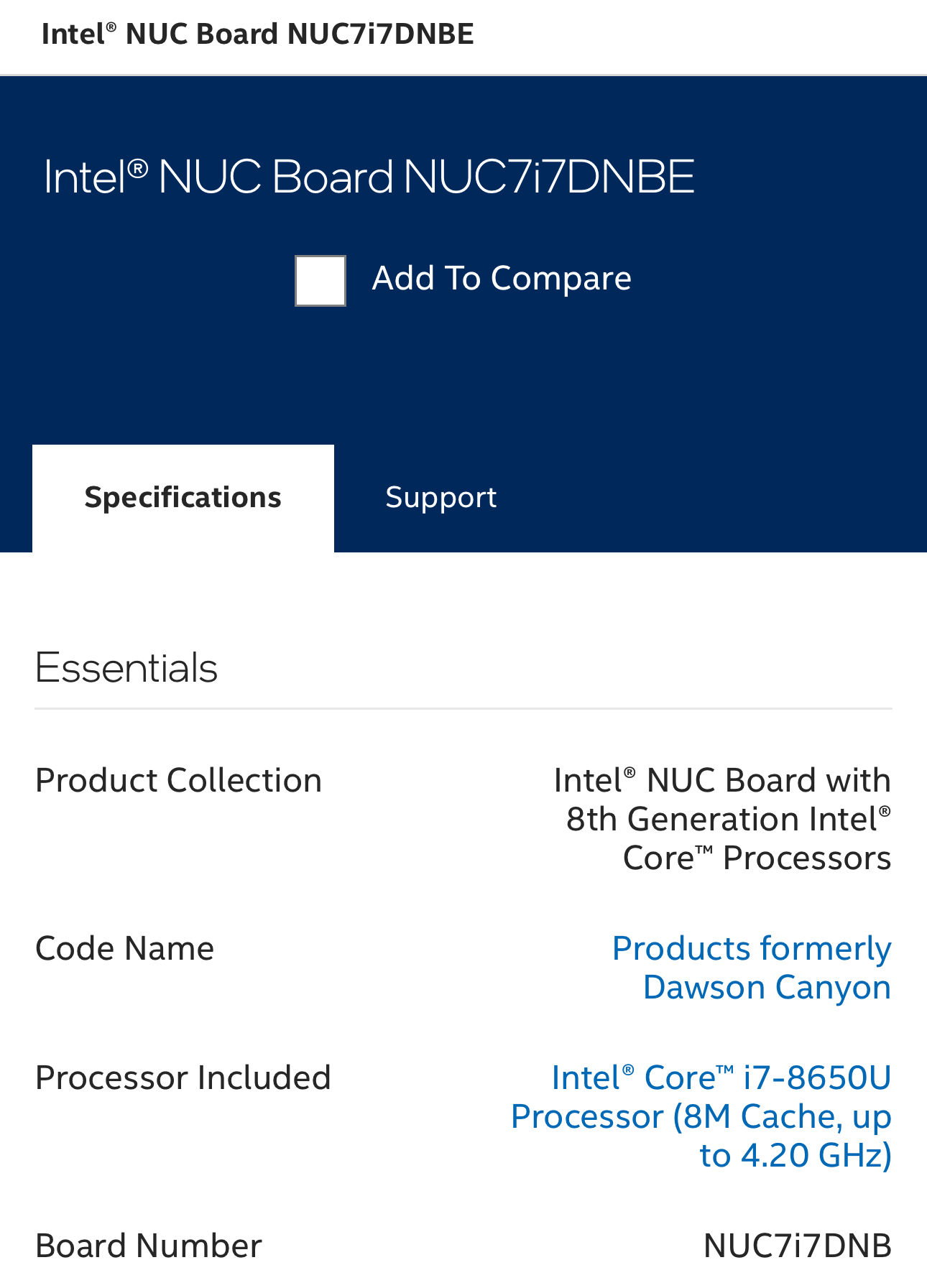

No, the 8559U is the NUC8i7BEx processor. Nucleus Plus is based on NUC7i7BNx, hence 7567U if Rev A or is based on NUC7i7DNx, hence 8650U if Rev B.
AJ
Oh ok, thanks. @MARCO_GENTILINI, in which case the difference is small, here for the rev B.

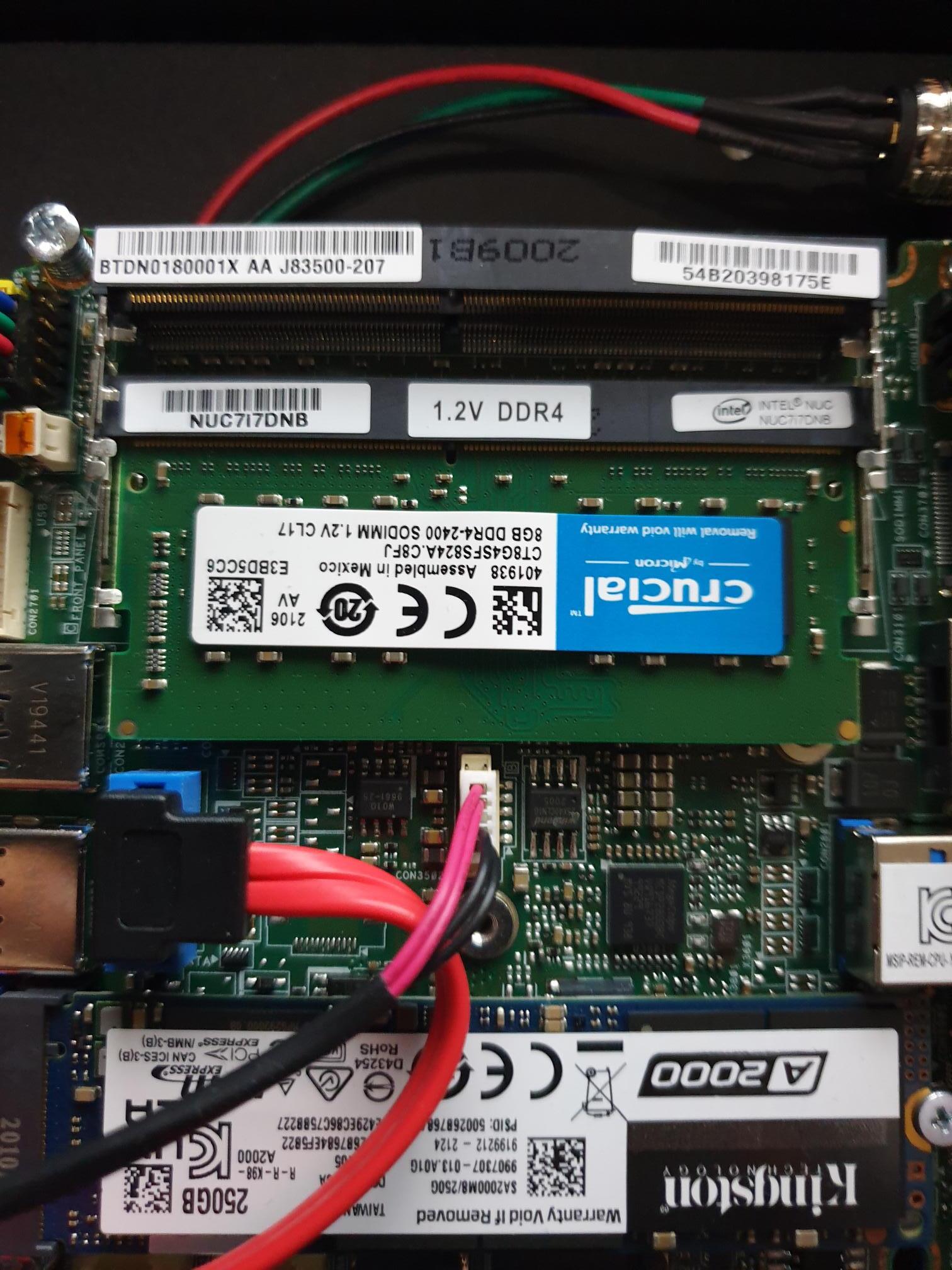

But I photographed the inside of a Nucleus Plus Rev. B that doesn’t work and I see that it is a Nuc7i7DNB.
Yes, just as I stated…
