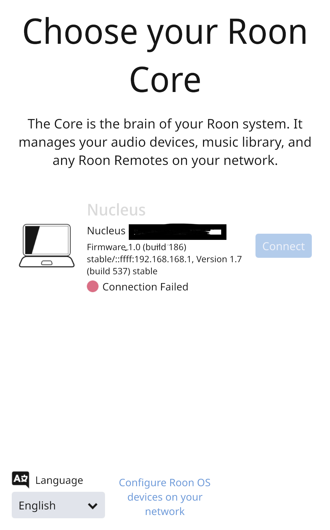

When I attempt to connect to the server from either the mobile app or my desktop client it attempts to connect to .1 (router address). I’m very technically savvy and have been looking at the Roon server logs.

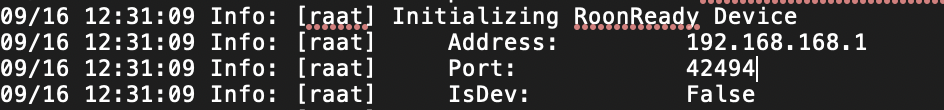

It appears as though the Roon server is identifying itself as .1 in the logs.
[Brokerserver] client connected 192.168.168.1:49794
On start up there is a trace that says [SOOD] adding user IP 192.168.168.1.
I can then see the individual connections to the RAAT server and it’s saying that my client is attempting to connect to 192.168.168.1:49801
The connection says that it’s failed and then retrying and it does a push connection to 35.243.252.57
There are repeated attempts that all fail.

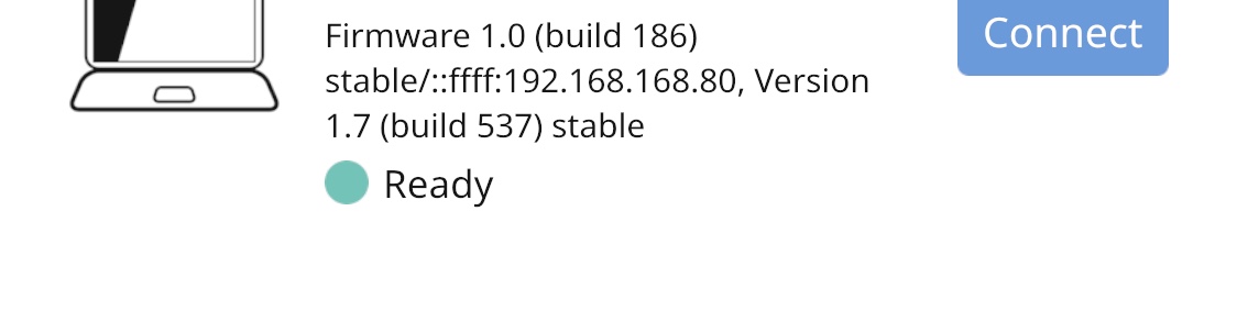

All of these have no luck. When Roon reboots it goes green with the CORRECT IP address and gives me the button to connect for a split second and then fails
I can intermittently connect to the Roon server from my mobile app 1% of the time then nothing.

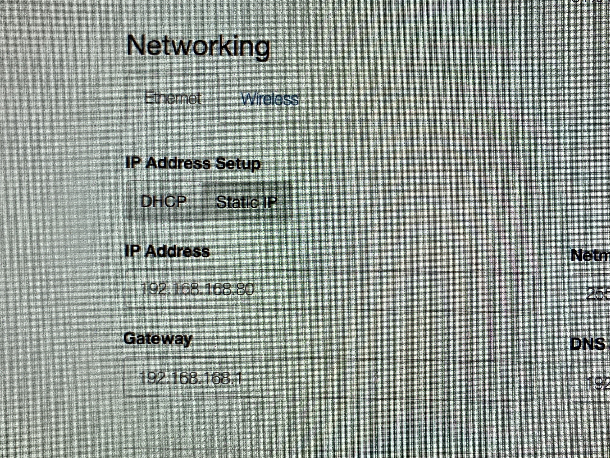

Would you post a screenshot of the Nucleus IP configuration?

My network settings are correct so now look without me touching any IP addresses or the DHCP or DNS server it connects just fine. And Roon now sees itself as .80.

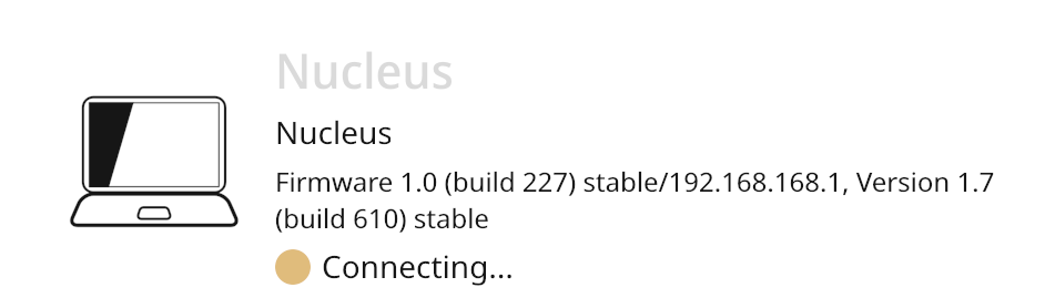

Greetings! This is a follow-up to my previous post here [Roon Nucleus: RAAT server connections trying to connect to router IP not Roon].
Bottom line is that I still cannot reliably connect to my Roon Nucleus.
Roon continues to take the wrong IP address. Please read my previous post to see the extensive debugging I have done including re-installation of Roon, Reinstallation of the OS, etc. I have both a static IP AND I have DHCP set to assign Roon .80 (yes, I’ve switched between the two and also used Wi-Fi).
Bottom line, Roon is serving up connection at .1 instead of .80. I can see this in the logs that Roon is booting up and serving connections as .1.
Moreover, I found on the Roon config files on the DATA drive that Roon has .1 as a config. I deleted those files, kept only the config file with .80 and still no luck.
My hunch is that something on the UNIX OS side has .1 as the IP address and isn’t releasing things even after an OS reinstallation—a rogue config file or something.

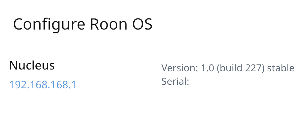

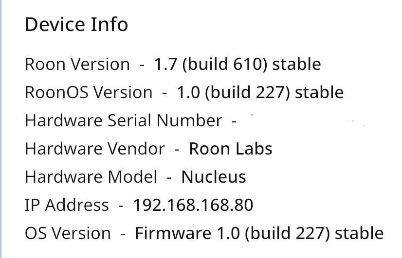

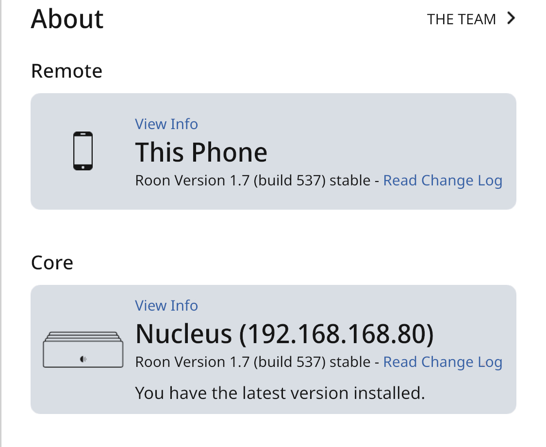

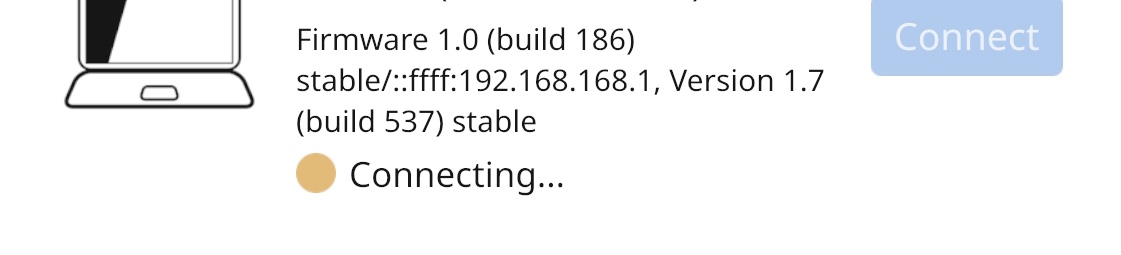

Here’s the dual personality nature in pics. I have had the Nucleus for quite a while and purchased it new.
Is there a KB to get under the hood onto the actual OS and reset the IP?
I can get to the Nucleus’ web OS no problem at .80.
