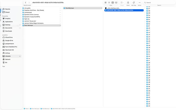

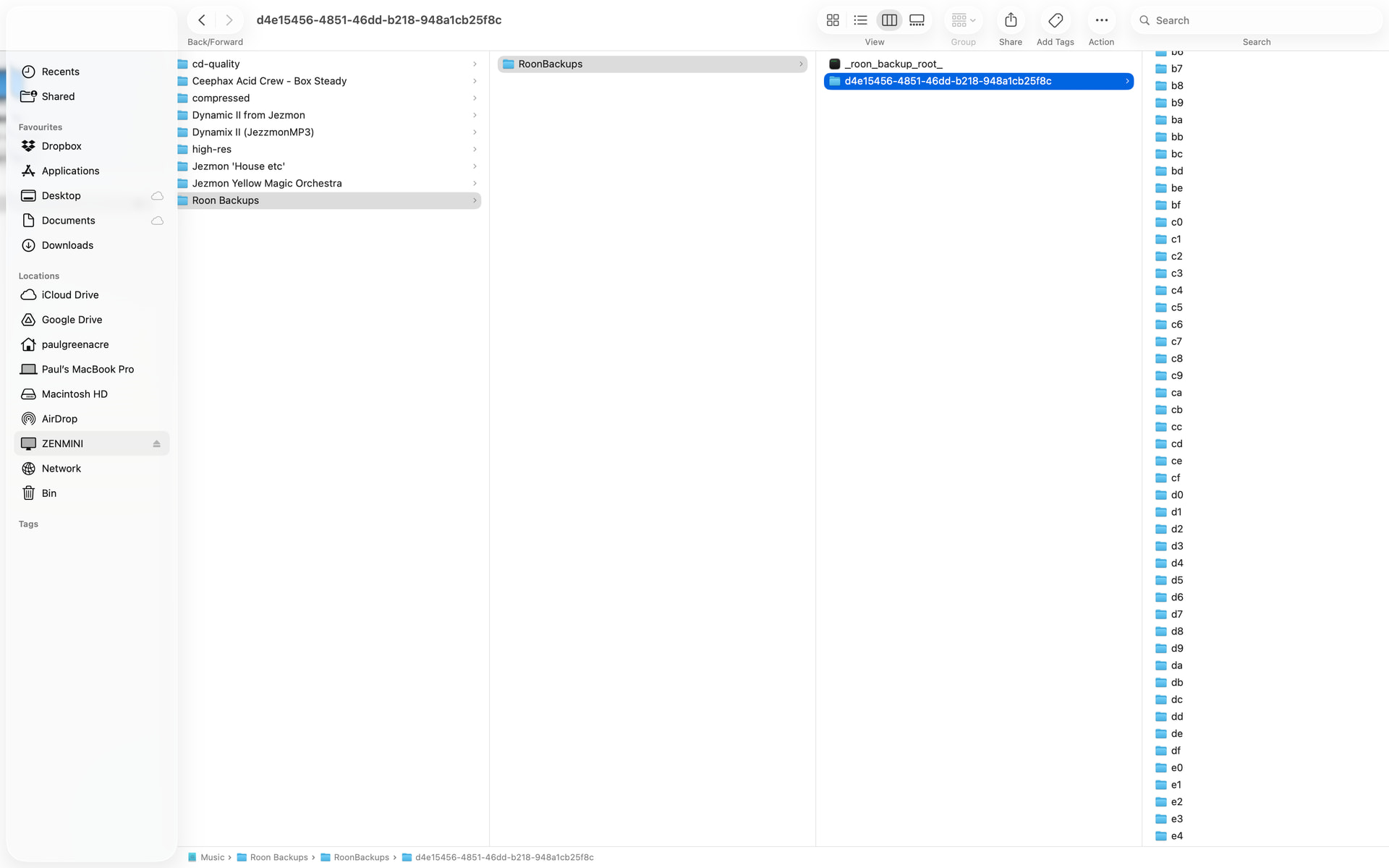

Hello again. My backup repository on the Innuos Zen Mini seems to be intact and contains multiple backups (see screenshot in the thread).
However, I can’t reach a Restore Backup option, because every attempt to connect to the Nucleus results in the remote hanging indefinitely on the pulsating Roon logo.
Is there a recommended recovery procedure from this state?
