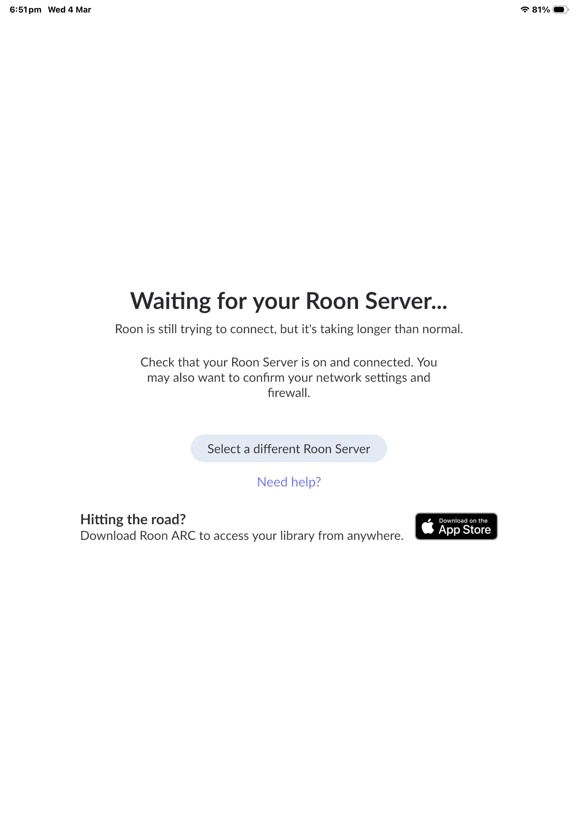

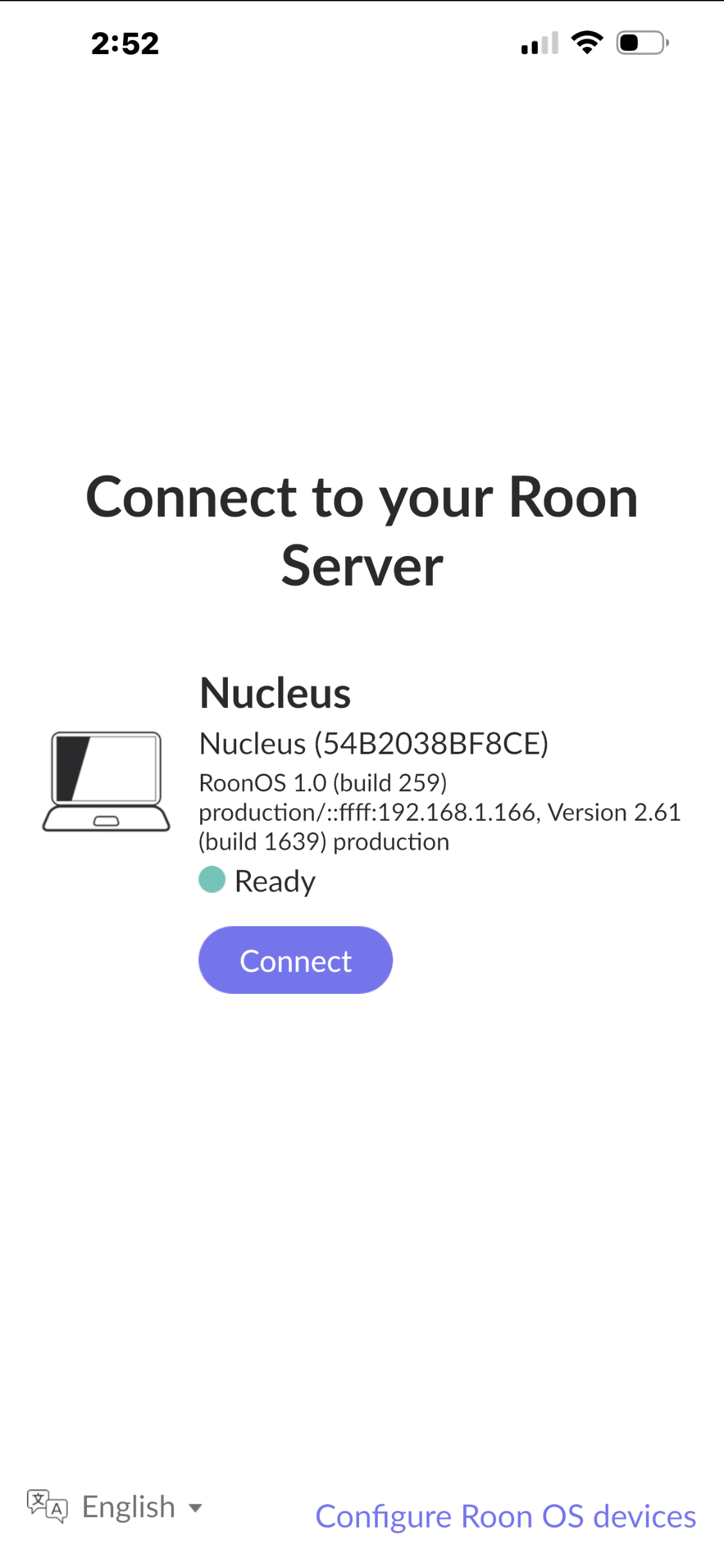

· After the latest installing of Roon updates, first Roon couldn’t recognize my iPhone and iPad as devices connected thru my Roon Nucleus Rev B, and now after seeing the connect to your nucleus page, which the nucleus does, the screen goes blank except for the spinning load symbol.
I’ve thoroughly researched the Roon community and tried every fix offered to remedy this problem, but to avail. I pay $15 a month for my Roon subscription and I’ve never encountered this issue before after a software update. I’ve taken screenshots of my Roon app trying to load, and I can also provide a list of my music gear listening chain.

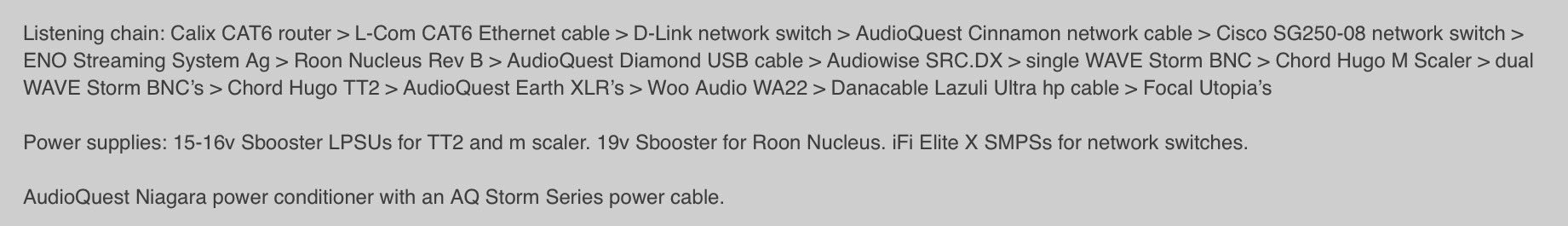

· I use a Calix CAT6 router > L-Com CAT6 Ethernet cable > D-Link network switch > Audioquest Cinnamon network cable > Cisco SG250-08 network switch > ENO streaming system AG > Roon Nucleus Rev B > AQ DIAMOND USB cable > Audiowise SRC•DX > single WAVE Storm BNC > Chord Hugo M Scaler > dual Wave Storm BNC’s > Chord Hugo TT2 Dac > 2 AQ Earth XLR’s > Woo Audio WA22 hp amplifier > Danacable Lazuli hp cable > Focal Utopia headphones.
This is my listening chain and it hasn’t had an issue in 5 years.

Diagnostics from the Nucleus show that the database is logging corruption:
03/03 18:41:32 [Local 03/03 12:41:32] Critical: scx: LevelDb.Exception: Corruption: missing start of fragmented record(2)
 at LevelDb.Database._CheckError(IntPtr err)
 at LevelDb.Database..ctor(String path)
 at Sooloos.Broker.Database..ctor(String dbdir)
 at Sooloos.Broker.State.<>c__DisplayClass154_1.g__Finish|1(Boolean vacuum)
 at Sooloos.Broker.State.<>c__DisplayClass154_0.b__0()
 at Sooloos.SynchronizationContextThread.<>c__DisplayClass45_0.b__0(Object _)
 at Sooloos.SynchronizationContextThread._Dispatch(SendOrPostWrapper& ret)
Roon is encountering unexpected changes to crucial parts of the database on startup. This is likely the cause of the spinning during connection. Database corruption is uncommon but usually results from a physical cause: a failing drive, a power outage, or any repeated disconnection event while data was being written.
Corruption can only be resolved by restoring a Backup of your Roon database that precedes the corrupting event. Do you happen to have scheduled Backups for Roon, or a manual Backup handy? Try selecting “restore a Backup” instead of attempting to connect to the Nucleus.

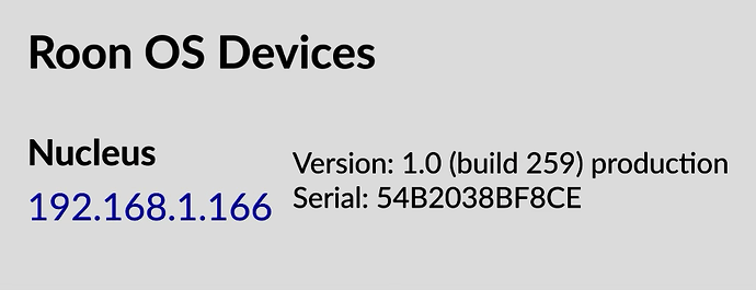

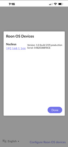

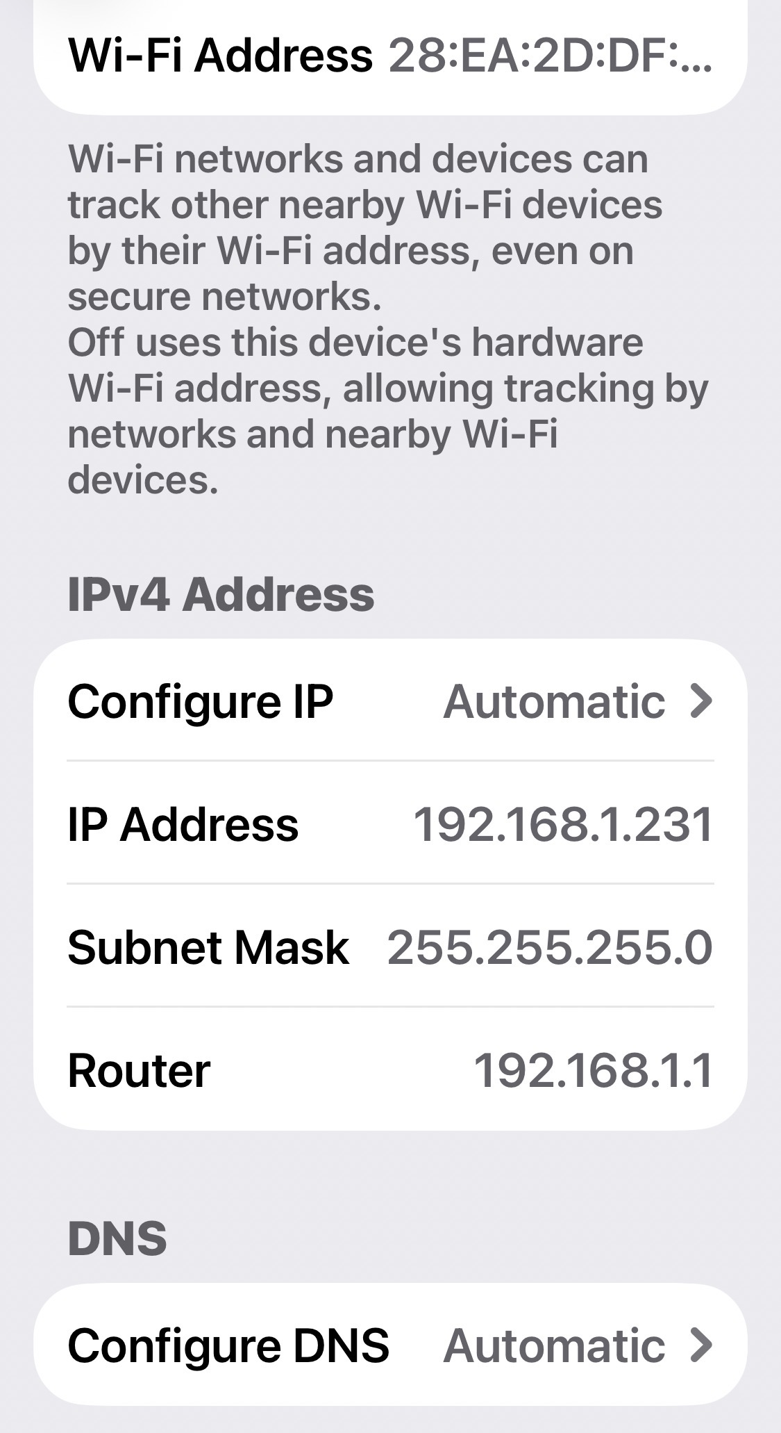

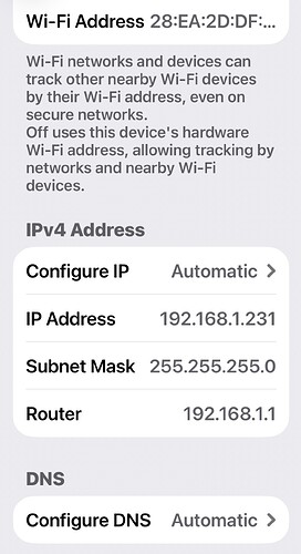

Connor, I tried all of yours and the Roon website suggestions. This is what I’m seeing now. I turned my system off and restarted it. Then I checked the IP address and configuration on my Apple devices. I’m not sure where I need to go now.
· After having tried all of the suggested ways of getting Roon to recognize my Roon Nucleus Rev B, I’m at the point extreme frustration.
· https://share.icloud.com/photos/0c2rJaebs3Fw1H_-g_cWteP6g
https://share.icloud.com/photos/01e9KgdHQYqZprR7UNxuDXVWQ

  1. Our diagnostic servers show that at least some Roon Remotes have registered multiple subnetworks when using Roon. If you haven’t already, please double-check that this network environment is restricted to a single subnetwork/VLAN. Place any second routers in Bridge mode.

Please also share a screenshot of your Nucleus Web Admin page.
