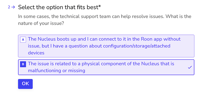

The best next step here is to get in touch with our RMA department directly, as they’re in charge of all hardware-related Nucleus issues. To do so, open the Typeform link below and select ‘Other’ followed by 'This issue is related to a physical component".
Typeform link : Nucleus Troubleshooting
Screenshot for reference:
They’ll help get you sorted out moving forward. Thanks! :+1:

This thread will soon close automatically due to inactivity. However, you can still proceed with the next step here at any time by simply submitting a request to our RMA team per the link @benjamin shared. To reiterate:
Open the Typeform link below and select ‘Other’ followed by 'This issue is related to a physical component".
