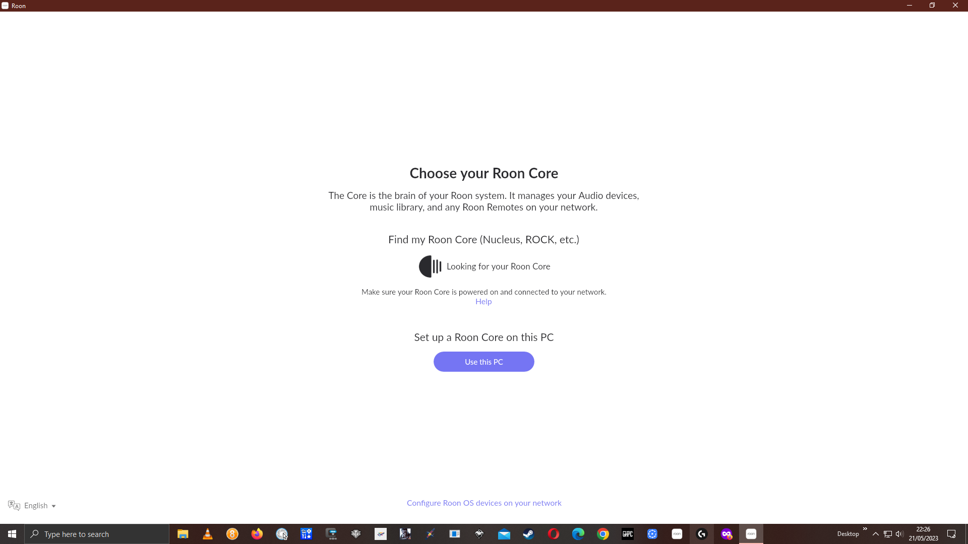

Roon nucleus +
Ethernet from router to nucleus via gs108 switch
T+A pdp3000hv dac
Via usb
Playing music when sound suddenly stopped out of the blue.
Have plugged in and reboot nucleus and get the following
doesn’t find it
The 169.254.x.x address seen on the first screen usually means that your DHCP server, which is part of your router, is unreachable by the Nucleus.
