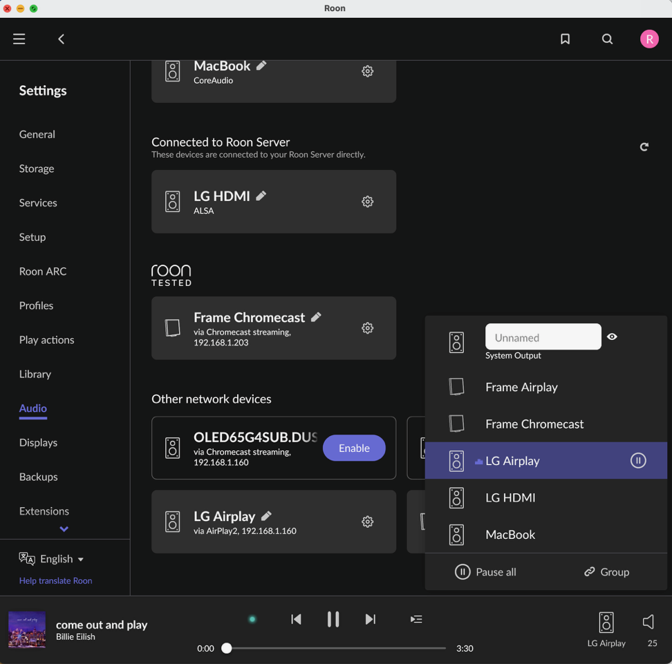

The problem I am have is with a new LG TV OLED65G4. I want to play songs using Airplay. The TV is Airplay capable, I can play to the TV using my Apple Devices. My Roon Nucleus sees the LGTV Airplay, I have enabled it, when I attempt to play a song it shows as playing but the songs time stamp stays at zero. Looking at other threads in the community I have already added the TV to the Home App on my Apple Account.

After pairing, Roon tries to send an RTSP OPTIONS request to the TV—a standard step in the AirPlay protocol to determine capabilities and initialize the stream. At this point, it fails with:
IOException in RTSP request: Unable to read data from the transport connection: Connection timed out.
This results in a NetworkError and stops the process. This is after successful pairing, but before audio streaming begins. The compatibility toggle may very well help you here!
It may also be worth checking to see if the TV’s firmware is up to date.
Compatibility toggle did not help, the TV firmware is up to date. I do not see a way to delete the Roon link to LG Airplay. I have tried disabling and then enabling again but that didn’t work. Is there a way to delete the link and start over?
