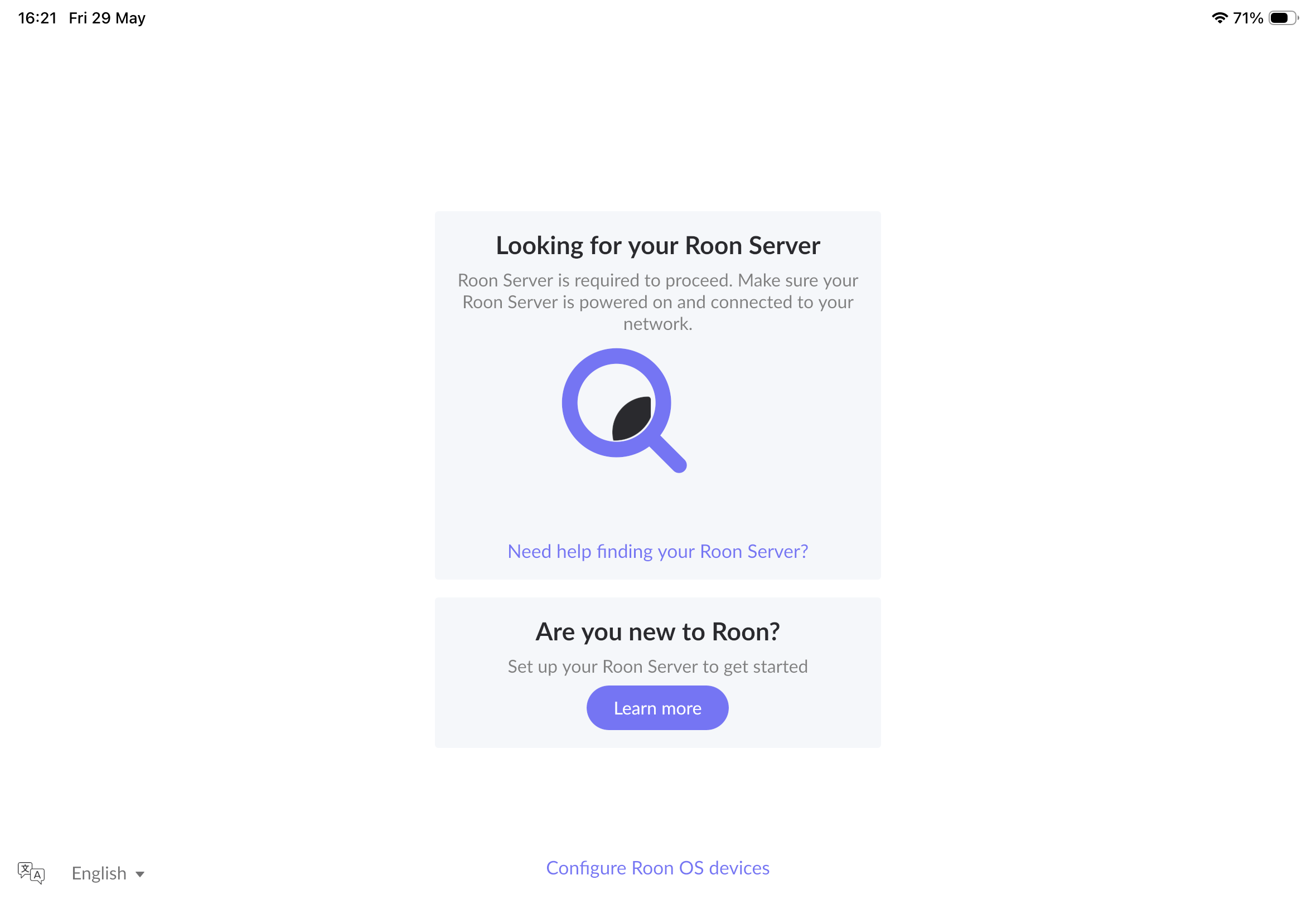

Hey @matthew_randall,

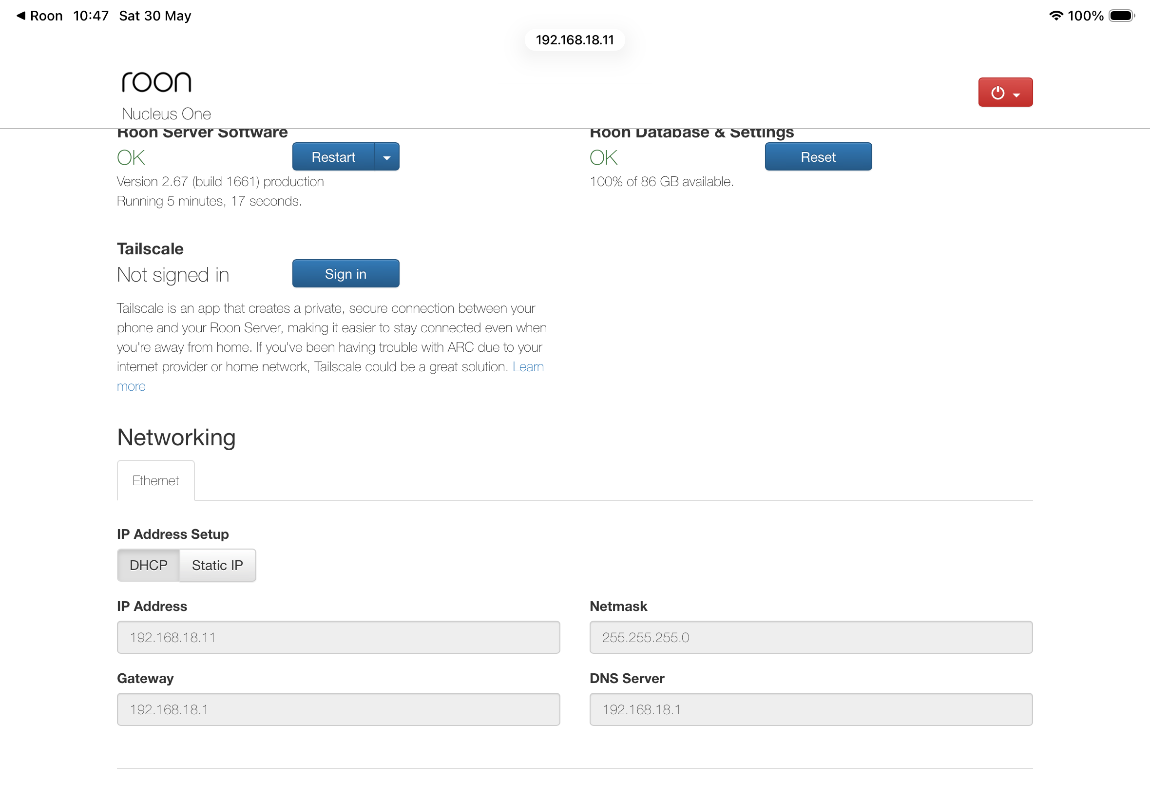

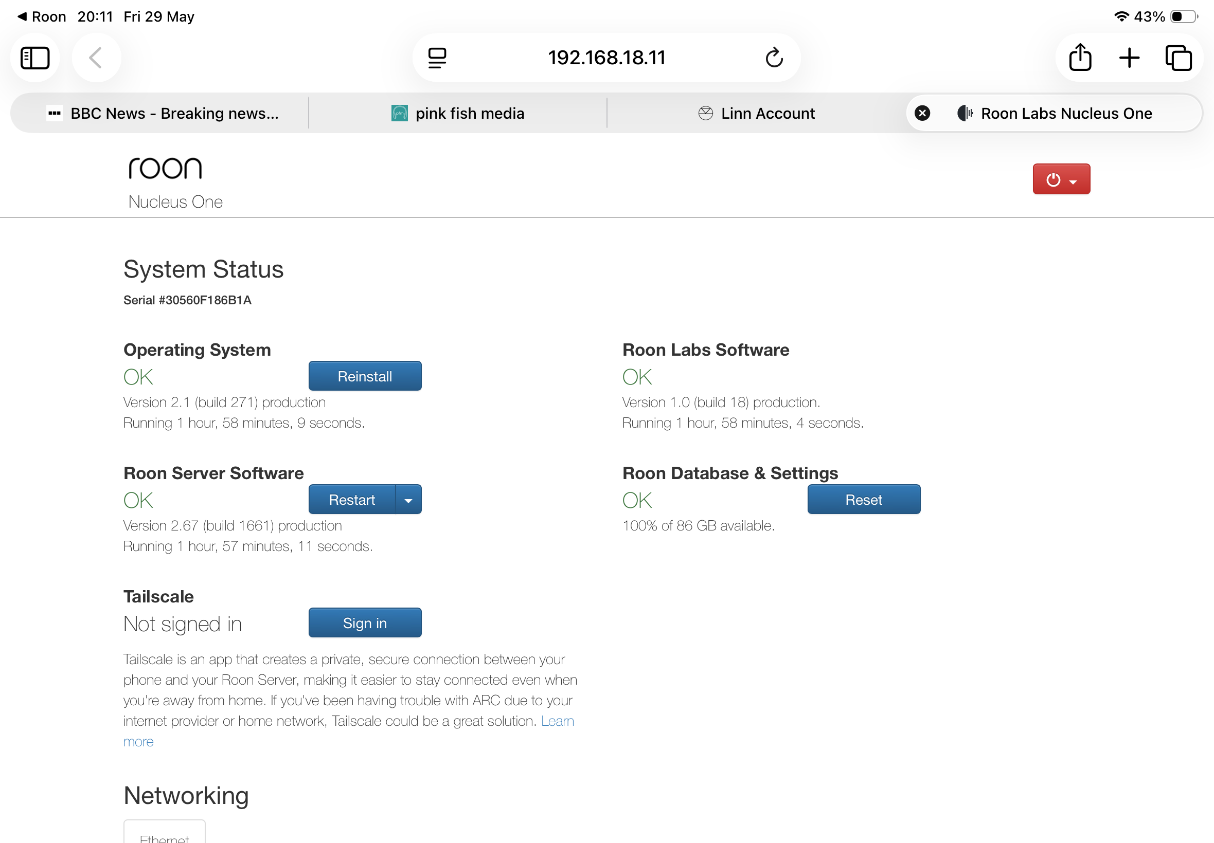

Thanks for the screenshot and welcome to the forum! Are you still able to access the Nucleus Web UI? Is there any change in behavior if you reboot the Nucleus, press the power button once, wait for it to turn off, then press the power button once again? We’d also like to know what your network setup looks like, including the model and manufacturer of your router, switches, and any other networking gear. Let us know the above and we can continue from there, thanks!
Hi, yes I have accessed the UI & restored reinstalled etc each option.
I have rebooted the router,
I have unplugged the power cable from the nucleus, waited a few mins, then re- powered up.
I have also cycled the power off on button.
No success.

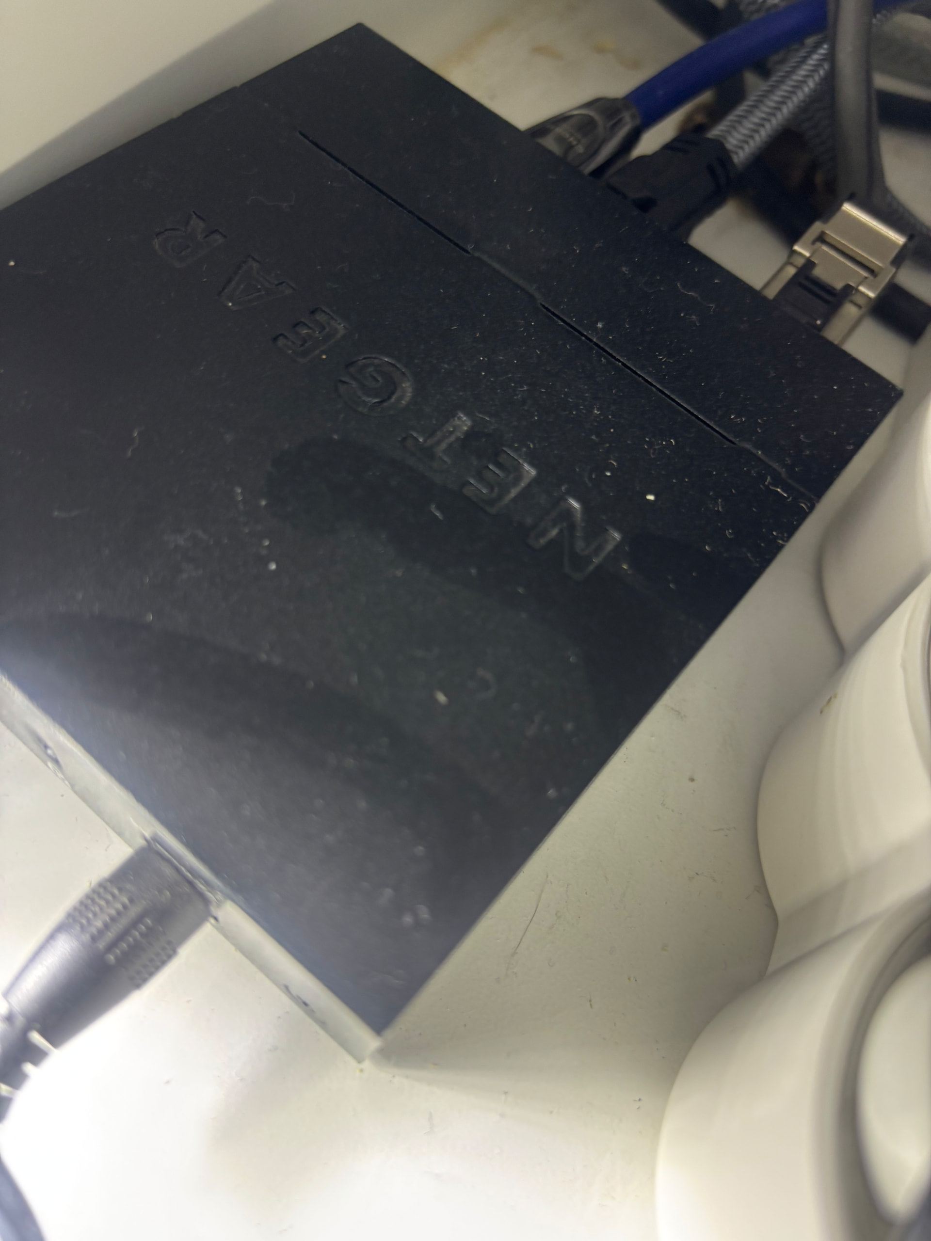

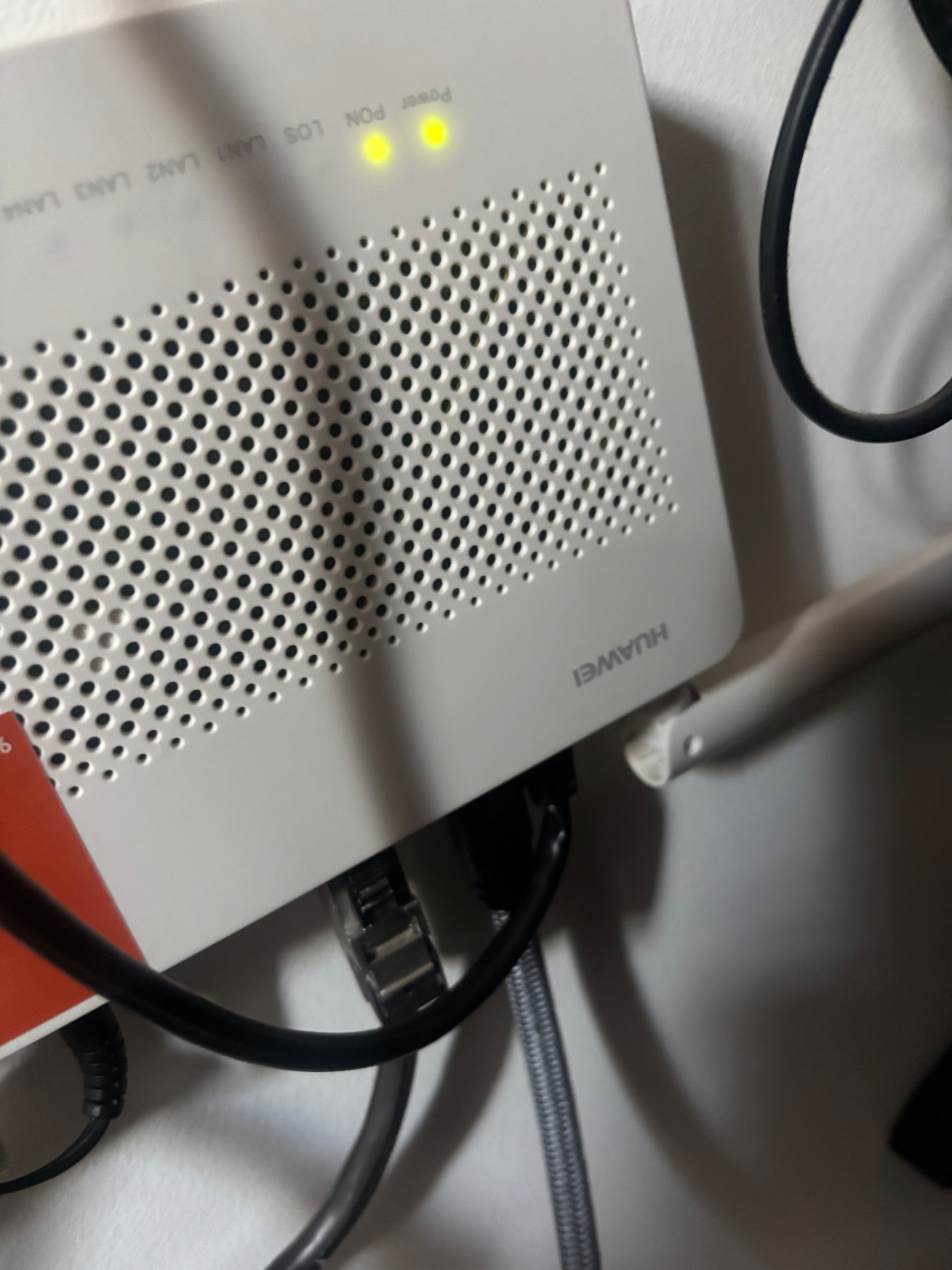

Network routing,
Basic huawei router as supplied by my service provider & a small netgear switch.
Tv connected to the router,
Linn Selekt & the nucleus connected to the netgear switch.
All have been rebooted power cycled etc.

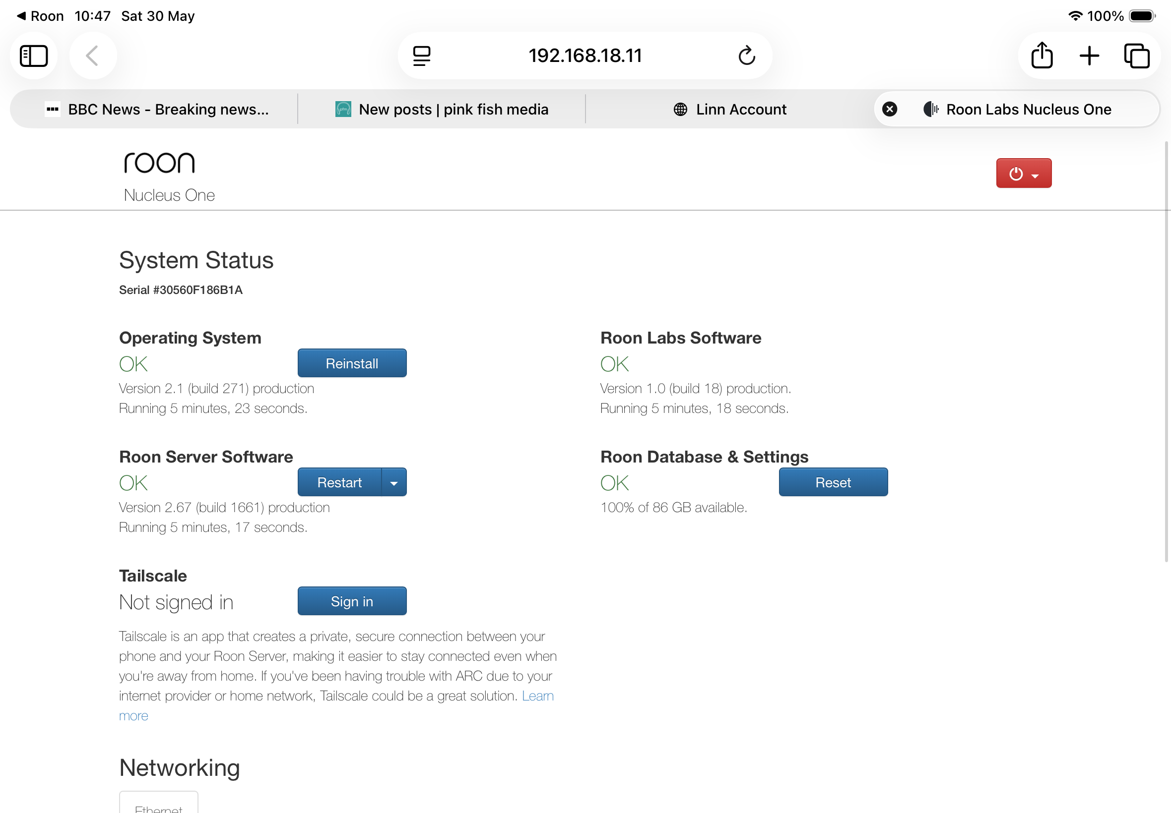

Hi @matthew_randall,
Thanks for the additional information!
If you haven’t yet, I’d temporarily bypass the switch and see if you can temporarily connect your Nucleus directly to your primary router.
Reboot everything, and we’ll attempt to enable diagnostic mode for your Nucleus once this is completed.
Thank you! :folded_hands:
Hi, ok have done that. Nucleus cable directly from router, netgear switch bypassed.
Rebooted nucleus.
Still no progress.

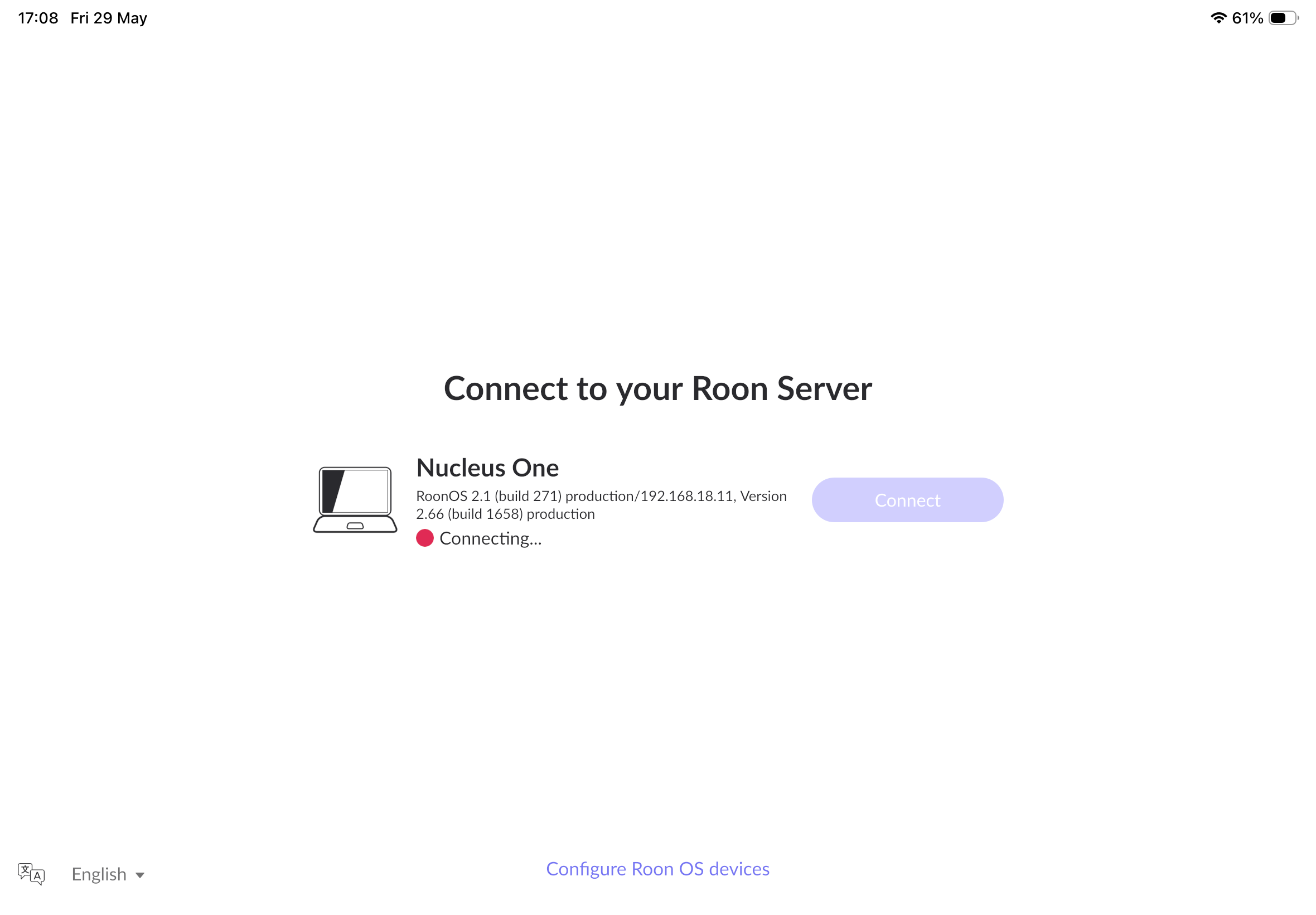

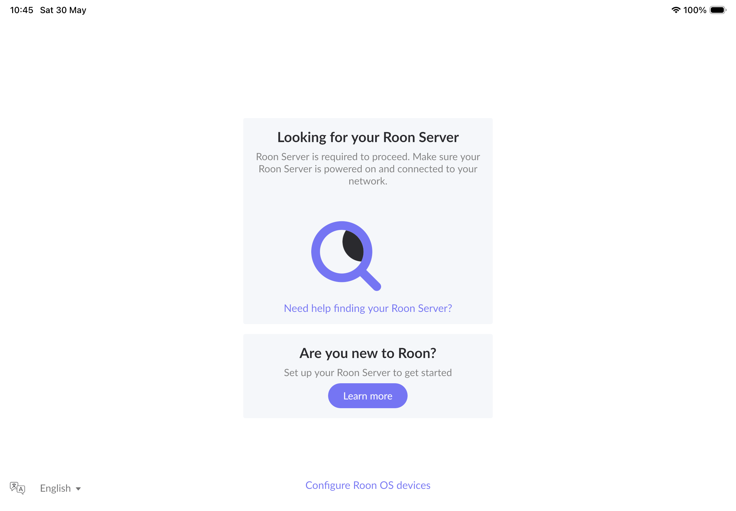

I suppose you are trying to connect from an iPad, yes?
  • What’s the iPad’s wifi IP address?
  • In the iPad Settings under Apps > Roon, is local network access enabled? If yes, try turning it off and back on.
  • In the iPad’s wifi settings for the current wifi connection, check the setting for Private WiFi Address. If it’s set to Rotating, set it to Fixed or Off.

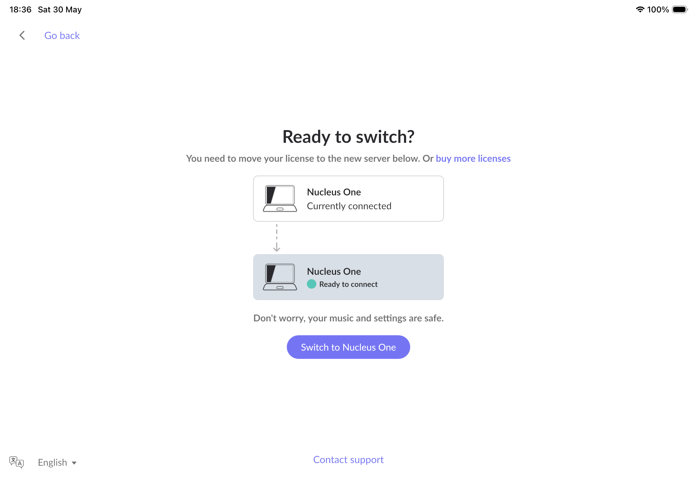

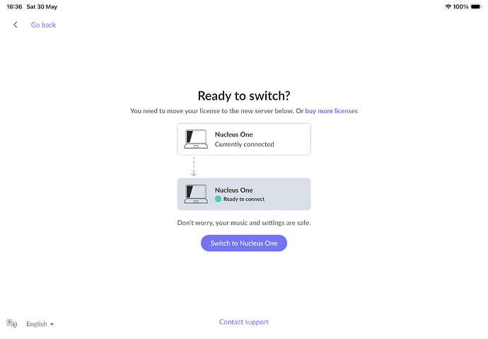

However, I’m now seeing this screen…
Why would I need to Move my licence? I’ve only got one nucleus &nothing has changed except the last Roon update a couple of days ago, which has screwed things up.
I’m hesitant to switch licence just in case it complicates things further.
Any further input much appreciated
Sometimes Roon gets confused, in particular if connection to the regular server failed. Then it thinks that the server it finds now is a new server. (The identification of a server is apparently not an exact science and depends on a range of factors).
Since your license can only activate one server at any one time, it asks you to transfer the license to the „new“ server, even though the „new“ server is physically the same one.
Just connect to this „new“ server and everything should be fine.
Side note: In the last update, Roon Labs tried to make this flow more reassuring and less scary, so now to says, „Don’t worry, your music and settings are safe“, but perhaps it’s not yet reassuring enough, so I mention this here as feedback :slight_smile:
