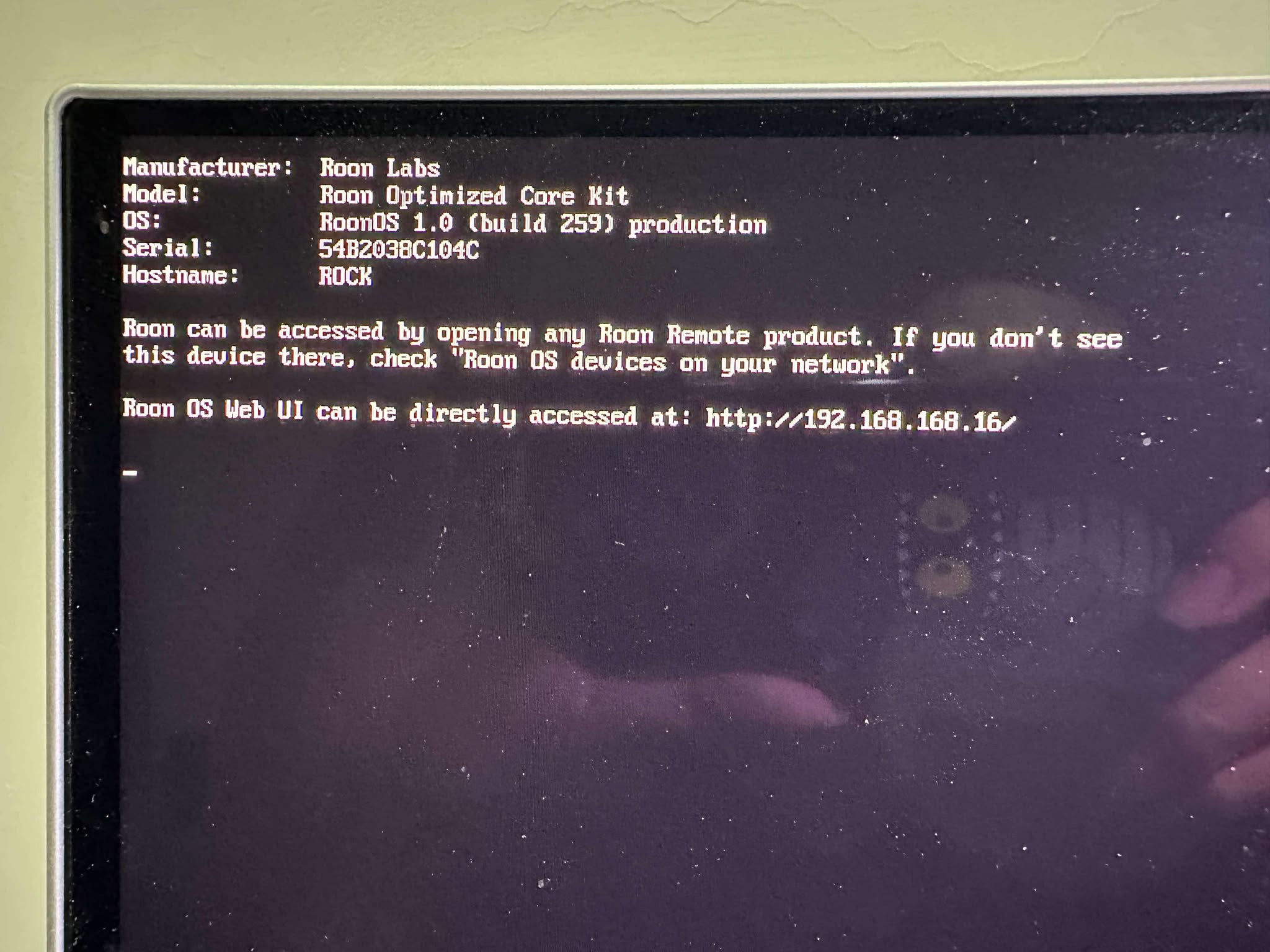

Hi Benjamin,
Resetting the network settings didn’t actually work. It initially showed an error like “no such file.” However, I eventually found the problem: the system SSD seemed to have failed and switched to a read-only mode.
I replaced the SSD and installed the Roon ROCK system instead. Everything is now functioning normally, but it appears this isn’t the original Nucleus+ system. Is there any way to restore it to its original state?
Thank you!
Hi @fdsa654hg ,
Glad to hear you were able to correct this issue! Yes, you can fill out the below form to upgrade ROCK back to Nucleus by selecting option D from question #2:
https://account.roon.app/en/contact/nucleus-troubleshooting/
