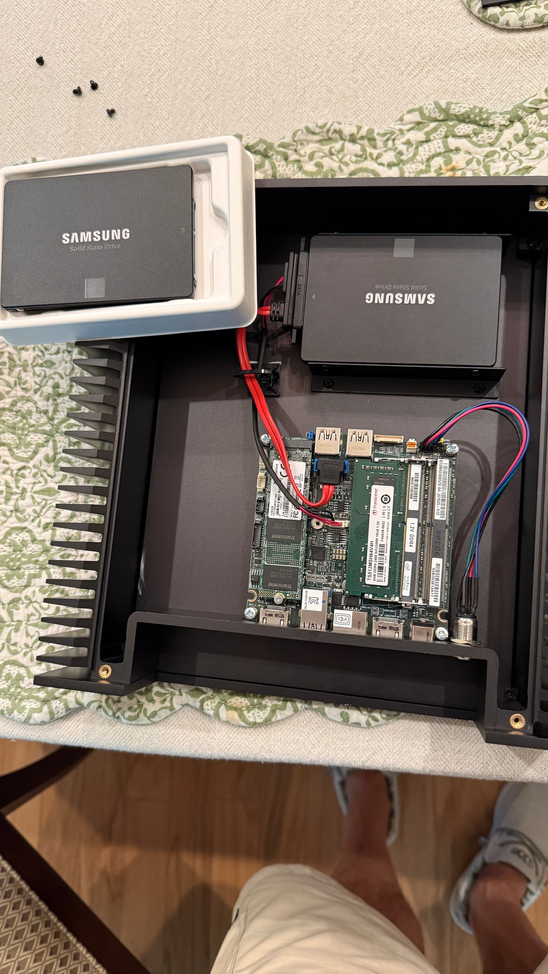

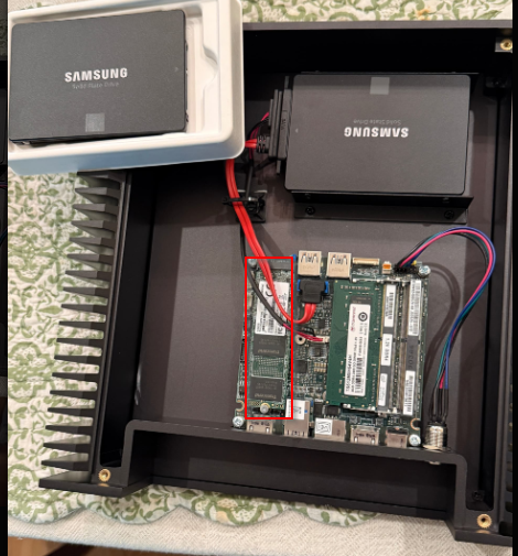

OK t got the SSD specs with AI; Is this right? Do I replace this or the chip on the left (under the red wire) and if so, what are the specs so I can get the right SSD this time?
Hi @nealsal ,
The SSD that is affected here is the M2 SSD (the one that is attached directly to the motherboard, highlighted here in red):
For the compatible models and flashing instructions, please see:
OK, the new SSD chip is installed. In the article link you sent, there’s a part “” After replacing the SSD, please follow the instructions in this article to reinstall the Roon OS. This process will install the ROCK version of the operating system on your Nucleus device." but the link goes to a dead page. Is there a proper updated page that explains next steps for the Nucleus?

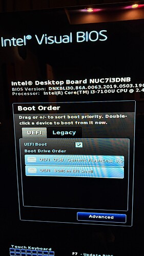

OK, I downloaded roonbox-linuxx64-nuc4-usb-factoryreset-100000258.img and then using Balena put it on a USB thumb drive. I used F2 to get to the Intel Visual BIOS screen in Nucleus and moved USB: Generic flash to the #1 top spot. Saved and exited. Tried this a few times but only get the Roon startup screen and then single white horizontal line at the top of the monitor. Nucleus does not now respond to the keyboard (e.g. CtrlAltDel to reboot.). Not sure how to proceed…

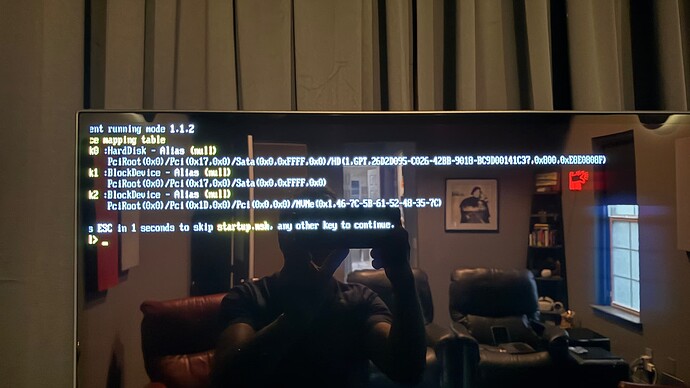

If I manually restart without the thumb drive in place I get the text below (cut a bit at the edge because of nucleus-to-monitor mismatch)
ent ruming mode 1.1.2 ce napping table
KĐ :HardDisk - Alias (mulD)
PciRoot (0x0)/Pci (0x17,0x0) /Sata (0x0.0xFFFF,0x0)/HD(1.GPT.26D2D095-C026-42BB-9018-BC9D00141C37.0x800.0xEBE0808F)
k1 :BlockDevice - Alias (mulD)
PciRoot (0x0) /Pci (0x17.0x0)/Sata (0x0.0xFFFF,0x0)
K2 :BlockDevice - Allas (nalD)
Pc iRoot (Ox0) /Pci (0x1D.0x0)/Pci (0x0,0x0)/NUMe (0x1,46-7C-58-61-52-48-35-7C)
5
ESC in 1 seconds to skip startup.ash. any other key to continue-
Good day @nealsal !
What you are showing to us on those screenshots indicates that it could not start loading the OS installer from the USB which likely means that the image was not properly burnt to the USB stick.

Still stuck… Tried again this morning with a new/largerUSB drive. Formatted it to Mac format. Launched Belana Etcher and loaded the .img which went smoothly through validate to complete without a hiccup. Restarted the Nucleus with the new USB (now listed as a 3.0) Once again I get the Roon splash screen, then a short white line top left of screen which goes away after a couple of minutes. Did something else for an hour and for giggles I again restarted the Nucleus. Got the menu this time :-). Went through the menu, removed the USB when instructed, rebooted and for 30 minutes I now have WELCOME TO GRUB! Now booting A, attempt 1. Waited a bit more; restarted and now it says booting A, attempt 2. Not showing in Roon App. So then I tried rerunning the USB. Now I get Failed to reboot when flipping back to B. Roon OS and the previous version installed both refuse to boot. You willl need to manually process using the USB. installer. Hiit Enter to reboot. (tried a few cycles with USB in and USB out but now it always goes to this message.)

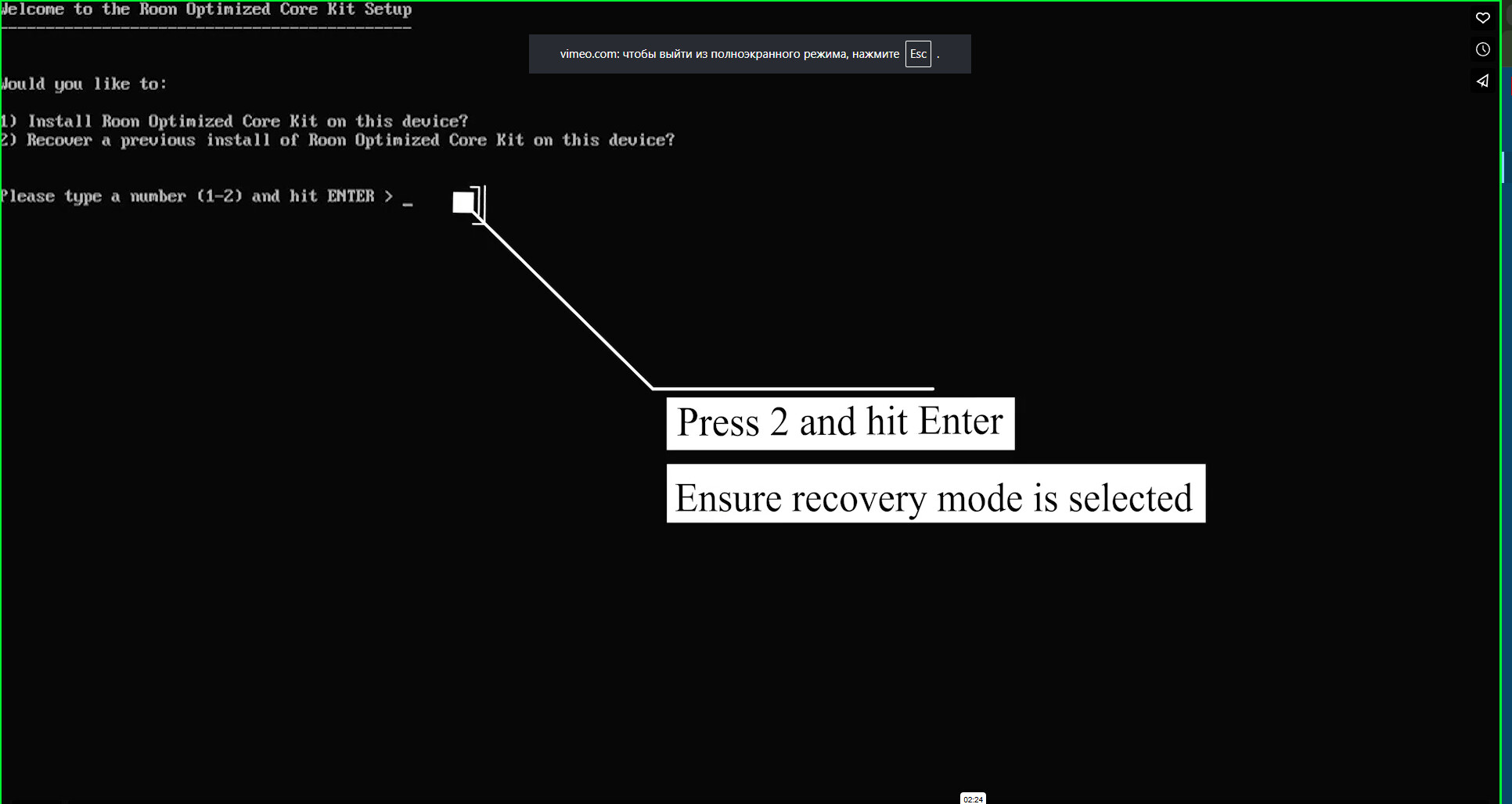

When you reach this menu, which steps do you choose?

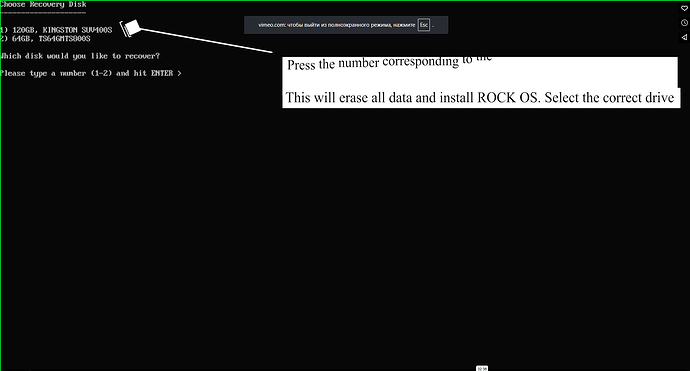

Also, which drive did you select at the step where the installer asks you to pick the target drive?

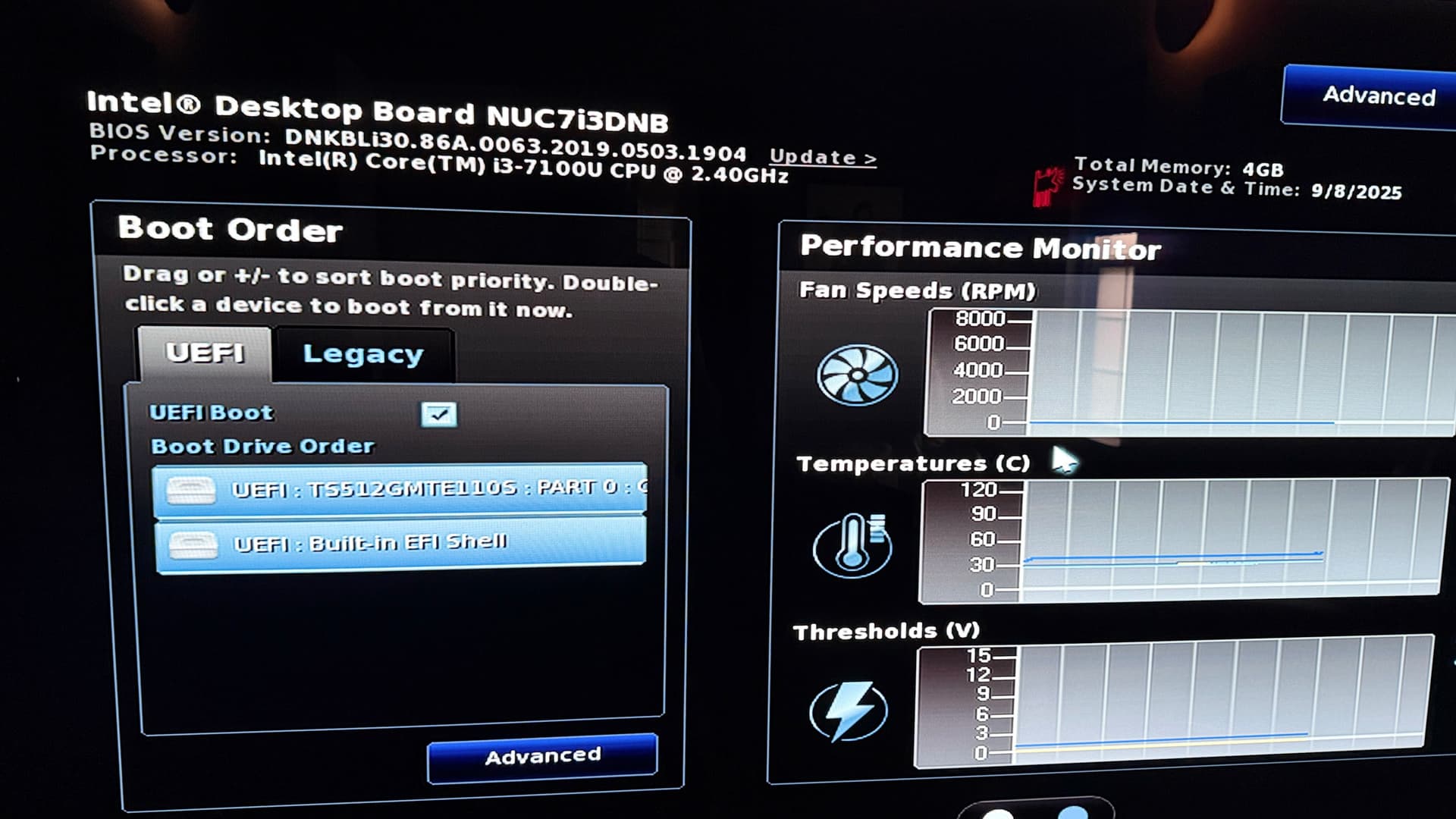

Could you also share a photo of the BIOS Boot Options menu and the Boot Configuration order?
There is a video recording of the installation process available in the article. Would you kindly let us know which steps you failed on?
I selected #1 on the first choice; I selected the option for the 512gb new SSD I installed (i.e. not the 2TB music SSD) on the 2nd menu choice.
BIOS had switched boot order; I put it back to USB- first when trying to retrace my steps…
Will revert amd repost imn a moment.
