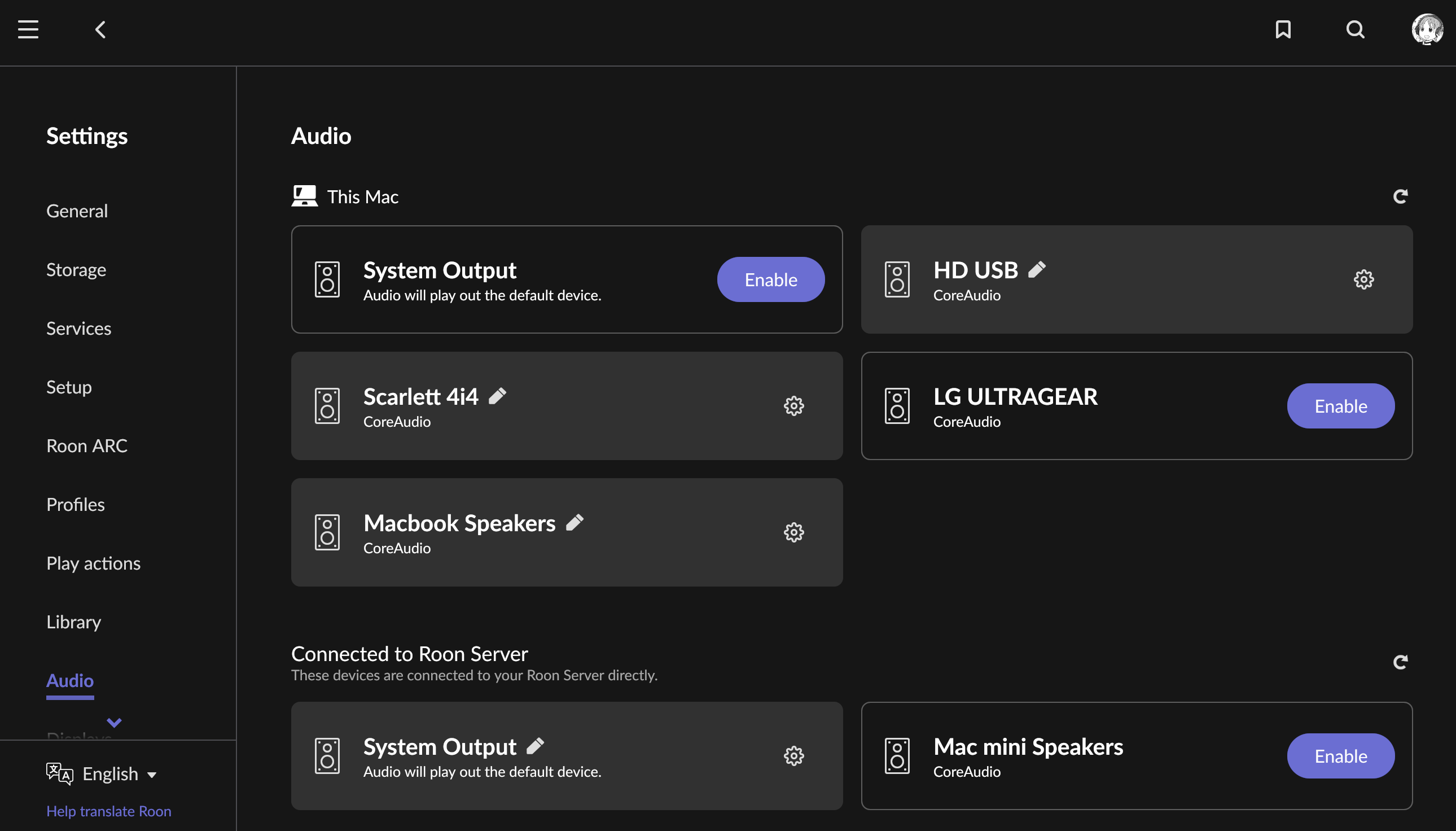

Laptop A can connect to Roon Server and play music, while the laptop B cannot and Roon doesn't see the audio devices on the laptop B. In addition, on laptop B, Roon only see audio devices from Laptop A
Roon server running on a Mac. While the laptops A and B are connecting to it via Wifi

I tired the problem persisted. I can see one of the problem is that laptop B is only showing the audio devices from laptop A. My screenshot taken from laptop B showed that on laptop B, the only available audio devices are from laptop A. Audio devices listed under “This Mac” (from the screenshot) are not available on Laptop B. Laptop B is only a macbook laptop with not external devices connected to it.
Perhaps this is the issue here. When I closed out the laptop B Roon, Roon on laptop A will work. However I could not get Roon to work on laptop B.

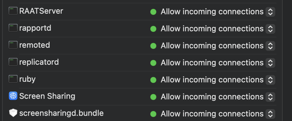

Can you check your firewall settings on both laptops? Make sure that RAATServer is allowed through on both. Most likely laptop B is the culprit.
RAATServer is allowed on Laptop B as well as A. I have attached a screenshot of laptop B
