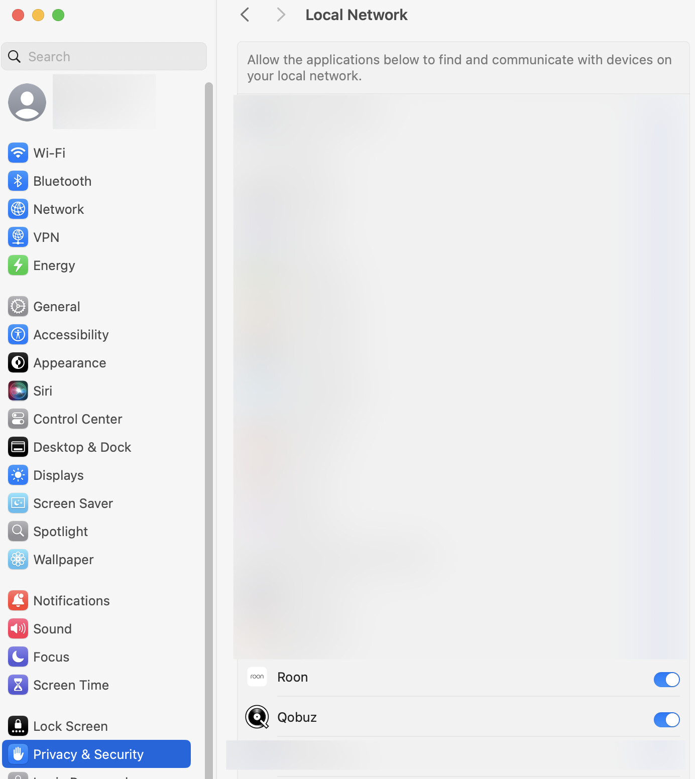

Have you recently updated your Roon Server machine to Sequoia? If so you may want to perform a search for ‘Sequoia’ on the forum in the Support category. The likely solution to such issues with Sequoia has been reported many times.
Specifically:
Navigate to macOS System Settings > Privacy & Security > Local Network , and make sure Roon is allowed:
If it is already enabled, toggle it off and on again.
Then reboot your Mac, and see if the same issue persists.
Hi @magasin-marseille-pd,
Please see the above posts. MacOS 15.x Sequoia more strictly polices the local network connections, and you’ll have to grant Roon specific local network access.
