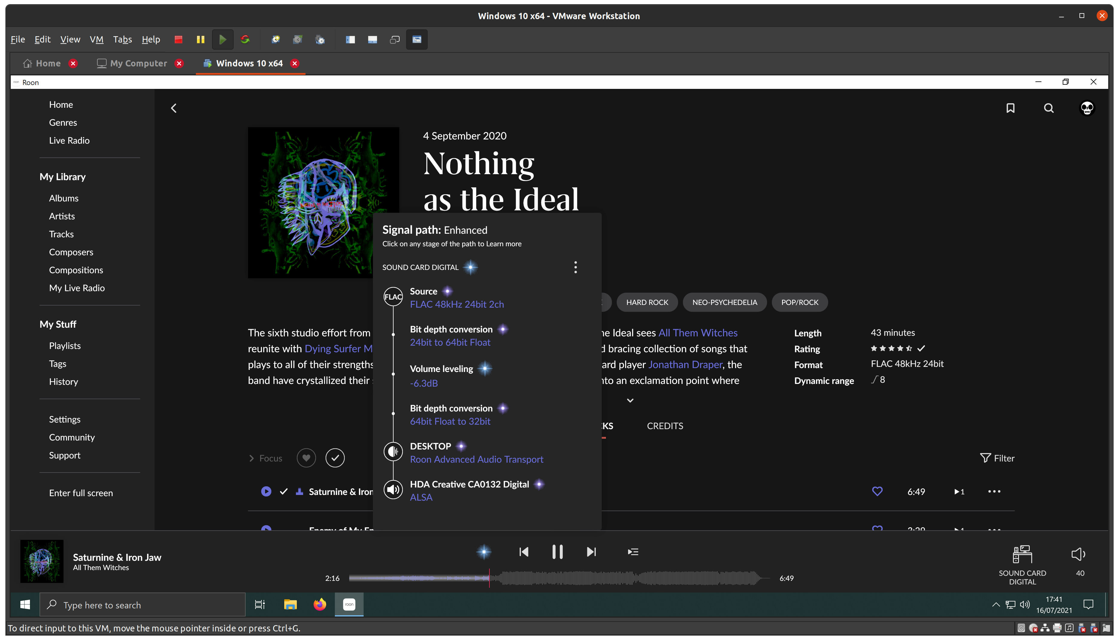

Roon does not start and has never started on VM. Program starts and freezes on black window as shown below. No load is observed on system.
I suspect an issue with VMware’s display drivers but would like to confirm this before abandoning this idea completely.

For anyone stumbling across this post it turned out that I needed to use the development branch of WINE because the winetricks .NET Framework 4.8 package is not supported on the stable branch. On winehq-stable was able to install and launch Roon but it would hang on clicking ‘agree’ without .NET runtime installed.
I mentioned this is the other thread about running Roon in a Windows VM. You can download the opengl32.dll drivers and copy them into your installed Roon directory. That is how I run Roon in a Windows 10 VM.
Your Mesa3D solution works perfectly. Thanks!
I now have a choice of two methods for running Roon on Linux.
