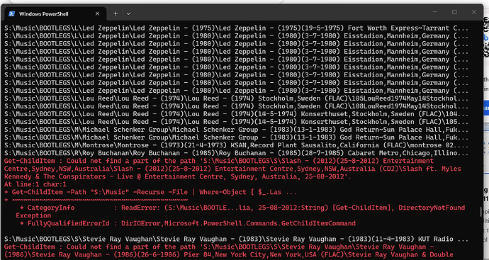

Perhaps your computer technician can use Windows PowerShell to find files with corrupted dates. See if they can do the following:
  1. Running the following command in PowerShell will list any files with a modified or created year outside the range of 1900 to 2050:
Get-ChildItem -Path "S:\Music" -Recurse -File | Where-Object { $_.LastWriteTime.Year -lt 1900 -or $_.LastWriteTime.Year -gt 2050 -or $_.CreationTime.Year -lt 1900 -or $_.CreationTime.Year -gt 2050 } | Select-Object FullName, LastWriteTime, CreationTime
(Note: If the music folder has been moved or mapped to a different drive letter, the path in quotes must be updated accordingly.)
Any files returned by this command are likely contributing to the crash. To resolve the issue with those files:
  • Remove the files: Move them out of the watched folder entirely.
  • Fix the dates: Open and save the files to update their timestamps to the current date, or use a bulk file-attribute editor to rewrite the timestamps.

Hi Benjamin, we have started running the PowerShell command there are results in white and some in red. I’m assuming we only need to fix the red entries. We have found that some of the files have a file name to long coud this be causing an issue.
Hi @Dale_Rowney,
Yes, you definitely want to address any errors found in this case. Let me know if you find any files specifically with the date range we’ve mentioned above - this seems to be the source of the issue.

Hey Benjamin, So my tech finished the PowerShell and removed all RED files from my music folder,plus did updates as you suggested. It has been a week now and I have had one example of “an audio file is slow to load” Also I’m being prompted to do a Roon update already,but I’ll ignore that for the time being Whilst listening to music today when fast forwarding it is getting a tad slower. One good thing (finally) when I checked Settings-Library-Background Audio Analysis the individual files are increasing (albeit very slowly currently at 39,580-168,292) whereas previously they were stuck on around 13,000 odd. Can you also tell a dummy like me what scheduled/unscheduled means ? (currently on unscheduled) And what should it be on,I do remember someone telling to change the hours (which I did-maybe updates changed it back to unscheduled) One other strange problem,I downloaded an album,listened to it and deleted the songs I didn’t want but Roon kept the song with a notification of “currently unavailable” in red next to it. It was deleted from my hard drive though.This happens if I use the Roon interface or delete the songs via the folder in my hard drive. Ever come across that before ? Sorry I don’t know how to screen shot for you.When Roon is reinstalled it goes away,very odd. That’s about it in this never ending sage,lookingt forward to your reply. dale
