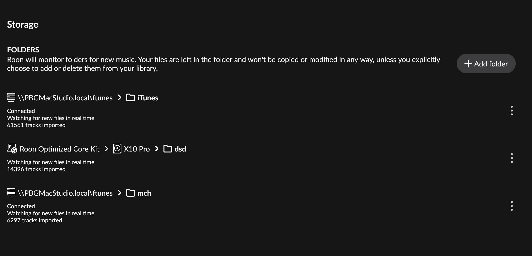

Roon only finds half the tracks compared to a few days ago (ref#MK0GJA)
Roon only finding 1/2 the tracks it did a few days ago
Hardwired 2.5Gb / 1Gb unmanaged network
I use itunes on mac to rip CDs etc to a file system that is SMB shared to Roon.
Normally things work fine - roon sees the “iTunes” mount and indexes the 120,000 tracks there.
Itunes still sees that number of tracks, and the file system shows that number of tracks.
But as of yesterday roon only sees 61,000 tracks there.
Roon ROCK is running on a mini intel server.
Rebooted my Mac, rebooted the ROCK, told Roon to reindex the dir, disabled and reenabled the storage location, but none of that has fixed the problem.
Thanks.

It sounds like Roon is possibly unable to traverse the full storage location ``\PGBMacStudio.local\iTunes` because of a read permissions issue on a particular subfolder. Is there a pattern to which iTunes content is missing? If you notice an entire subfolder is missing, ensure that read permissions haven’t changed.
What do you see in Settings → Library → Skipped Files?
You mentioned these missing iTunes track files are still visible in a file viewer - what happens if you attempt to drag-and-drop one into Roon, or move it to the mch location that is also targeted as a Watched Folder per your screenshot?

On the ROCK via file browsing I stopped roon, moved the Database directory out of the way, restarted roon and added back the file shares. It again stops at 1/2 of my tracks on ftunes/itunes
