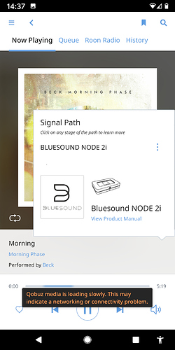

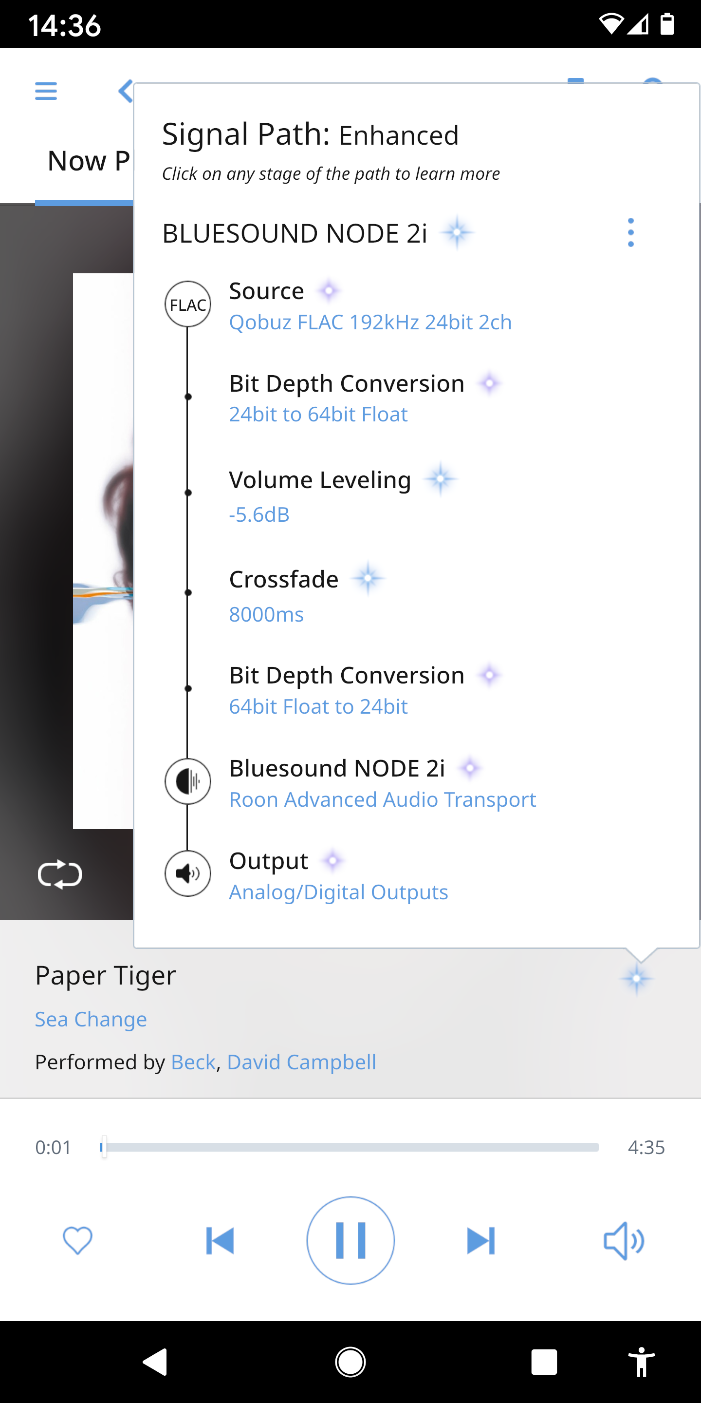

Can you please share a screenshot of your Signal Path when you attempt to play 24-bit Qobuz content?
Also, when you say that it doesn’t play, what exactly are you seeing? Does the progress bar move and you’re getting no sound or is playback unable to start at all? Any error messages?

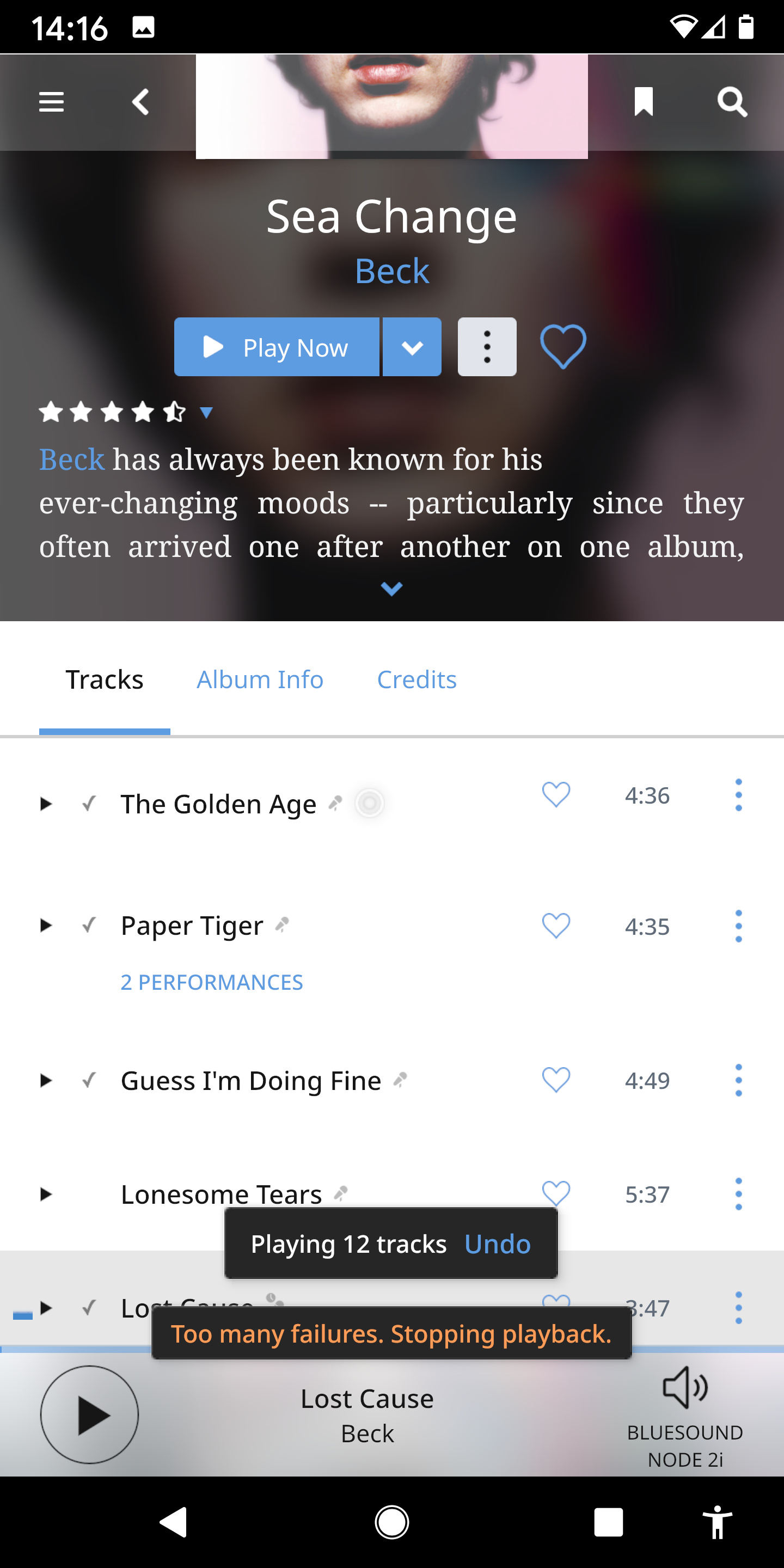

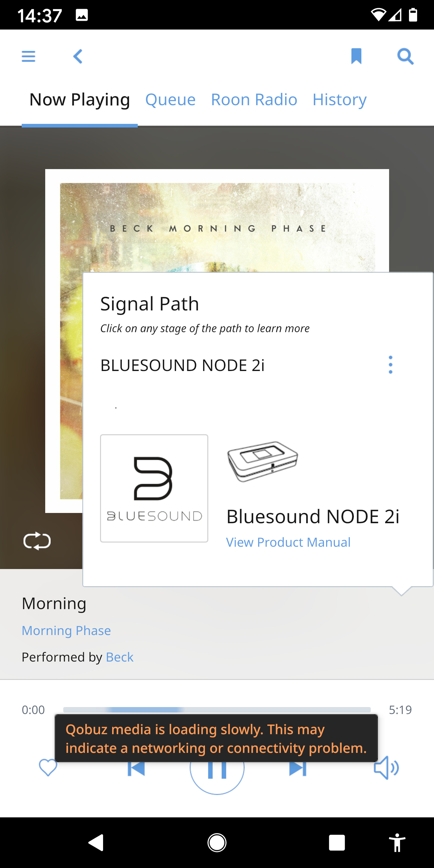

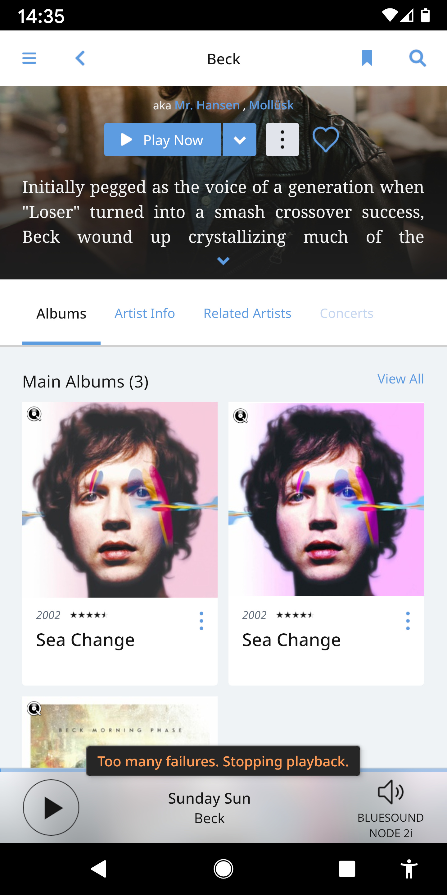

When I play 25 bits tracks on Qobuz Studio it starts sounding well a few seconds, then it stops, then it may jump into another track forward, then it just sounds like pink noise. And stays on the back even if I change to a CD track.
I paste some screenshots attached.
