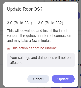

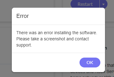

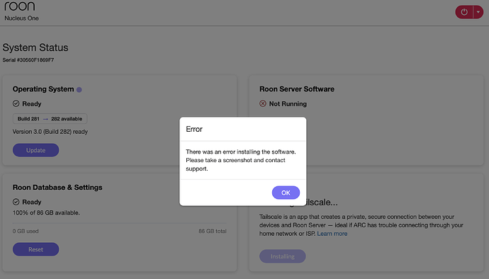

Tried to update from build 281 to the new build 282 using the update button in the web ui and got the following error:
RoonServer cannot be restarted via the Web UI either.
A reboot brings RoonServer back up and running.

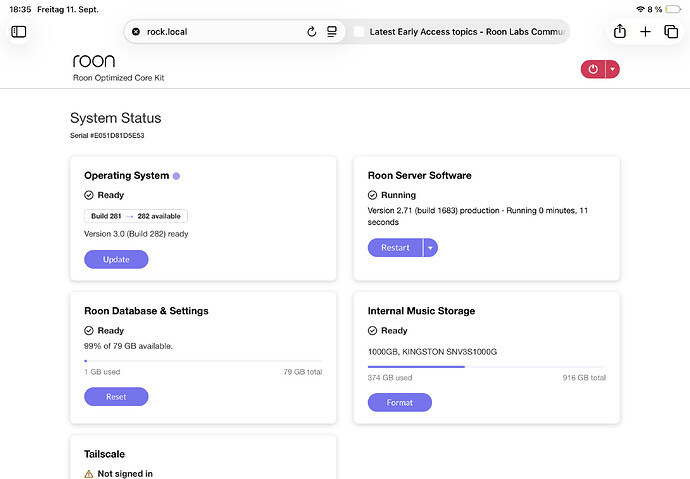

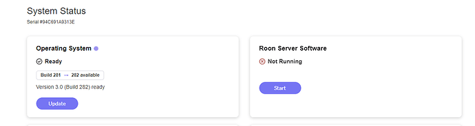

WebUI reports build 282 to be installed yet still offers the update button to build 282:
Roon App however reports build 281 to be installed and also prompts for update.
EDIT: Triggering the update from the RoonApp and not the Web UI has worked in the third attempt.

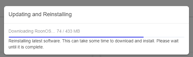

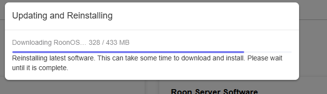

Mine’s getting hung at 431MB of 433MB RoonOS download. Several times now :confused:
So I’m stuck in updating until this is corrected somehow.
UPDATE: Reconnecting shows this:

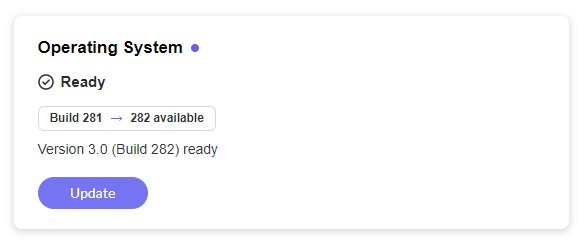

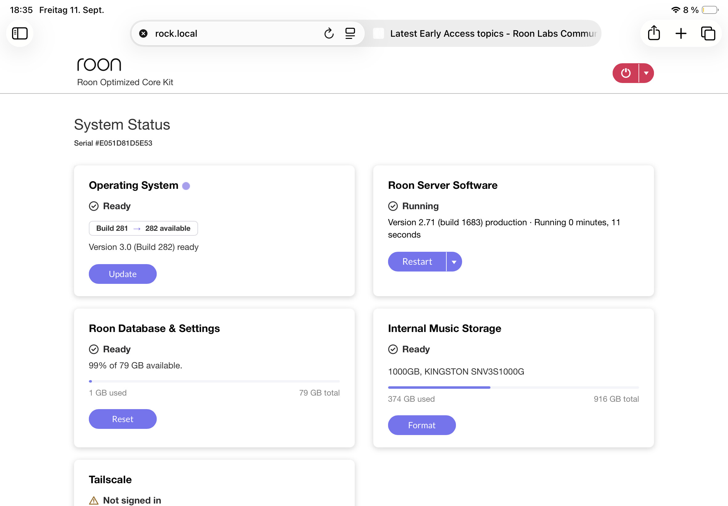

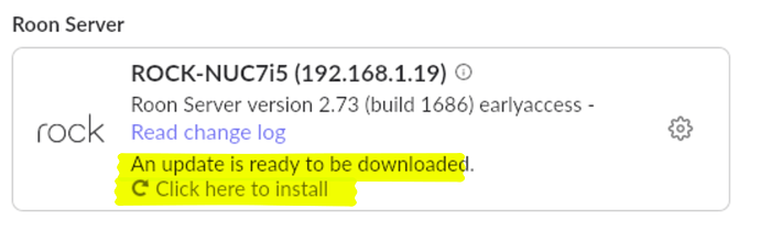

I haven’t manually pushed my system to B282 and yet I don’t see an update on the /about page in roon.exe. (as described by @suedkiez)

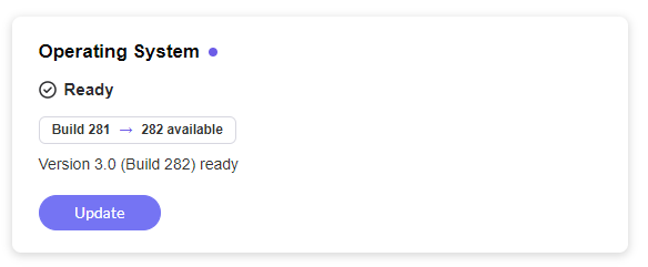

It’s possibly more ambiguous (for me at least) as the web GUI shows this
Version 3.0 (Build 282) ready suggests to me that B282 is running and ready, but, image suggests that the update is available. Which is it?
I have not manually activated any RoonOS update for the recent updates but they all seem to happen by themselves (100% certain of this as I was away for the last two so cannot have pushed update for them).

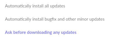

For Roonserver, I can set whether to allow auto-update or not.
For RoonOS, I don’t see that cogwheel option anywhere.

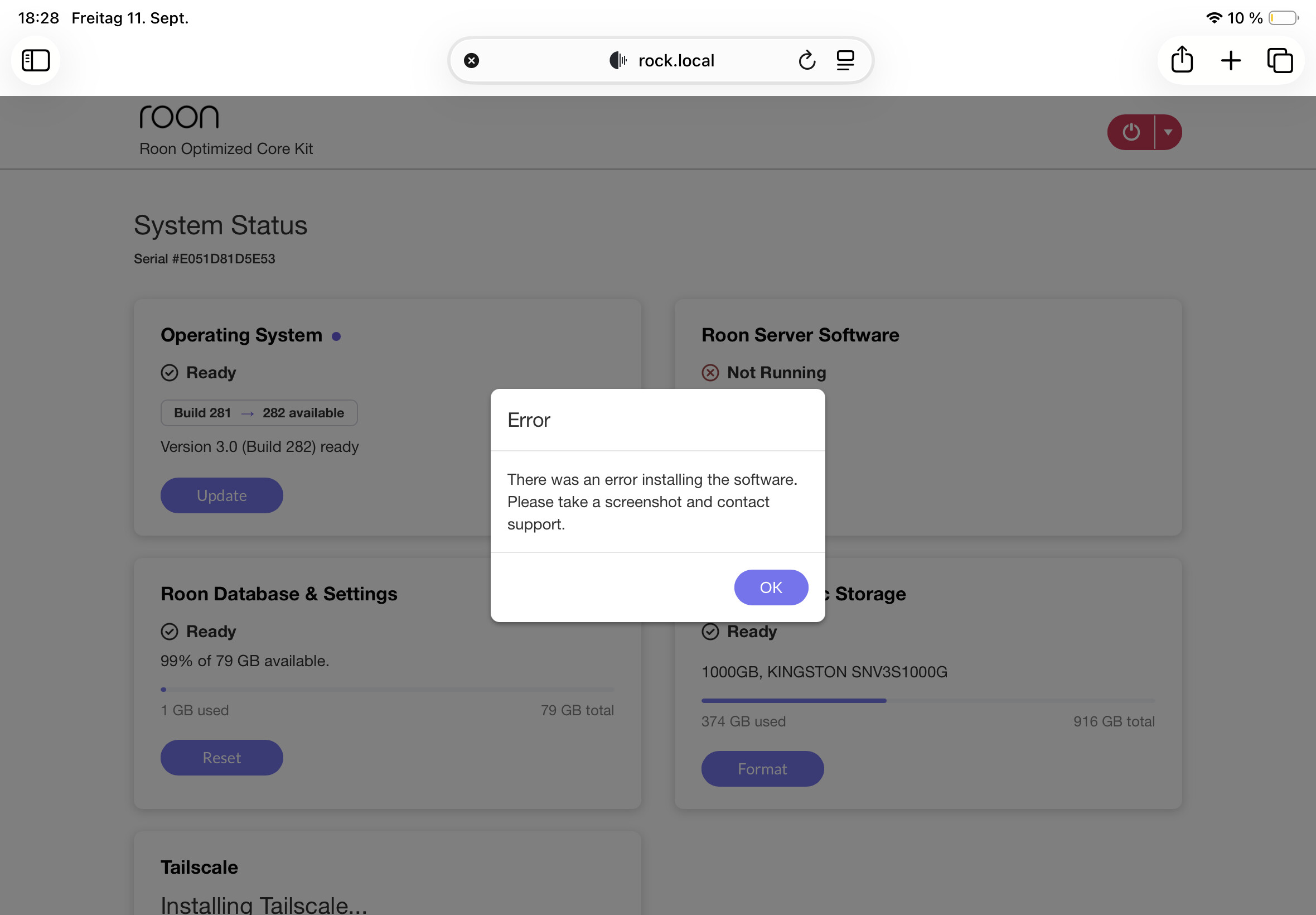

So, I proceed to action the update (even though it suggests I already have it !?!)
This leads to this which is what I saw on B281

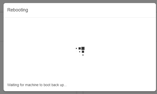

Reboot NUC from the GUI button
results in this (stuck)
So, I have to hard boot the NUC to get past this (I have reported this before with LG OLED attached to the NUC)
Physical reboot works and I am back to this
So, it looks like the RoonOS update process is a bit broken. And the HDMI functionality doesn’t work from a soft reboot.

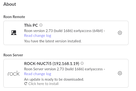

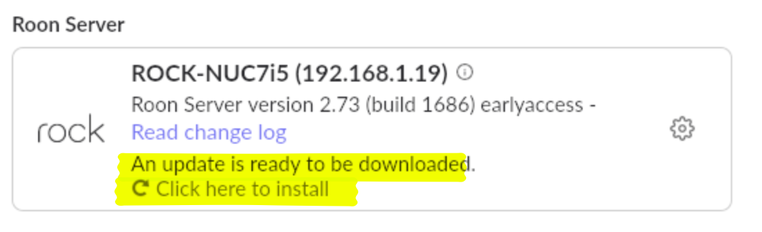

It’s there:
It looks like the update is for the RoonServer 2.73 (1686), but there is actually no update for the RoonServer right now (1686 is already the latest). But if you “click here to install” it will update RoonOS. A bit confusing.
OK…totally unclear in that case as that section is titled Roon Server. Maybe that is where I have been activating the RoonOS updates previously as I have assumed the update is for Roon Server.
@vova suggest add this to the list of things to make clearer.
Ironically…activating the update from the Roon Server section of the Roon app does succeed.
The most likely reason is that /tmp is full. It’s an in ram filesystem so rebooting it should clear the space and allow the install to complete. I thought there was an error code included with that dialog so will make sure that comes up. Also adding more checks before starting the install.
Rebooted mine several times and it still hangs downloading the larger (OS) update - gets to 431, 432, something like that, then just hangs.
I rebooted a few times also and activating the update via the web gui fails.
Activating the update via the settings/about page of the roon app succeeds.

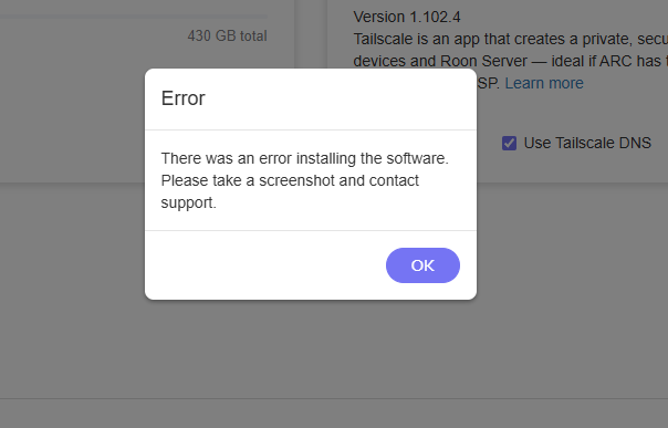

I am having the same issue, where upgrading from the web interface resulted in an error, and the server not being able to restart without a reboot. Running 281 trying to install 282
At the same time, upgrading from the app wasn’t working either. I currently run the server using ROCK os in a vm on Proxmox and had 4GB of RAM assigned to it. As the above post suggested, the tmpfs was probably getting full because VM RAM usage was maxed out. I bumped it to 8GB RAM and it upgraded to 282 no problem.

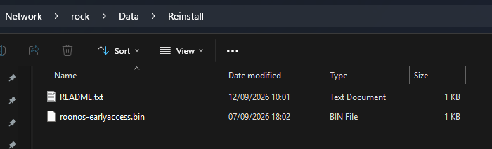

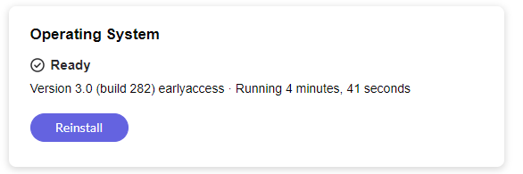

I am now trying to revert to production version and I am getting the same error when doing a reinstall from the web interface. I can’t trigger a reinstall in the app in this case, so my thinking is there might be an issue with the state of the upgrade process in early access since 281?
I have exactly the same issue. The reinstall function doesn’t work since B281.
