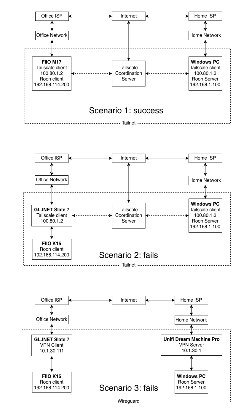

Do the 3 scenarios below describe your network setup correctly?

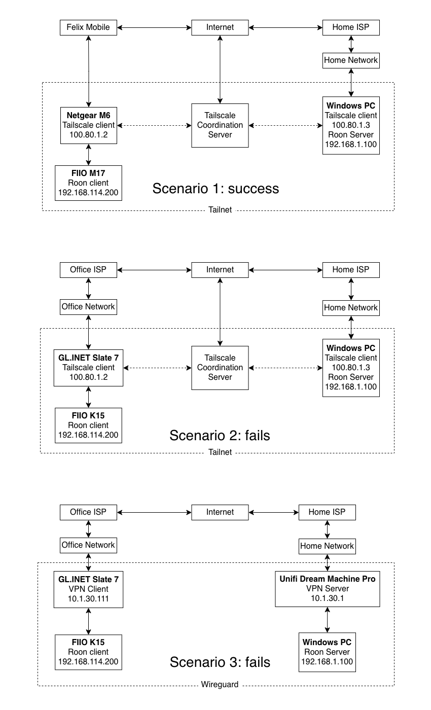

Almost bang on :slight_smile:
For number 1, it’s M17 (tailscale installed on the M17) then office internet then to home internet
Corrected Scenario 1…

Here’s my hypothesis why the GL.INET Slate 7 and Tailscale scenario fails:
  • Outbound path (FIIO → Roon Server)
    • FIIO K15 (192.168.114.200) sends connection requests to the Windows PC (192.168.1.100)
    • GL.INET Slate 7 routes the traffic through Tailnet and may be SNATing
    • Windows PC receives the packets
  • Inbound path (Roon Server → FIIO)
    • Roon sends multicast and RAAT discovery packets to its local subnet but they never reach the Roon Remote
    • Windows PC looks at its routing table and sees 192.168.1.0/24 and 100.80.0.0/10 but has no idea about 192.168.114.0/24 (FIIO K15) - the PC knows about its subnet and Tailnet, but is blind to devices behind the Slate 7
