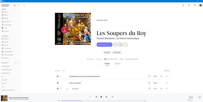

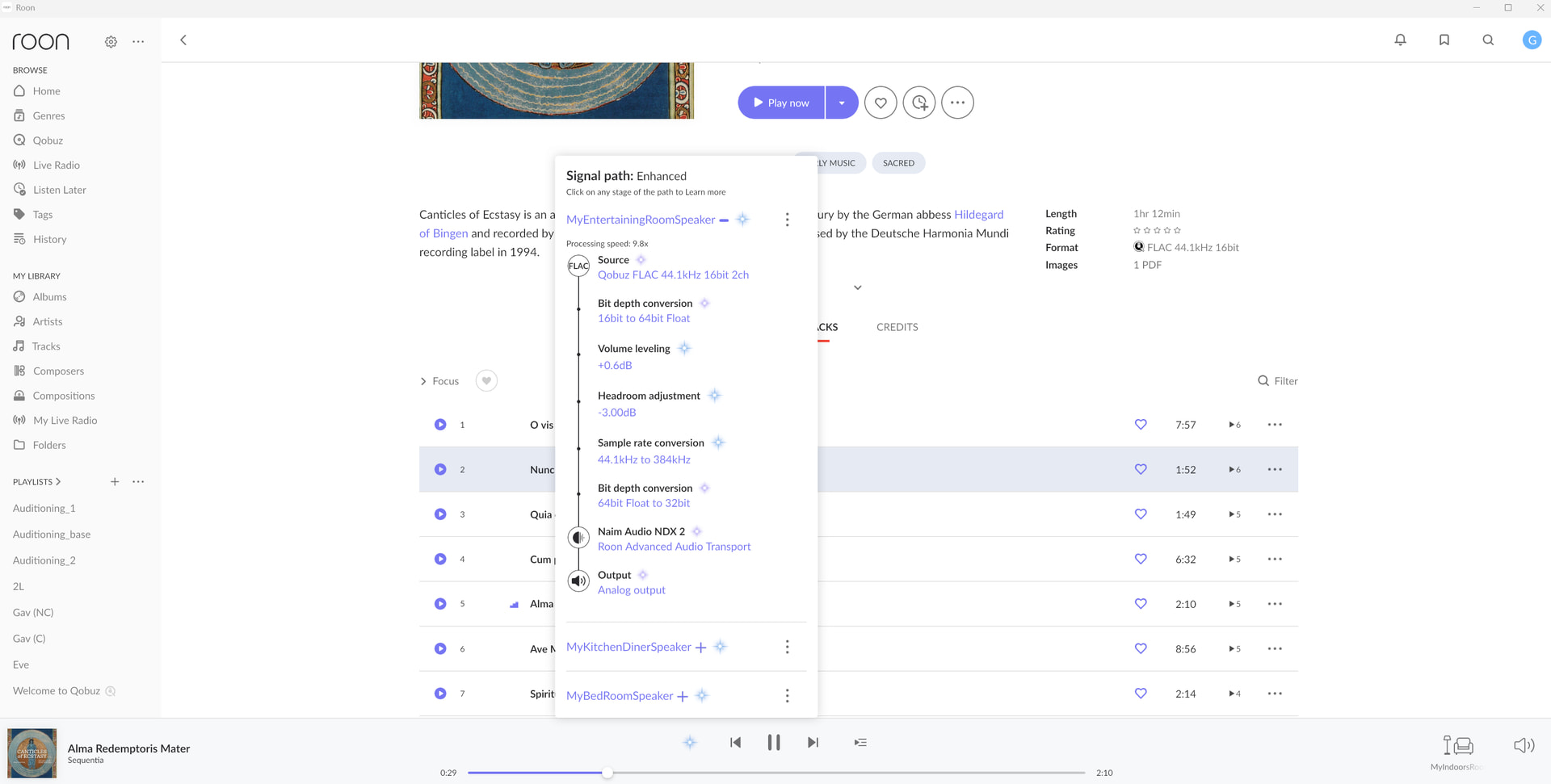

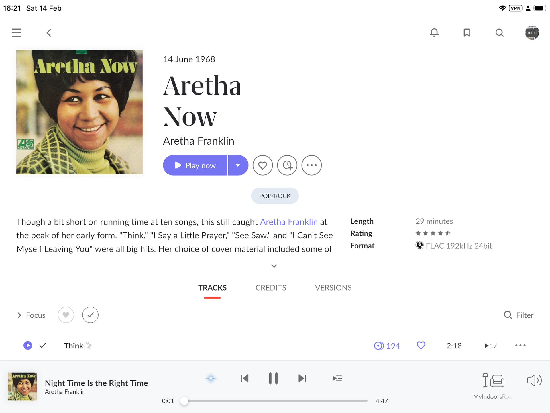

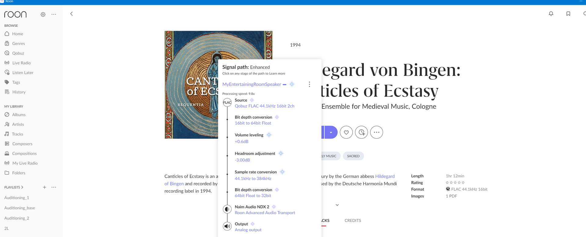

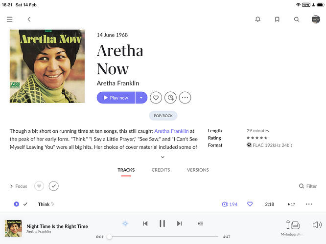

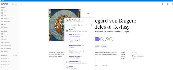

Thank you Connor,… I’ve been unwell, sorry… See also the screenshots… Attempted to play an album today,… Between 1225 and 1230 hours each track played only seconds then skipped to next/… Then at 1230 hours it all stopped at track 5 or 6!… Hope you can find the problem in the logs… I’ve described my network in the original post…the router is connected by FTTC broadband to the Internet through EE (with download speeds around 50 and upload around 15) …please note this, and then the network, works ok for Qobuz Connect…. Many thanks for your help… Gavin
As an update, I tried again with this album from the beginning, but it continued to skip tracks, and it eventually stopped mid track at around 13:00 hours…
and this album skipped and then completely stopped mid-track at around 13:20 hours…

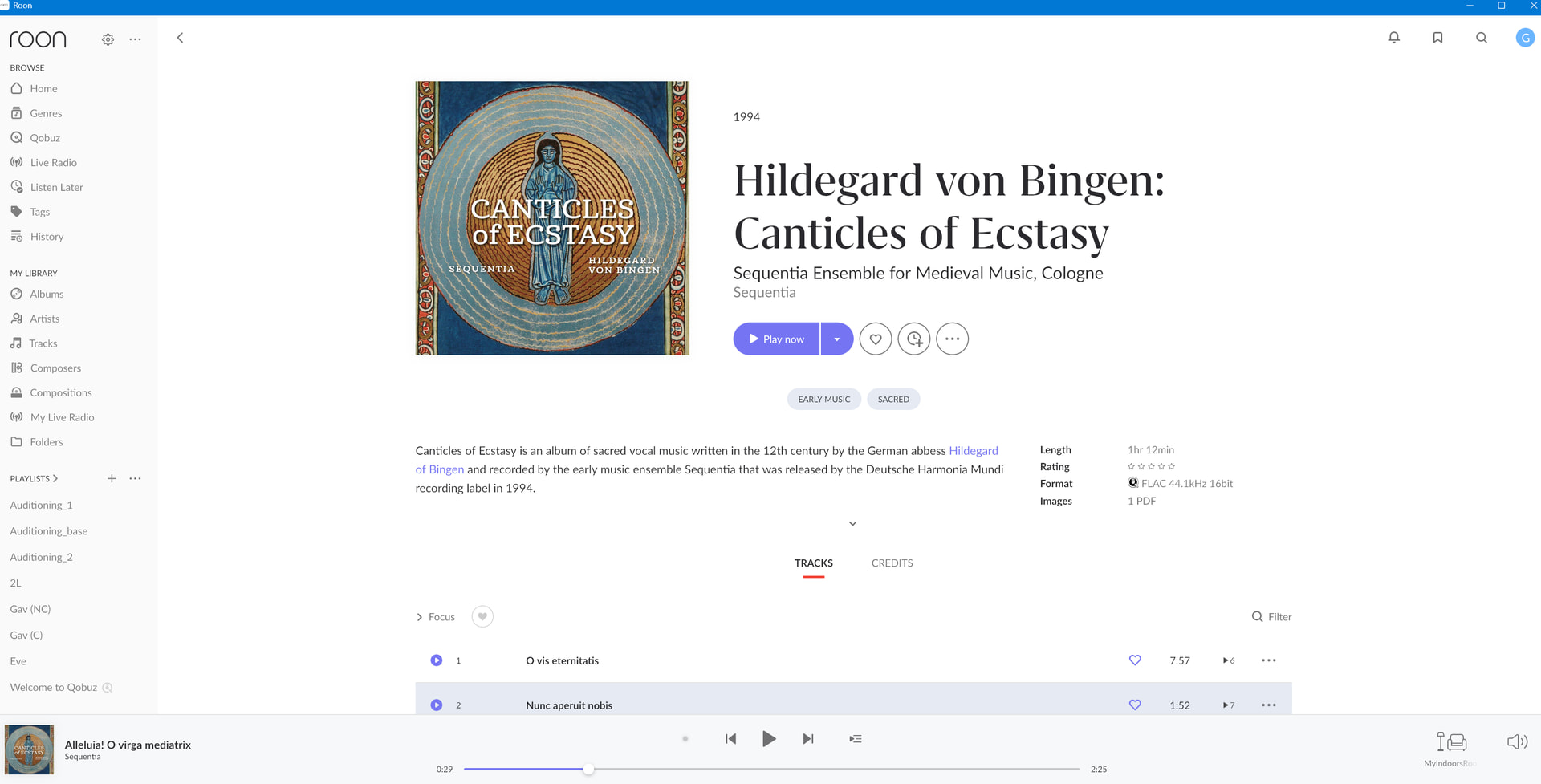

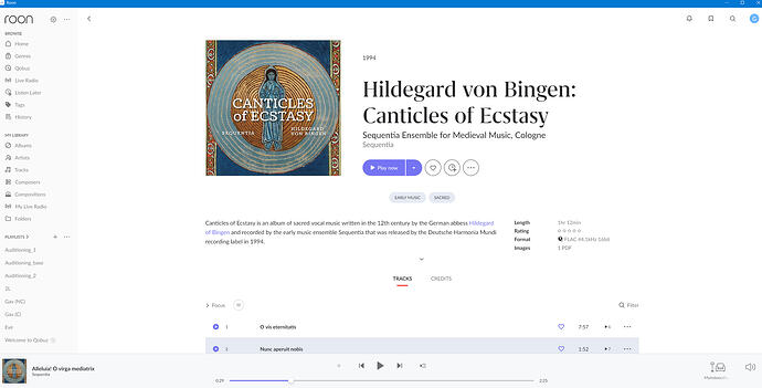

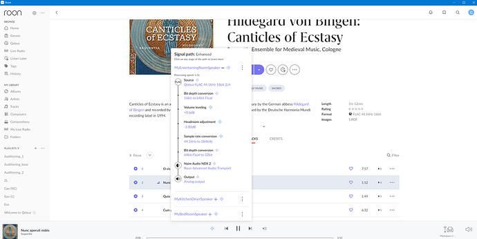

….and this stopped playing suddenly around 14:30 hours…will persevere with another album

Finally, this albuM
played through without a problem… streamed from my Melco drive via the home networK
But this skipped at the beginning of every track from 16.20 hrs then gave up the ghost at 16.24 hrs… had enough for the day.. .not a good experience Im afraid
