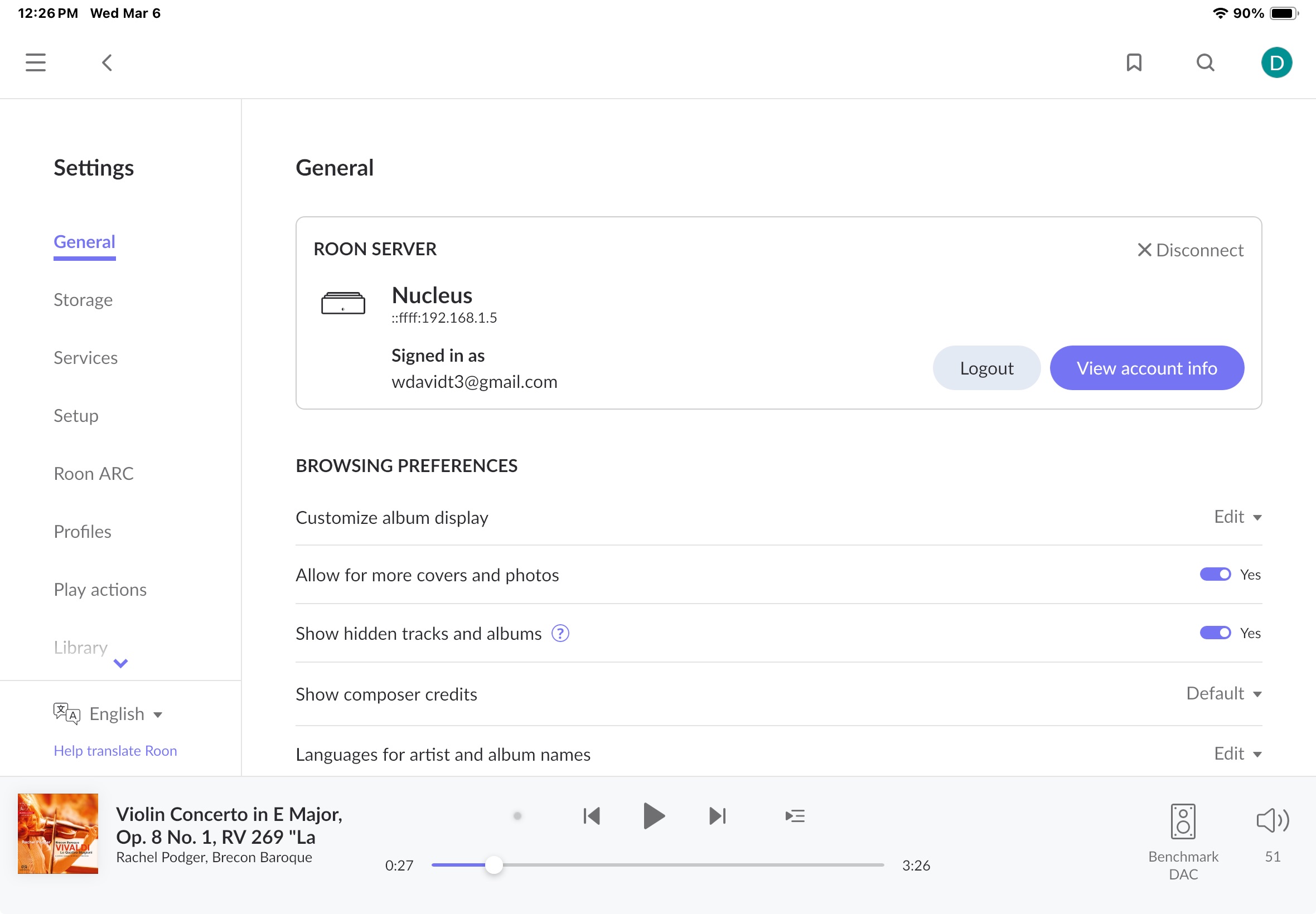

I see one thing that seems possibly anomalous: In the Roon Web Interface, the IP address of my Roon Nucleus shows as 192.168.1.5, which is correct. That is also the case in the Roon app on my PC, under General. But in the Roon app on my iPad—the normal way I run Roon—under General, SOMETIMES the Nucleus IP address shows as ::ffff:192.168.1.5. The ::ffff: seems possibly wrong, and I don’t know what it means, but I don’t see any way to edit it out. Can anyone shed light on that?

I suspect that one problem could be that my iPad Roon App shows a possibly corrupted IP address for my Nucleus which acts as my Roon Server. It shows the Nucleus IP address as ::ffff:192.168.1.5. Until this problem started without me making any changes to my system, the Nucleus address always showed as only 192.168.1.5. That address is still the address that shows for the Nucleus using my desktop Roon Web App and using Setup > Find Roon OS. Screenshots of both are attached. (However, as noted above, even though the desktop Roon OS under Setup shows only 192.168.1.5, the desktop also plays no sound through my Benchmark DAC audio zone.)
I suspect that I may need to edit and correct the Nucleus IP address seen in my iPad Roon App. However, I have no idea how to do that. It could of course also be that the problem has a different cause.

::ffff: is a subnet prefix for IPv4 (32 bit) addresses that are placed inside an IPv6 (128 bit) space. IPv6 is broken into two parts, the subnet prefix, and the interface suffix. Each one is 64 bits long, or, 4 groups of 4 hexadecimal characters.
In other words, it is an IPV6 rendered IPV4 IP. I think Apple uses IPV6 which is why you are seeing it there.
Thanks, Rugby. I don’t really understand that at all well :). I thought that IPv6 and IPv4 related mainly to Roon ARC, which I haven’t been able to get working. I also don’t understand why ::ffff: suddenly started showing up when this problem arose - I’m pretty sure it wasn’t there before

When I put the Nucleus IP address 192.168.1.5 into the URL bar of my Safari browser, I get taken to the Roon System Status screen. Everything shows as “OK” there, and the IP address shows as 192.168.1.5, without the ::ffff: preceding it. However, in the Roon App on my iPad, when I go to Settings > General I see the Roon Server Nucleus as ::ffff:192.168.1.5
I have wondered whether I should reinstall the Roon Operating System, which shows as 1.0 (build 259) production, and shows OK, or whether I should restart the Roon Server Software, which shows as 2.0 (build 1368) production, and shows OK. But I haven’t done that for fear of possibly causing additional issues.
