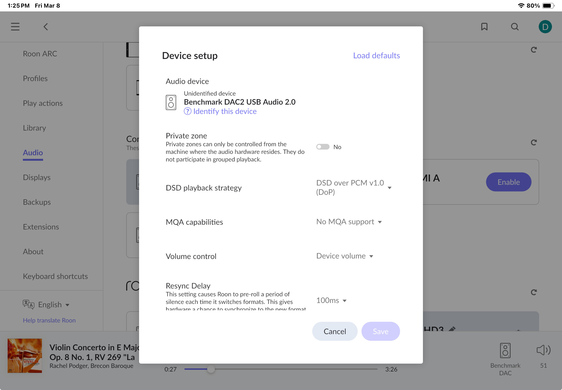

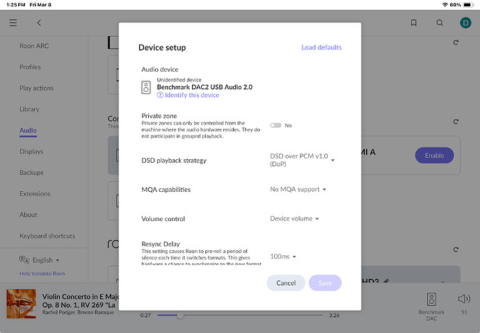

Clicking identify for the DAC returns either DAC1 or DAC HGC, neither of which is correct. It’s actually a Benchmark DAC 3L, which doesn’t come up, but the Benchmark people say it is fine that it shows as Benchmark DAC2 USB Audio 2.0. That has worked fine for over two years since I bought the DAC, until sound stopped working several weeks ago with absolutely no changes by me.

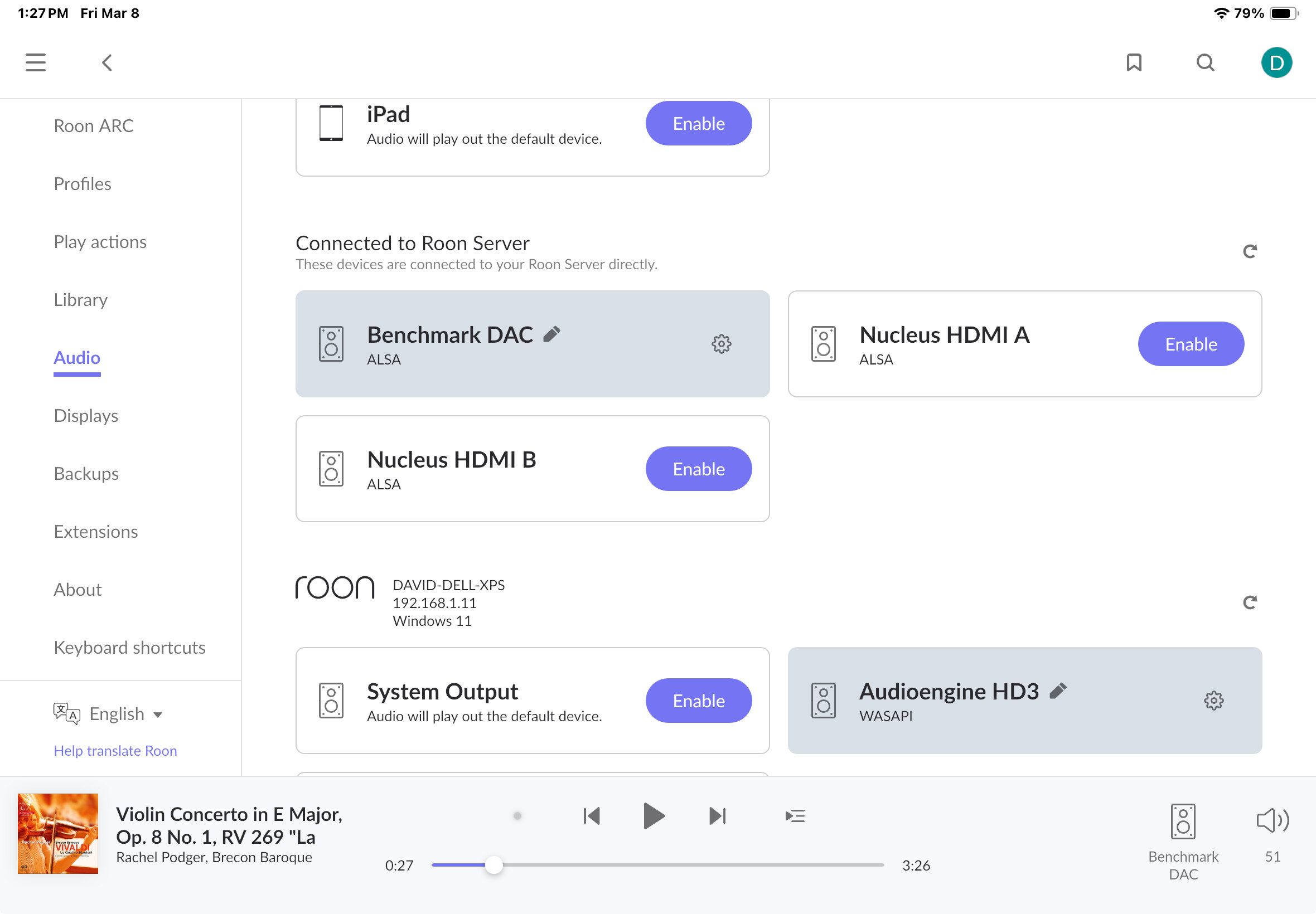

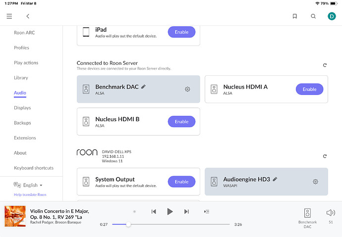

As previously posted, Roon will play sound over my second audio zone, the AudioEngine speakers connected to my desktop (see the screenshot above). But it will NOT play sound over my Benchmark DAC audio zone. I don’t know how to erase that zone and recreate it in case it somehow has gotten corrupted - can you advise on that?

David, as a quick follow-up test - what happens if you change your Zone Settings>Device Setup> from Device Volume to Fixed Volume? Do you experience the same issue?
I’ll be on standby for your reply :+1:
Just saw this. No luck - when I change device setup to fixed volume, Roon still shows the track playing but there is no sound

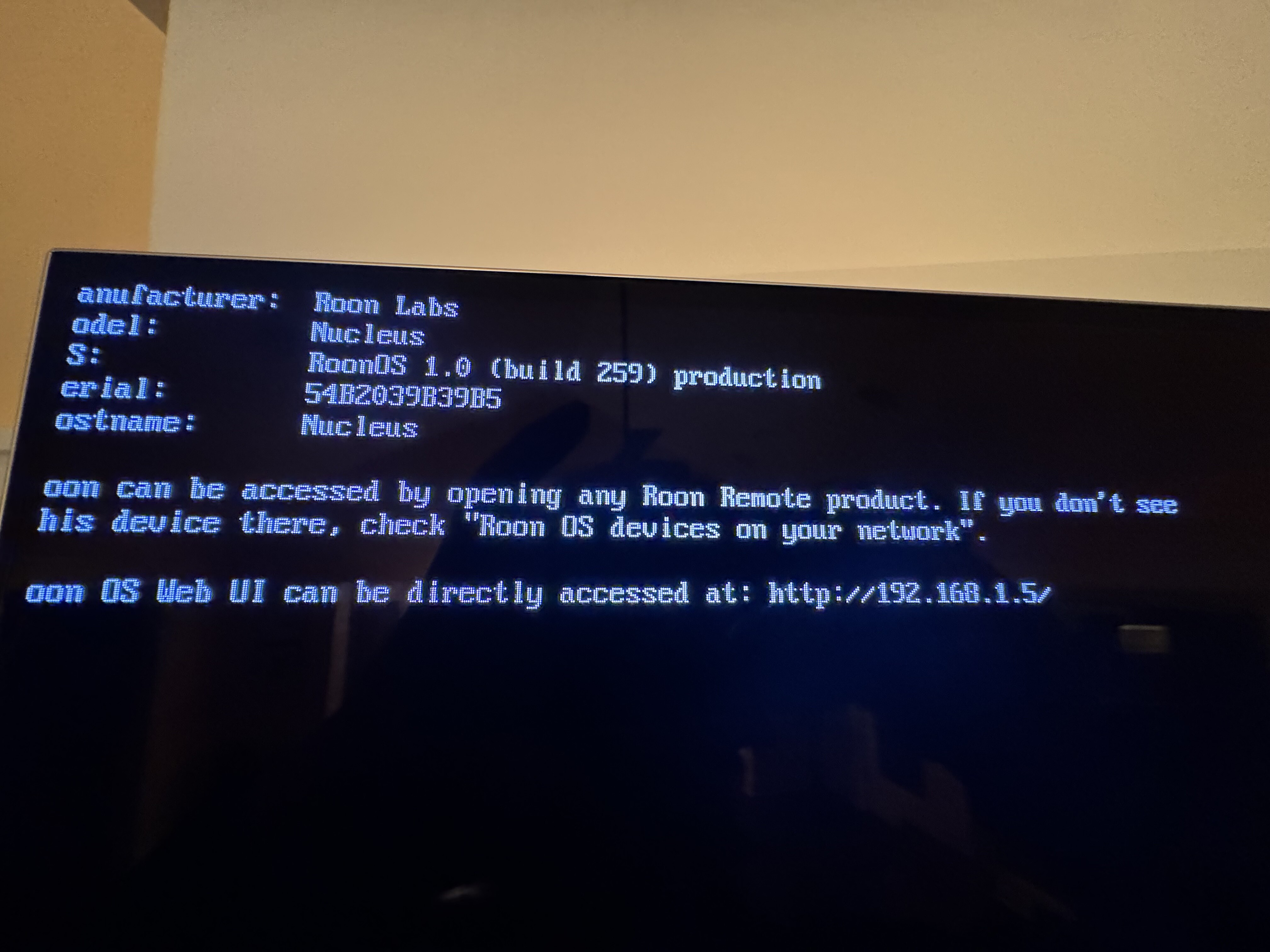

This afternoon I bought a sufficiently long HDMI cable to connect the Nucleus HDMI A port to my TV. Here is what appeared on the TV screen:

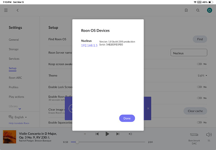

That is the same info I see in Roon Settings > Setup > Find Roon OS:

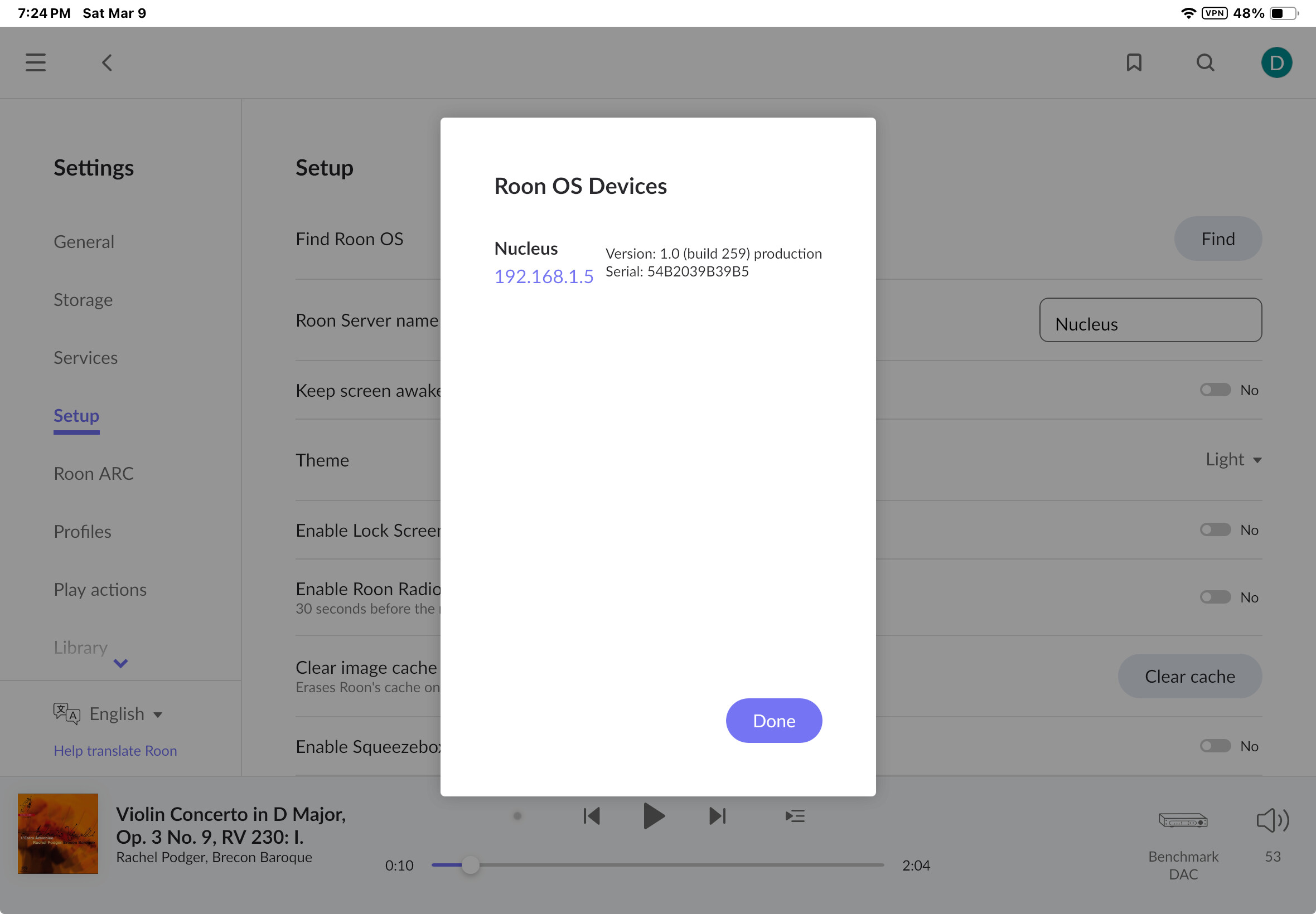

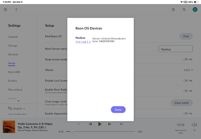

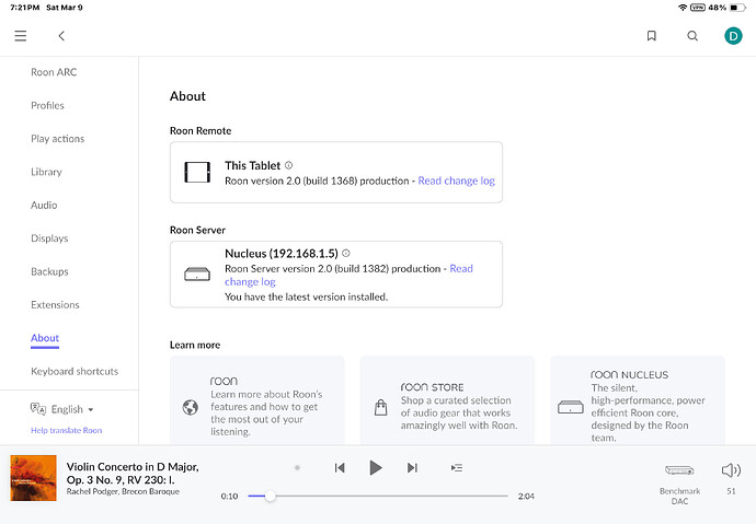

I then got an update notice, and downloaded the update. Now Settings > About shows:
However, Sertings > Setup > Find Roon OS still shows the Nucleus as Roon 1.0
Yes that is correct. Roon OS is not the same as Roon and there is no Roon OS 2.0 available.
