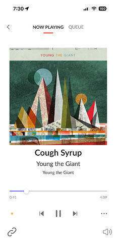

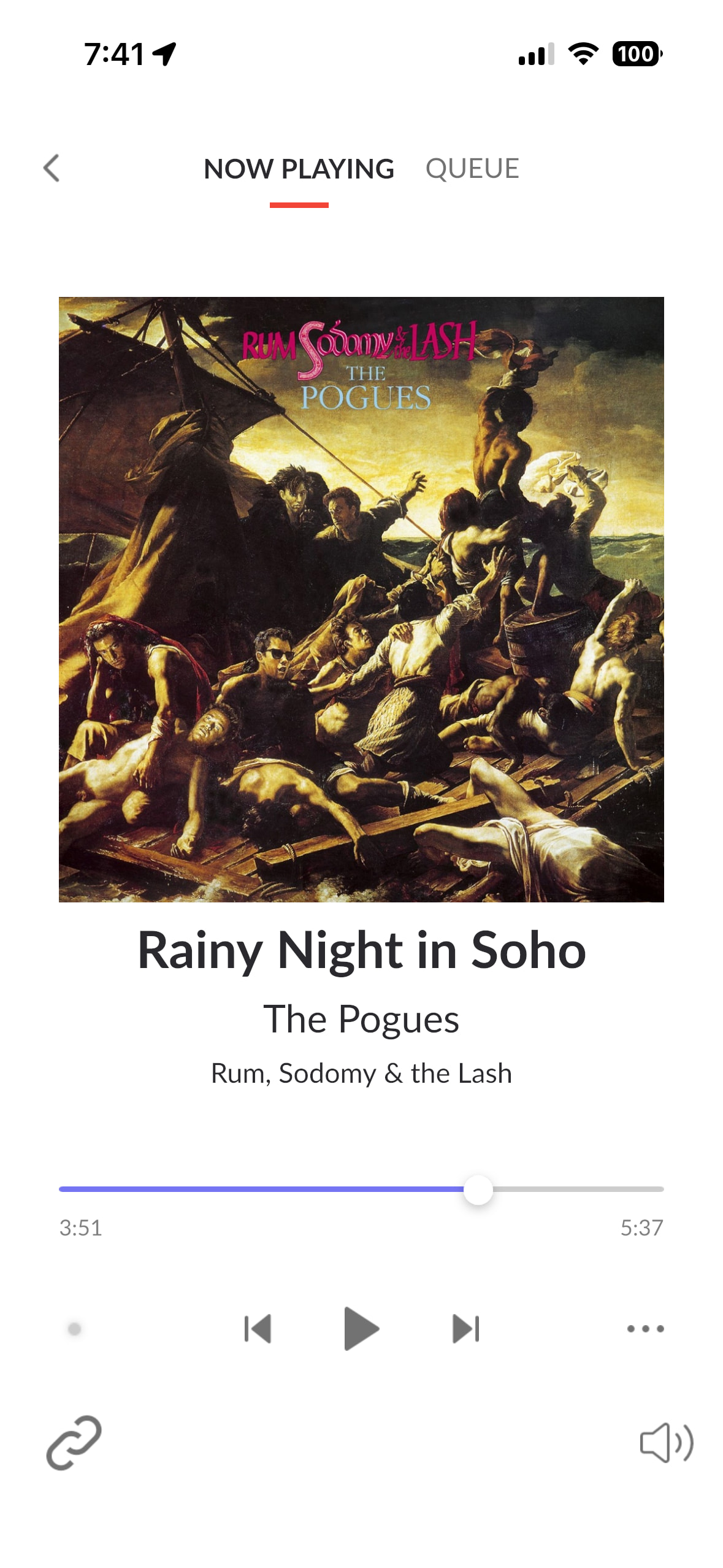

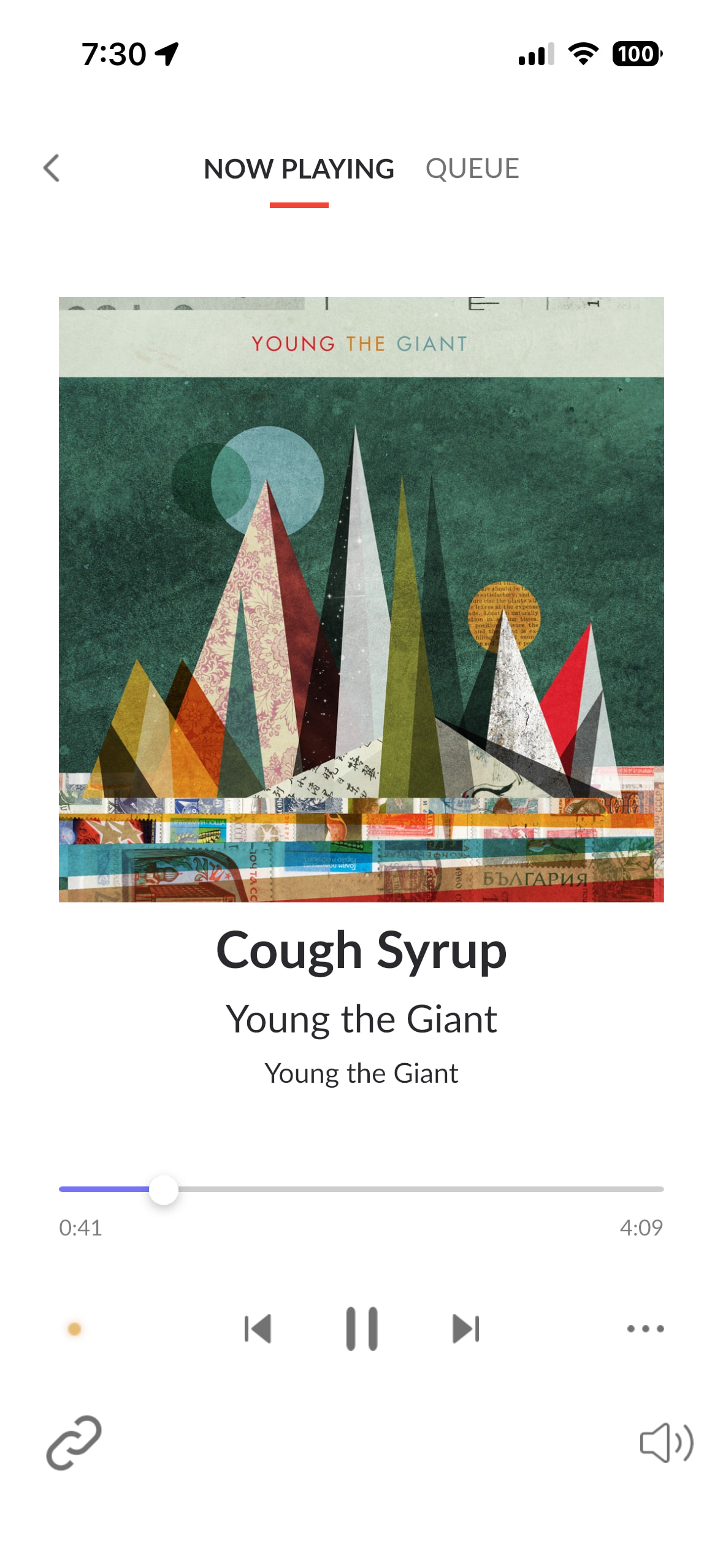

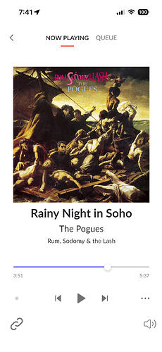

Hi Benjamin, thanks for your update. I ran the wiim pro+ all night as an isolate stream and it did not drop and was playing in the morning. I had 3 sources linked with AirPlay 2 and it dropped at these times and songs (see screen caps AM with time stamps).
I will try playing single sonus speakers and see if they drop as isolated channels.
