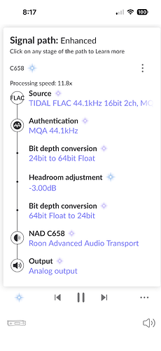

The signal path could not be displayed during the ping ponging but this is the signal path during normal play back. I also connected the Ethernet cable from the NAD to the router with no result. I am not sure Xfinity modems have this setting you are describing.
